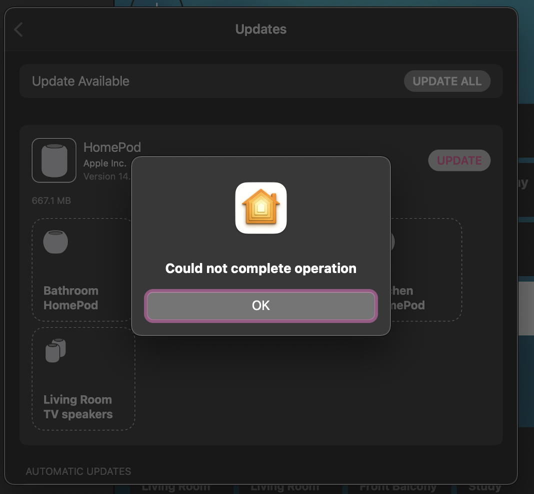

Between not being able to see what version Stereo pairs are on to the the Sound Check trick, what a glitchy ass update! Now I get the ability to update all, but I get the error "Could not complete operation" when I try to update all or individuals.

I guess the servers are getting hammered. Getting this error on desktop now as well:
Seems like I have to go through and download and install it individually for each HP rather than use the update screen :/
I was able to update each of my HomePods to 14.5 by restarting them via the Home app. After doing so, the update popped up and was installable. Without restarting all of them, however, I was getting the same "could not complete operation" pop-up error.

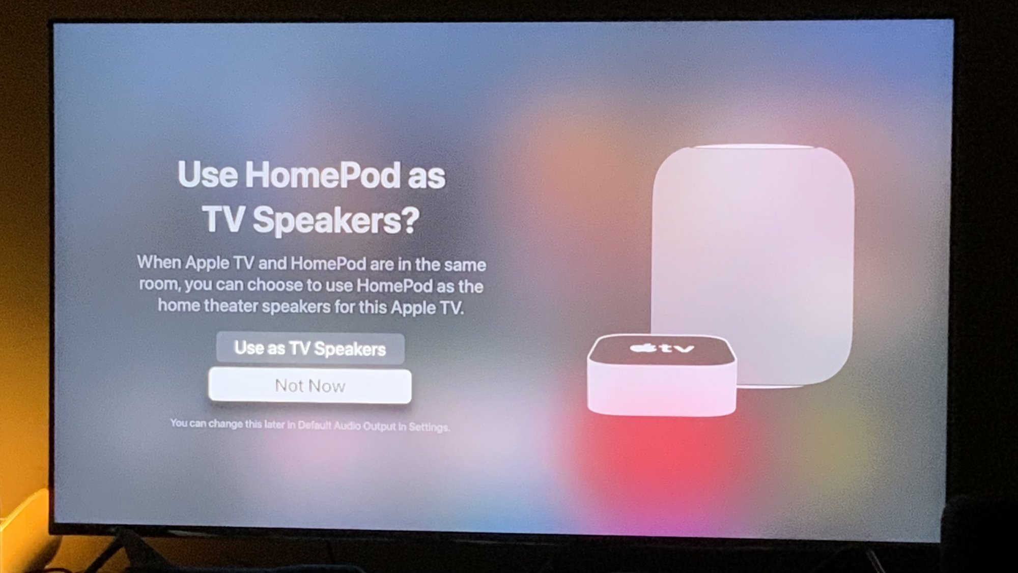

Still unable to use my Home Theatre HomePods for anything else once they are set as default speakers for the ATV. 😡

Ok, so to fix my issue (+/- lights on the top of the HomePod staying on), I had to turn off the Default Audio Output feature on my Apple TV. As soon as I switched this off, those +/- lights turn off; turn the feature back on, so do the +/- lights. Back to manually setting the audio output to my HomePods a la iOS 13…

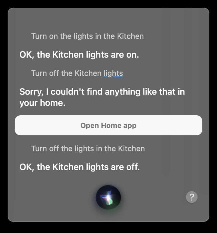

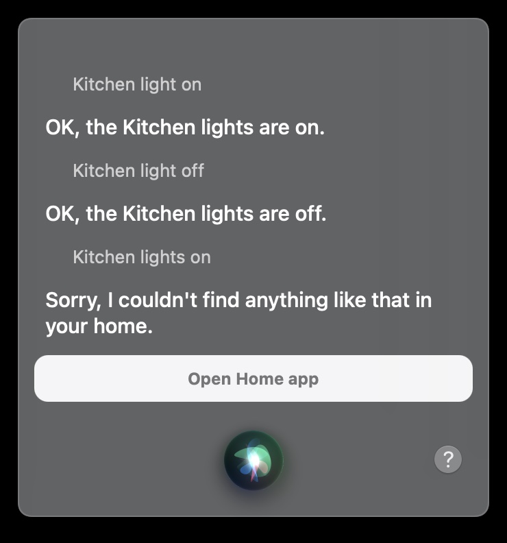

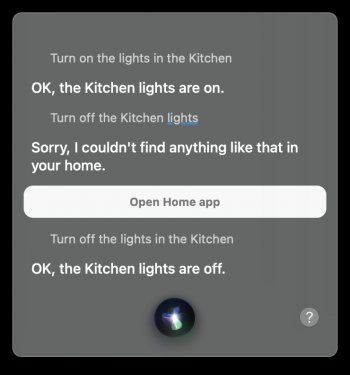

A brief update to my HomeKit Siri issues after the update. I'm finding it happens on any device that's been updated to 14.5, not just the HomePods. So it's something they did with this new version of Siri with the 4 different voice options. If I use incorrect grammar and say "Light", she turns on/off my kitchen lights, but if I use correct grammar and say "Lights" she now won't find them.
Here's precisely what it's doing using my iMac that was updated to macOS 11.3 which also has the updated Siri....
One more example of how maddening the newly updated Siri is. I have to be very specific in my phrasing of requests now on any device that was updated yesterday. 🙄
