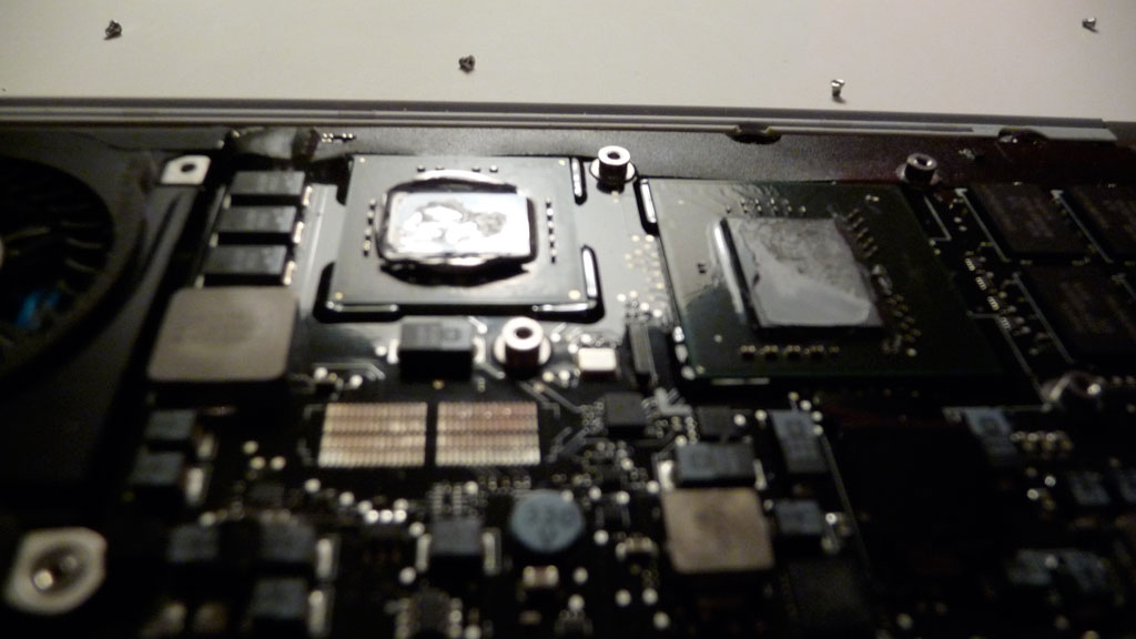

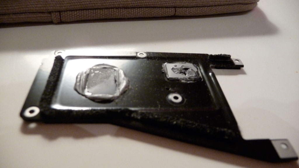

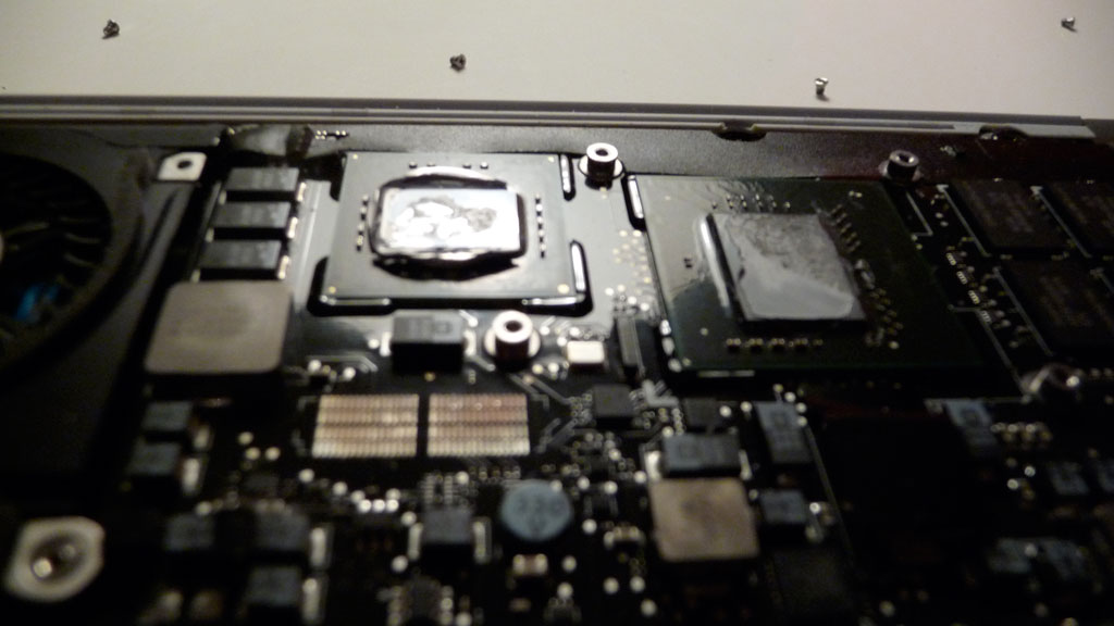

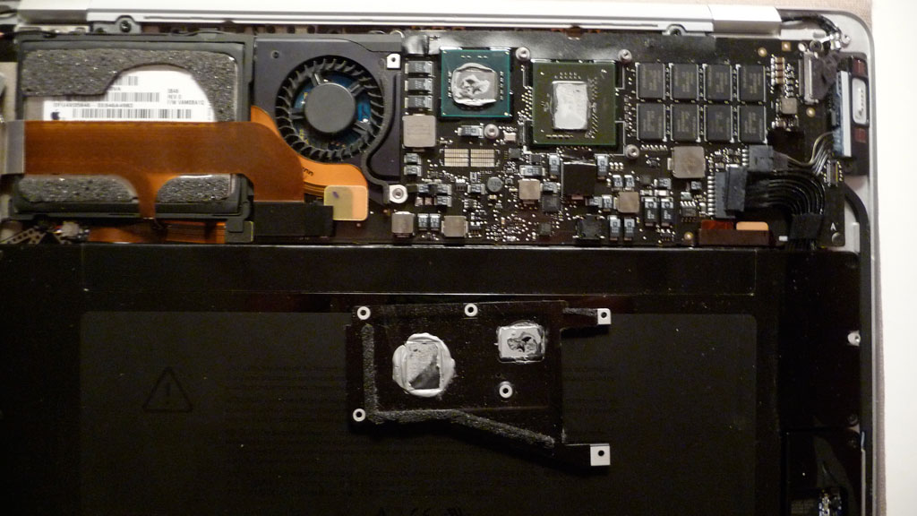

Ok, so I bought a rev B back in Nov 2008 and it had been acting weird since purchasing it.
Within 3 days I had it in for repair due to the heat issues and odd behavior and it came
back a few days later with a note saying all was well and there was no issues and its
temperatures were within spec.
Anyway, like a schmuck I lived with it until the dodgy keyboard broke and again asked
them to check the heat as the fans were constantly on and erratic behavior.
So last week I got the laptop back again and was told it was all fine and to apples
listed specs.

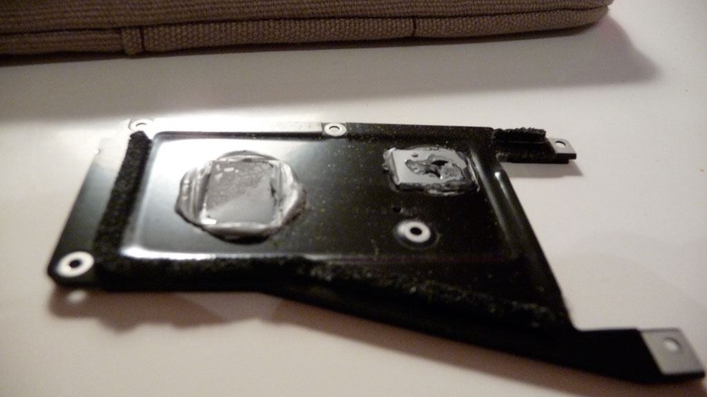

So tonight I finally got the balls to take it apart and reapply the thermal paste.
I was amazed to see just how much paste was on the chip ..... it was LOTS.
In-fact it was everywhere and spilling over the side. (I will try and upload pics soon).
HOWEVER, since carefully cleaning the paste off and reapplying new thermal paste
I must say it does work allot better (in a much different way)
I still get peak heat spikes at 80C+ in extreme cases, but it doesnt stay like that
for long periods of time, as it did when the old fat paste was on it.
But the most noticeable change is the lack of crazy full throttle fans on constantly.
And this means the battery should last a lot longer.
SO what I wanted to say is this, if you do have an issue with your rev B MBA.
And like myself couldn't get any luck with apple care, then have a think about
maybe changing the paste yourself as it has so far appears to have done wonders
for me.
pics ...

For reference (according to service manual), the specified amount used is 1cc. It's applied as a dab in the center of each device (letting the Thermal Module & Fan assy spread it during assembled).
With that procedure, it is normal for there to be paste around the perimeter of each device when you remove the Thermal Module.
Hard to say what went wrong when they initially applied the paste. It could be they didn't press down on the module over the CPU/GPU to make sure the paste had full contact and/or the "boomerang clamp" wasn't aligned properly (there's a hole in it that aligns with a hold in the Thermal Module). The clamp is supposed to align over the top of the CPU & GPU.

Omg thats a TON of thermal paste!!!!!
Glad to hear its working good now 🙂
Yea, it's more than I would have used, too. But, that's what in the service guide. The rule I was taught was to use enough to fill both surfaces completely, but with a minimal thickness and minimal "oozing". Thinking about it, how the paste is spread by the heat sink would greatly affect the starting amount - my heat-sink paste experience goes back a loooooong way 😉. I suspect it has to do with the contact area in the MBA's fan/thermal module and how it's mechanically held down (the "boomerang" clip apparently puts spring tension directly on top of the devices).
Of course, all surfaces need to be cleaned of old paste (including alcohol to remove the last traces). And, don't touch the new paste or surfaces to avoid contamination.

UPDATE ::::
Well I have finally started to use this now as it seems to be working as it should.
I am really glad I took the step to clean off the paste and reapply it.
So far the laptop is really working ALLOT better (at least 30% better)
And I have also run all the updates etc.

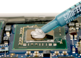

Since I'm not doing the repair, and this is for infomation only, I think I'm cool quoting the manual (mod let me know if this is a no-no; again, I'm not doing any warranty work, though that would be the end user's responsibility anyway, as far their own work on a covered machine):

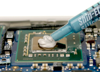

From the Apple Service Manual (copyright 2008, Apple Inc):
5. Put a 1cc dab (roughly one quarter of a full syringe) of thermal paste in the center of each chip mating surface, as shown.

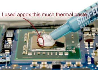

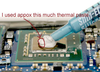

When I re-pasted mine, I used approx 1 cooked grain of rice for the CPU and then smoothed it out with a credit card (obviously very carefully). and a similar amount for the GPU and smoothed it out again with a credit card.
Interesting. I suppose if it's working, then you're in good shape. As for the amount - I doubt Apple would expend material if it weren't needed, so there was probably something else wrong with the original installation.
