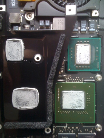

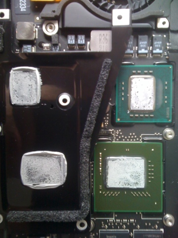

Just for the record, here's the rev C's pasting. (Which I did remove). Those excess amount can push the metal plate up to heat things up...
The amount used in the manual is LUDICROUS. This isnt a desktop chip with a IHS. This is a bare die. The die itself is already very flat and smooth. It does not take much thermal paste to fill crevices. For die the best way to apply it is to use a credit card to smear a thin layer. I guess Apple chose the easiest way and just told the employees to drop a glob...
