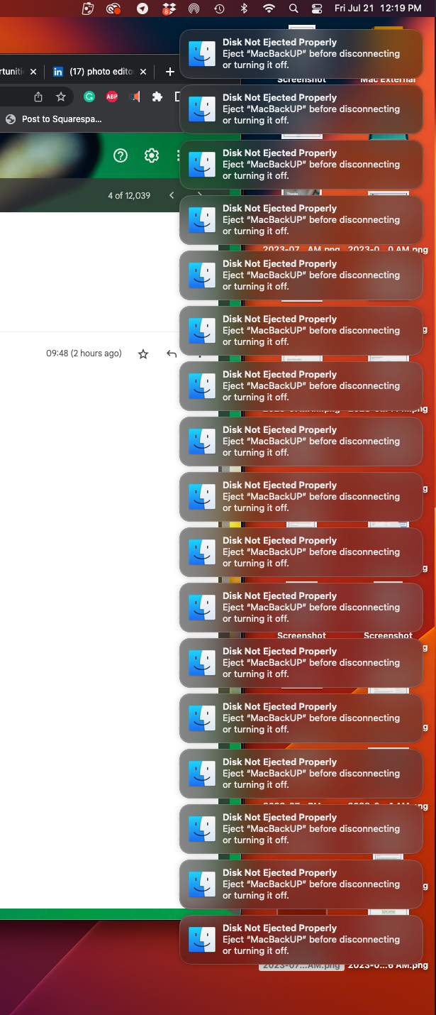

I've also used Mac for 15 years and never had this error when going to sleep. Any thoughts or ideas? I'm running mac studio M1 Max.
I get this all the time. M1 Max MacBook Pro on the latest OS 13. But only with SSD's Spinning drives seem to stay mounted whatever. Will try the 'Hard disks to sleep' toggle and see if that helps.
