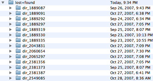

I have a bunch of files... I must have had a HD burp or something. I have a bunch of files under "lost+found". I try deleting it but I can't!
The folder has a bunch of other folders ("dir...") but I can't delete them! They are NOT in use as far as I can tell.
HELP!

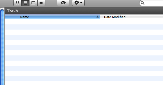

I've rebooted but it doesn't help. It thinks the files are in use (and they obviously aren't). I still can't delete the folder. 😡
