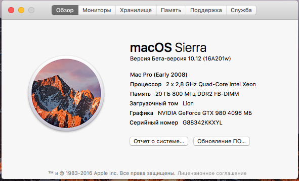

Installed to mp3,1
[doublepost=1465863069][/doublepost]Actually Nvidia driver got updated to
10.12.39.1 355.10.05b02, but still no maxwell support, it got stripped.
Hello, it's being so for past 9 years
For 4,1, you have three chooses:
1) follow path of 3,1 macpro
2) copy installed image from another mac
3) upgrade firmware to 5,1 and enjoy
3,1 has only 1) and 2)
everything works, continue the party.
