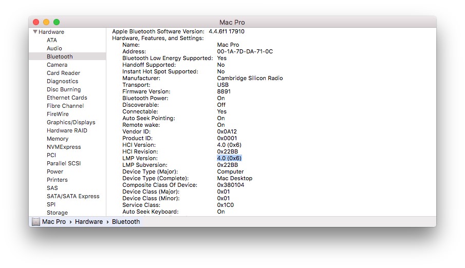

I use that BT 4.0 Dongle simply for better mouse connection. My magic mouse work flawlessly with that dongle, never disconnect. I don't even have Wi-Fi on my 4,1. So, sure that's not a requirement, and can't test any Wi-Fi stuff.
which BT 4.0 Dongle are you using? any drivers required for OS X?
It's brand is eBlue. Just a $5 USB Dongle in a local computer store. I bought it without think twice.
There is an Mac logo on the box to state that's Mac compatible.
It works fine since I bought it (with Yosemite), I use BT explorer to switch to this USB BT dongle. No driver require, work straight away (no need to reboot). Once I done that, the system just keep using it even I install a new OSX on a clean partition. So, obviously the information is stored at somewhere else, but not inside the OS.
I'd try to find the exact BT Dongle on the internet, but can't find it. Not even on the eBlue webpage. So, it may coming from an unknown China manufacture with just the eBlue name on it.
Anyway, this is the BT system info. Which shows BT 4.0 as the box state.

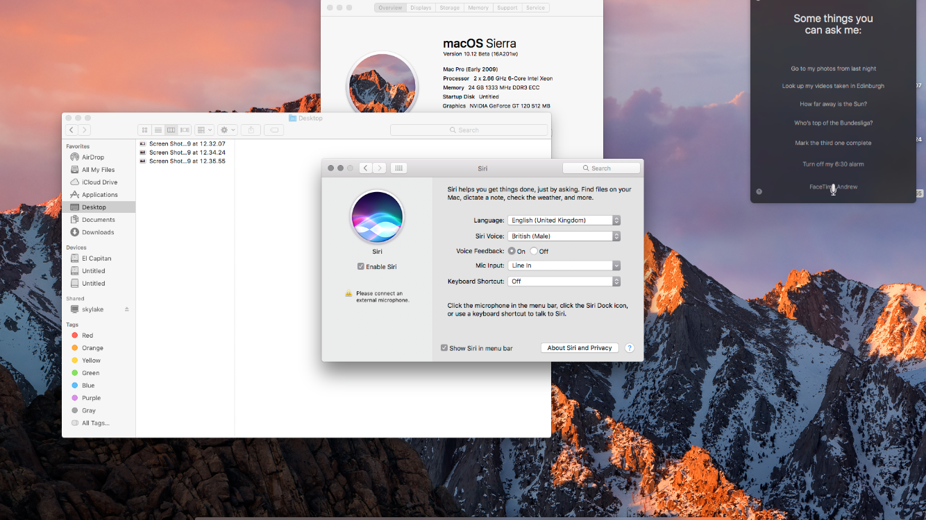

Sierra installed on upgraded 4,1.
No apps installed yet. Just fiddled around with the OS. Didn't even connect my Apple account yet. All the drivers are working. Font rendering is always a bit crap in the early betas.
It's looking good though.
