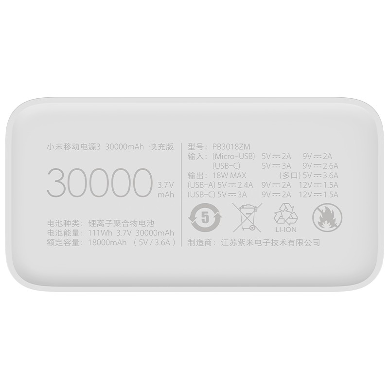

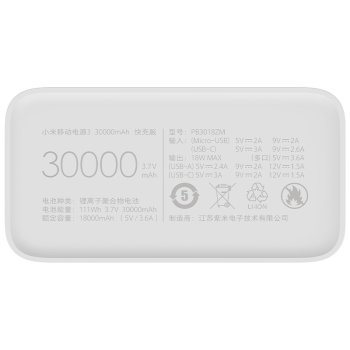

You simply multiply the voltage of the cell by the mAh.
My Xiaomi 30,000mAh bank for instance is 3.7V, which is 111Wh. The problem is, most other companies are not so forthcoming with the specs because they use low quality cells with lower voltage.
