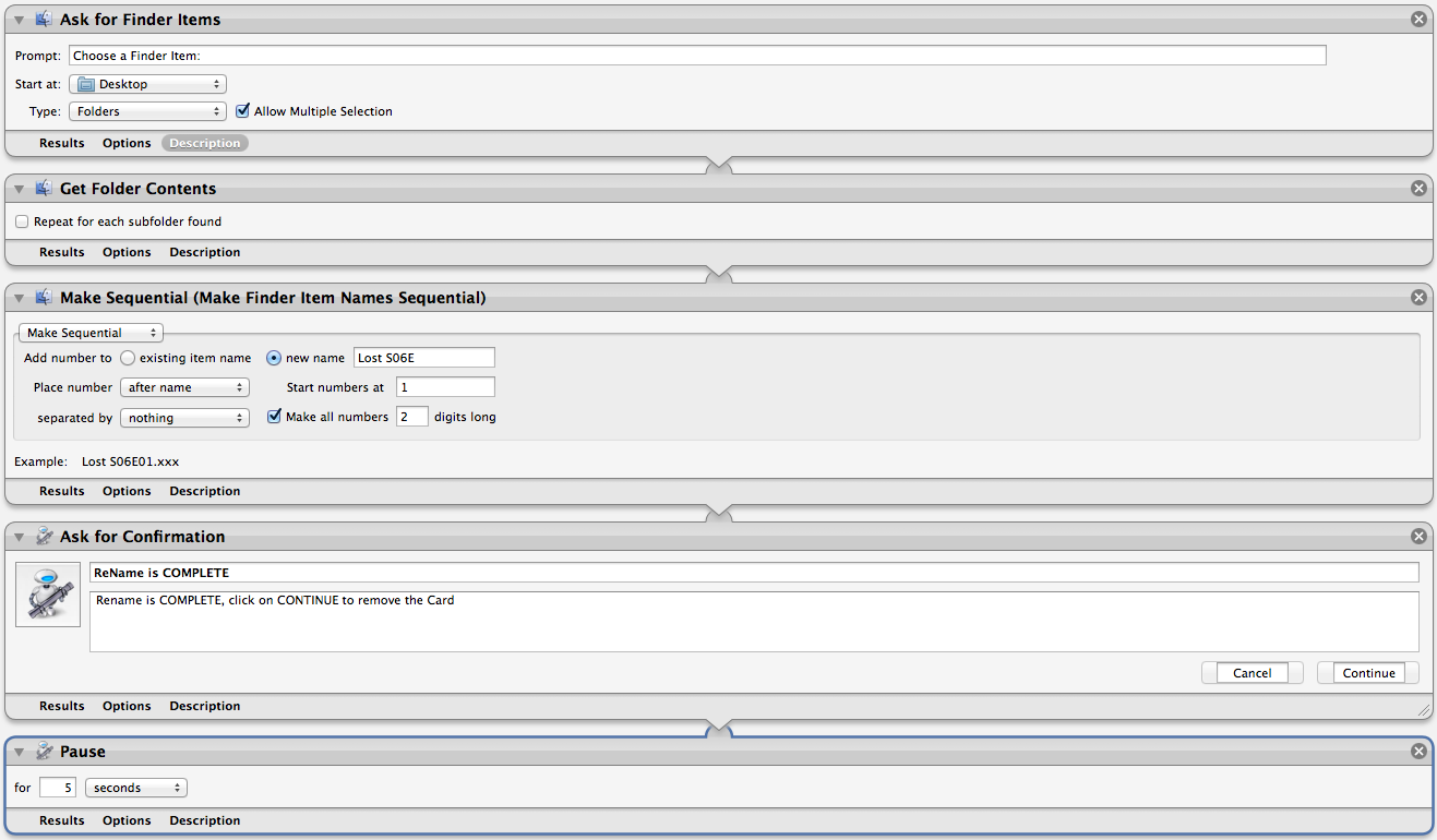

I use this script to rename my Lost episodes.
Hope this help
MS
Thank You. So manual on the Season, then it changes the episodes, but must have all of them, and start at 1?
Correct?
Your episodes must be already in order. This scrip allows you to rename your files sequentially only, it does not order them.
Since this allow your to select the files to rename, try with a couple of them before a full run.
You build and lunch the script. Make sure that you change the "new name" to a more appropriate file name (i.e Show - S01E) my was for Lost.
Navigate to the location of your files, select all all of them.
MS
