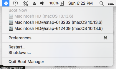

You can try https://github.com/abdyfranco/boot-manager 🙂
It's an open source alternative to the built-in Startup Disk selector, BootRunner and BootChamp, Based on QuickBoot, and it doesn't require you to disable SIP like other alternatives.
