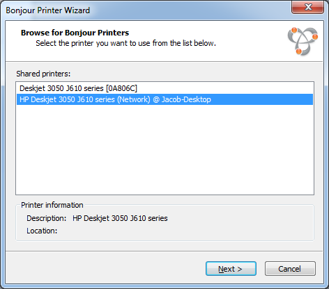

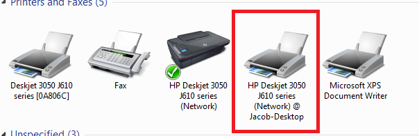

My printer suddenly disappeared. I got it re-enabled by going into Bonjour Printer Wizard and re-sharing the shared printer. Now my printer shows again on my ipad.
