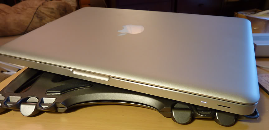

does the lid sit flush now?
Eddie... yes. Very little material was removed. In fact the bottom of the top lid IS mitered! So when the machine is closed, the top of the bottom matches the bottom of the top, if you know what I mean. Looks wonderful open and closed! 😀
Could you take pictures of having it closed please?
Sure, buddy, here ya go.... but beware, this thing looks so bad now I can't see how ANYbody would ever want it! 😉 I don't know how I'll ever recover from this devastating loss! 😱 😉
