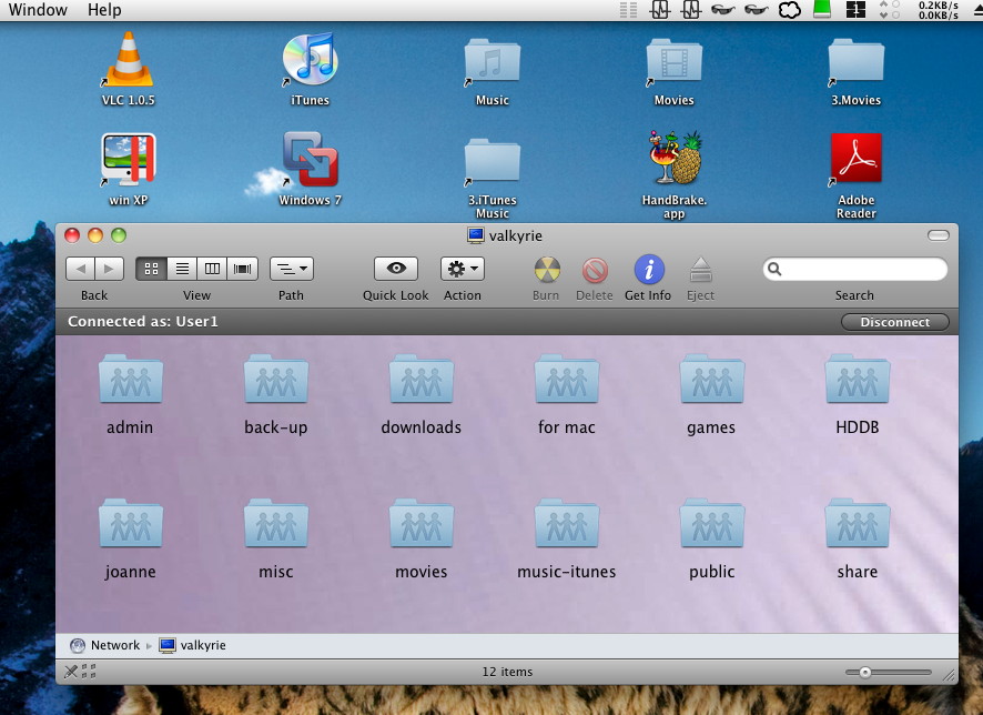

Hi soamz,
I think your best bet would be to use a NAS (Network Attached Storage) set-up for your purpose.
I have this set-up my home network (2 Macs and 3 PCs) with Patriot Valkyrie NAS which takes 2 HDs (cost Patriot $150, 2x2TB Western Digital HDs=$120 each [in Canada]).
Then install Paragon NTFS for Mac OS X appl. so you can manipulate PC partitions & you're set.
Here is a shot of my NAS on the Mac:

Hi soamz,
I think the same. I also got myself a NAS for my home network (5 computers, mixed linux, osx and windows) for 40€, built in a harddisk of your preferred size and you're done. If you buy you're harddisks at the right place, it won't be even a lot more expensive than your avarage external harddisk.
