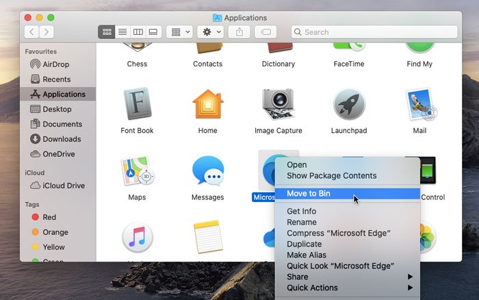

Being new to mac, after 26 years on windows, i want to understand how the uninstall process works when uninstalling a 3rd party program. with windows there is always a "uninstall" for the program, but with most programs on mac you just go to Finder/Applications, find the program in the list, right click and send it to the trash. i understand that if there is a folder related to that program that you can then open the folder and there should be a uninstall program inside. but how is it that if there is not a folder and you just send it to the trash that mac is able to totally delete all of the files related to that program, and do it so quickly? Or, are there remnants of the program still on the drive, and if so, how do you go about getting rid of the left over garbage? i ask this because i had been reading some of the posts here about Edge being slightly better than Safari, and decided to try Edge. i don't like the UI of Edge, and so removed it via Finder/Applications, and that got me to wondering if all of the files were removed for Edge?

macOS is rubbish when it comes to uninstalling programs. There is no equivalent to Windows uninstall or the registry. Apps are free to splatter files wherever they like, though there are some conventions. Deleting an app from /Applications will not remove any of the files created by the app.
To properly uninstall an app you need too search for all the files it has created - mostly they are in ~/Library, but not always.
To uninstall I use Remove-It (used to be called iTrash). There are other similar better/worse utilities. They all attempt to search for the extra files you might want to delete.
For your Edge, you need to re-install and then use Remove-It (or whatever you prefer) to properly delete Edge and the extra files it has added.
Not always available but probably a first try: go to the site of the Application and look for its un-installer. I think this is always a good first step though lots of applications won't have one. Create an 'Un-installer' folder for future installs so if an app has one or instructions there-of you'll have all in a single and readily accessible spot.
back to the question of how to get rid of left over files that might not have been removed when uninstalling/moving to trash a 3rd party program. being new to mac, i would like a basic step by step of where to go (terminal?) to look for these files, and how to delete them. this is totally different than my 26 year experience with the windows registry.
thanxz in advance~

Step by step, the same basic process goes for most applications. Not all applications create all these folders, but you can always look or search. For instance, you could search "Edge" and find all these too.
much thanxz, that's what i was looking for!
