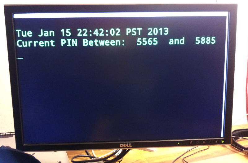

I wrote a simple script (runs on linux... it should run on mac too) that estimates what code range is being tested.
When I mean range it is because I added all milliseconds for the first value and took that same value plus 1 second for the second value... so in case that the actual process takes longer than the "waits".
Here is a photo of the script running:
I again... i do not own a mac so I cant test it but the script source code is available in my blog for free.
@kliffte: You could try modifying the Teensy sketch (program) just to run that range; here are the changes you should make from:

As you can see we are starting the counter at 899 and ending the counter in 1901... TBH I would go one step further and divide that range in 3 batches, so that you can be sure in what range that PIN is, so that the first batch will look like this:
