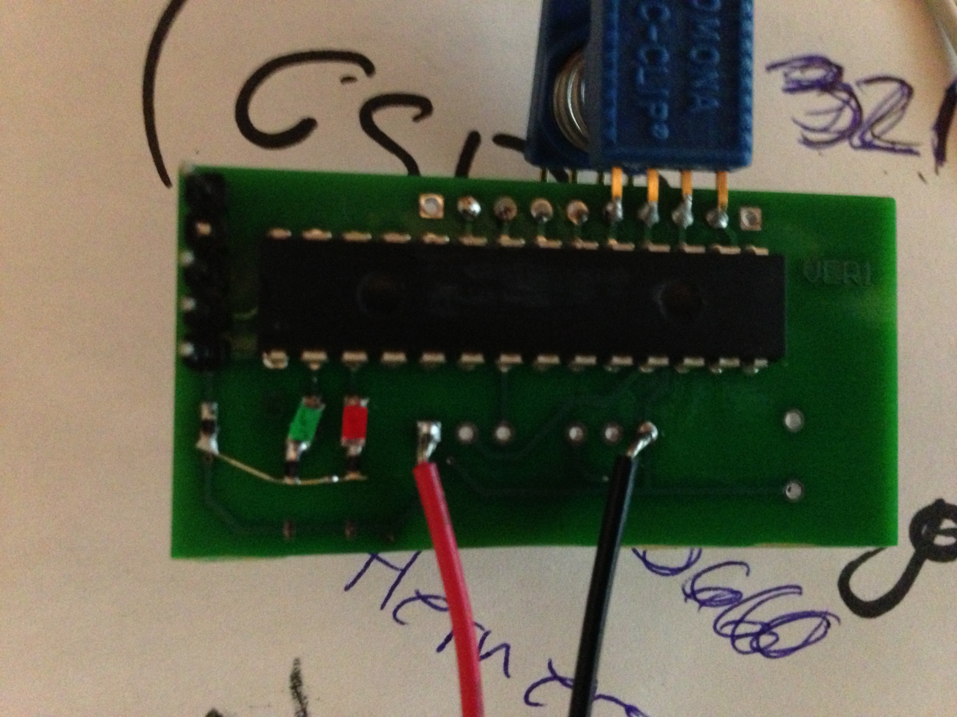

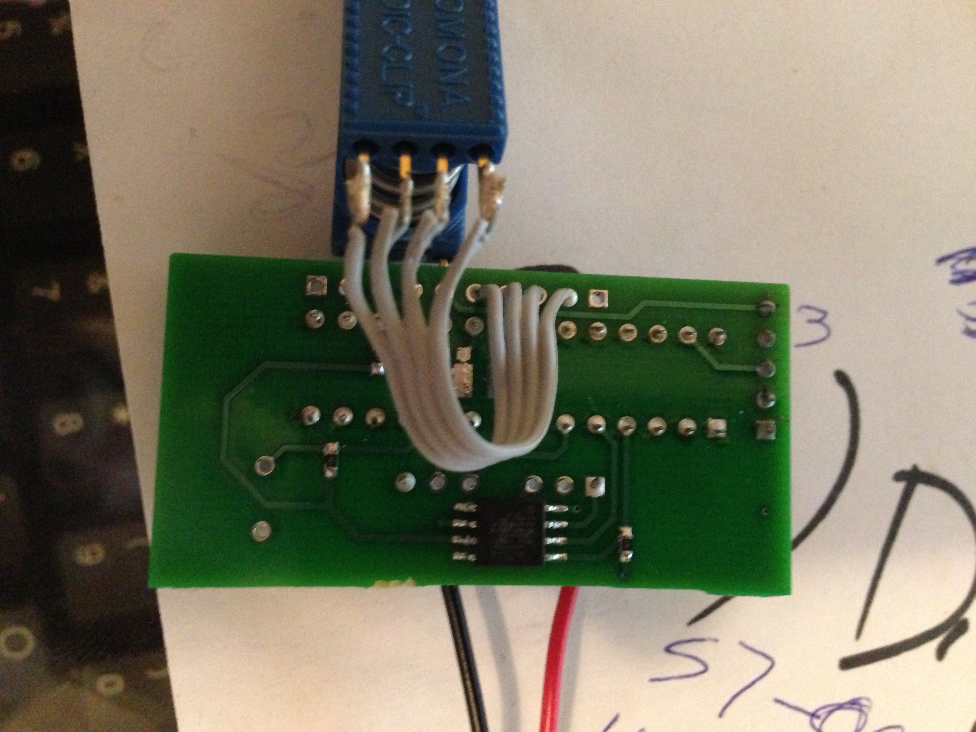

here is the device
it is battery operated
they are currently selling the device for $50
$250 for 5 unlocks then the price drops to $400 for 10 unlocks
They seem to have built a counter in to device to know how many credits you have left im going to try to dump what ever I can out of it its seems to me it has all model firmwares stored on the device
I personally dont own the device but will order one to reverse engineer it
I will post updates as soon as I get the unit
Attached are pictures and the instruction manual that comes with the unit

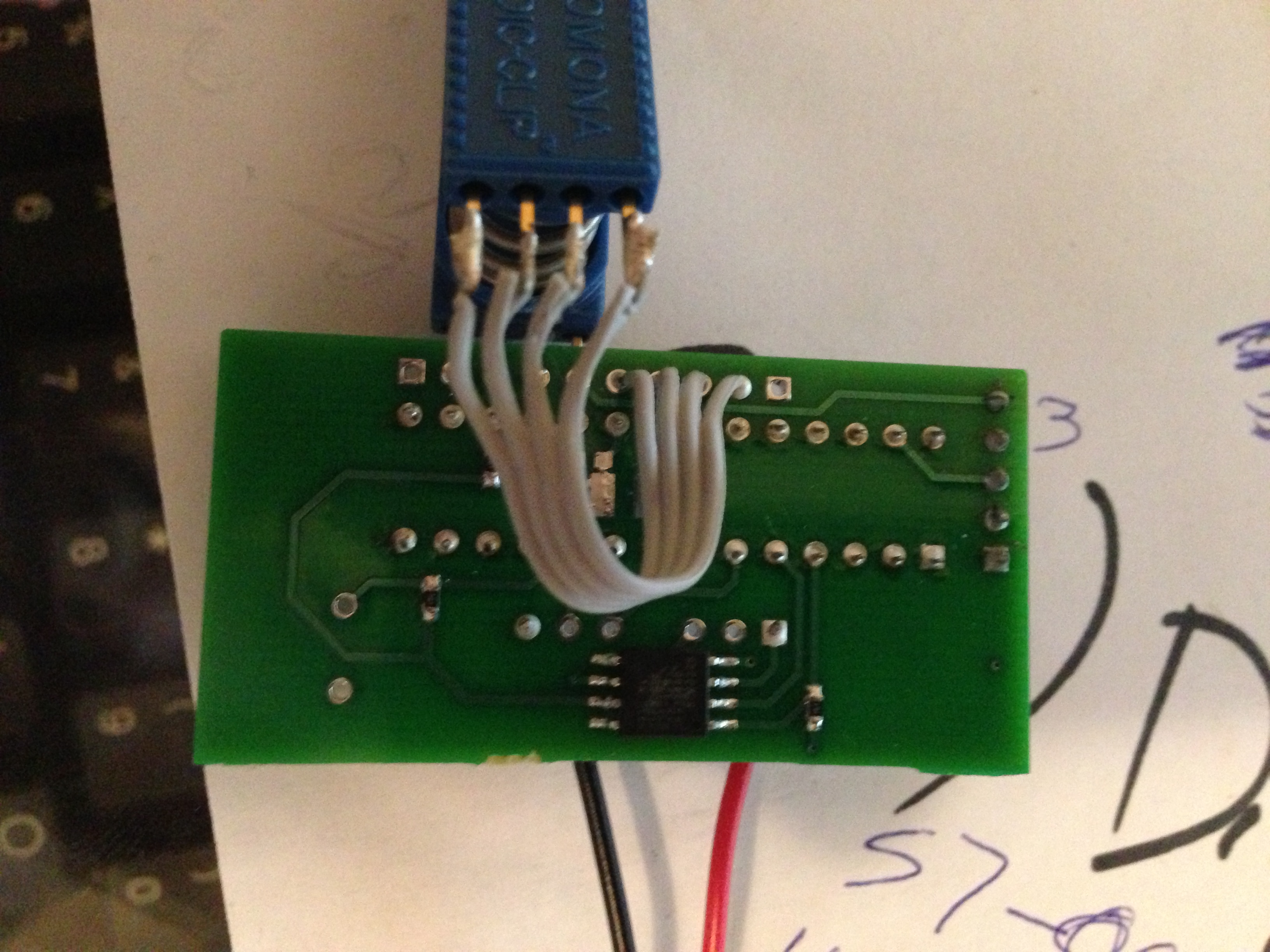

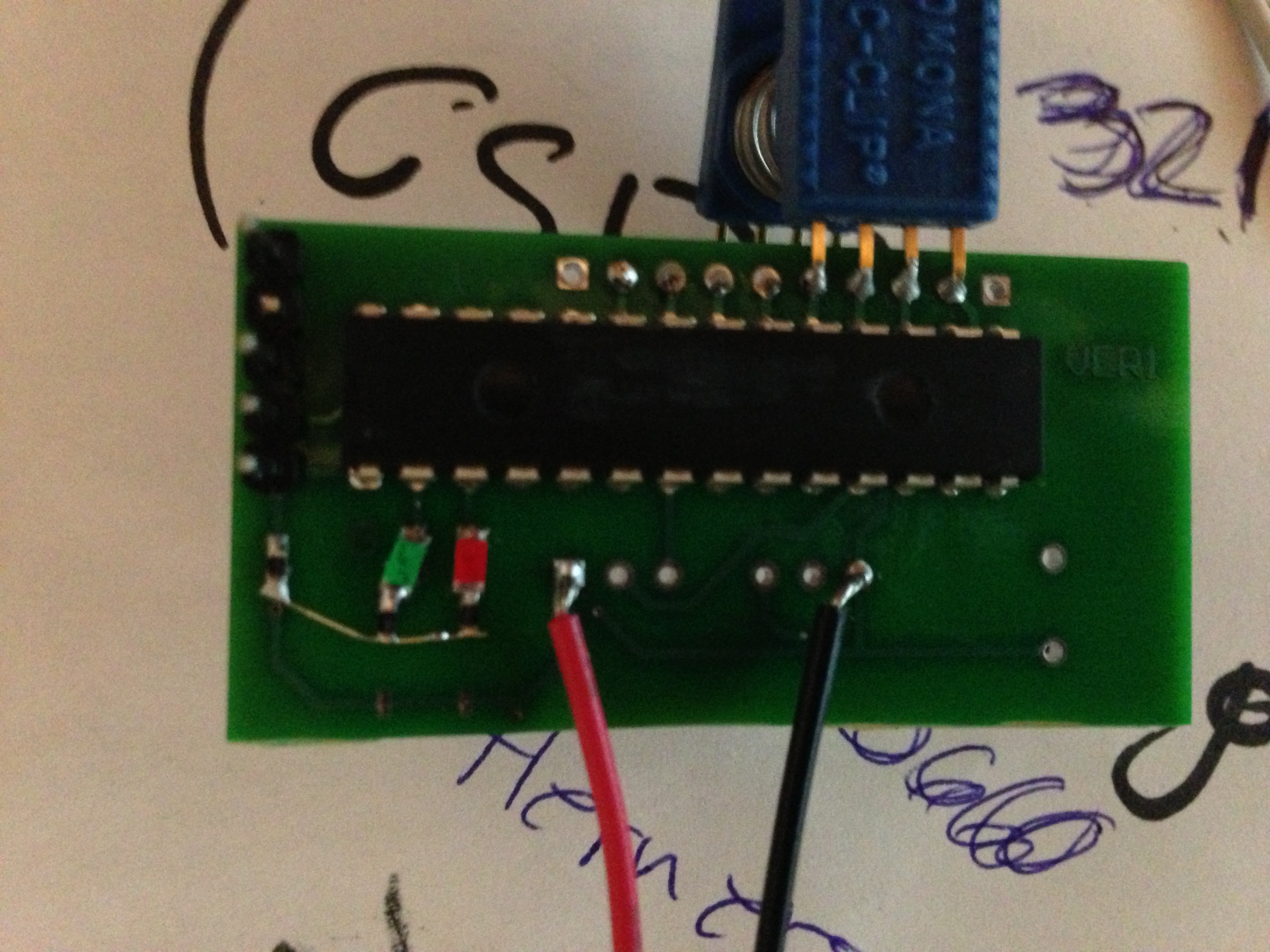

here is the device
Hi Torontomac,
Can you provide the link or the place where you did see or to get this device ?
