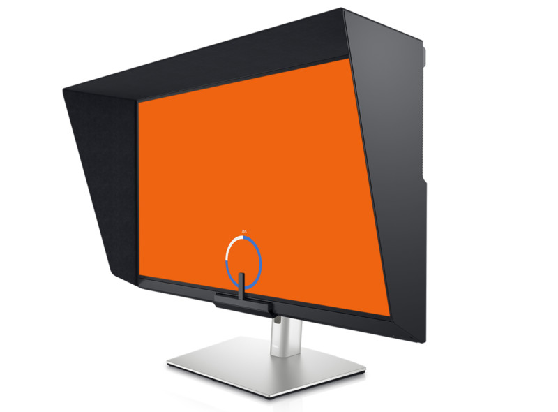

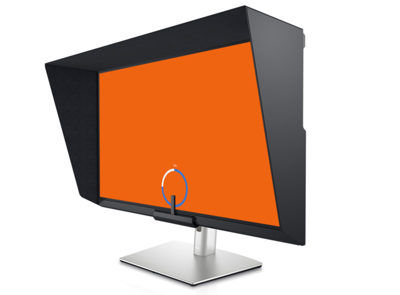

We need TVs with built-in colorimeters like this Dell monitor:
