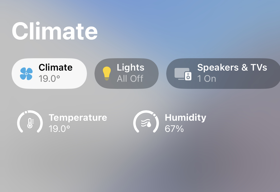

What’s annoying now I can’t just see my main tado thermostat reading I have to click into the climate but as all HomePods show different reading

It’s so bad I have 2 stereo HomePods mini in the living room on a table and one says 18.5c and other one is 19.5c but my main tado started says 20c
Temp readings in a room can vary considerably. Especially around furniture, vents, appliances, windows, doors, etc.
Try putting them together. Literally touching. Then leave them for an hour or two to stabilize and see if they match up.

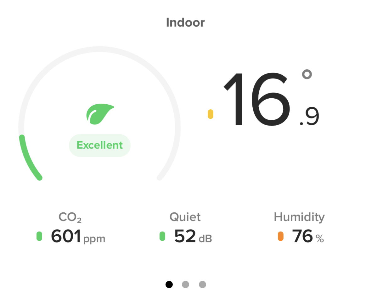

Ye this is totally unusable. It’s not even a little wrong it’s WAY off! I trust my Netatmo way more unfortunately. Been using them for 8/9 years! Dam, I really wish apple got this right. But it’s a big dud!
