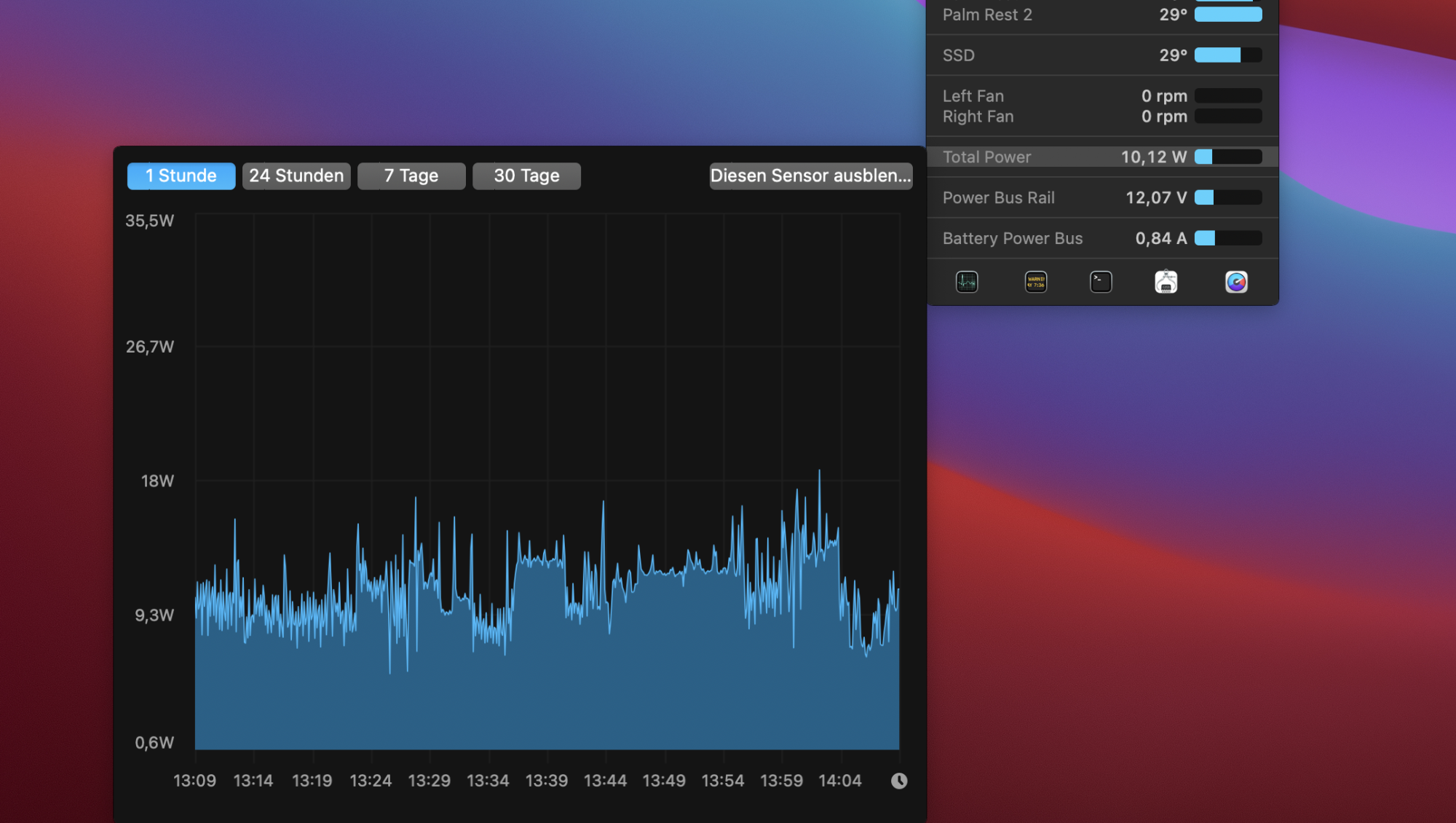

I am noticing drastically reduced efficiency on my Macbook Pro M1 16".
Usually when watching Videos on YouTube in Safari I was using under 8 Watts. Now it is fluctuating between 10 Watts up to 14 Watts and more.
Also in idle mode it consumes more energy than before with Monterey. I was using about 4,5 to 5 Watts before in idle and am now at about 8 Watts.

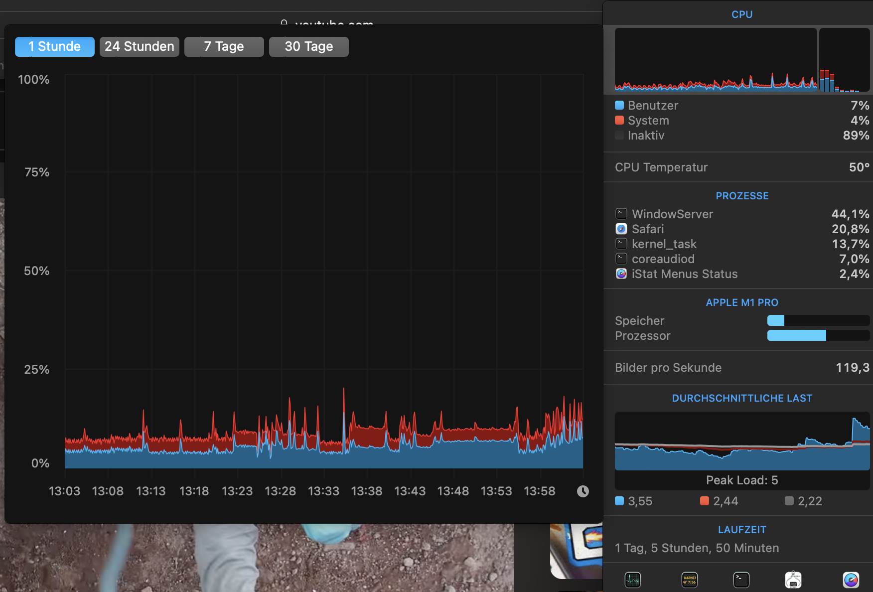

I added two screenshots. In these screenshots I am only watching YouTube in Safari. The laptop is not connected to power. Maybe others have the same problem.

I think I may have found a clue for the higher energy consumption of Ventura in comparison to Monterey. I was analyzing what new feature in Ventura I am now using constantly after having upgraded. The new feature that I am using is Stage Manager! So this is the difference to my previously perfectly running Monterey system!
I then turned off Stage Manager and now my energy consumption in idle dropped to 4-4,5 Watts with the display at about 30% brightness, great!
The energy consumption while playing YouTube in Safari also dropped significantly. I suspect that the WindowServer process consumes more energy when Stage Manager is active. I am also astonished why the WindowServer consumes 2,36 GB on my system with only Safari open and one YouTube and one MacRumors tab!
I will leave Stage Manager disabled and continue testing.

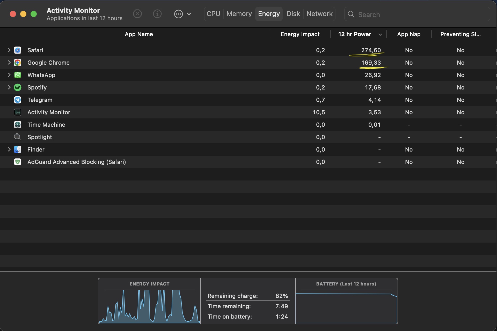

to everyone that has the same issue, please screenshot your 12 hr power

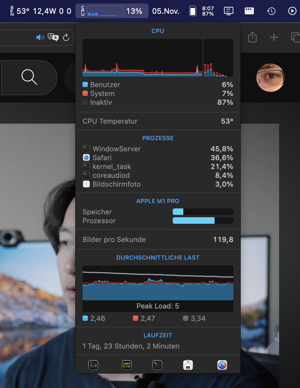

I am still not satisfied with the battery performance with Stage manager off. It made things a bit better but there is another problem that I found today while playing around.
For some reason today with only Safari open playing one video my battery consumption was about 12 watts which is much too high.
After staring some time on the information page of iStat Menus I noticed the following:
If you watch the area named "Bilder pro Sekunde" which is german for frames per second, you will notice that my display is updating with about 119,9/120 frames per second. Per default my M1 Macbook Pro which uses the Pro-Motion technology uses a variable framerate from I think 1 fps up to 120fps.
The video that I am playing is 24 fps and I am not moving the mouse at all. So Ventura has no reason to update the display 120 times a second all the time without dropping the fps, which it obviously does in my case very unnecessarily. This probably causes the 12 watts consumption.
So I turned off ProMotion in the display settings and set it to 60fps.
After that the battery consumption with only Safari open, playing one video with 24 fps went down to about 6 watts again.
So to me this seems like a bug in Ventura. I will keep investigating that.

how about "12 hr power" on activity monitor?
