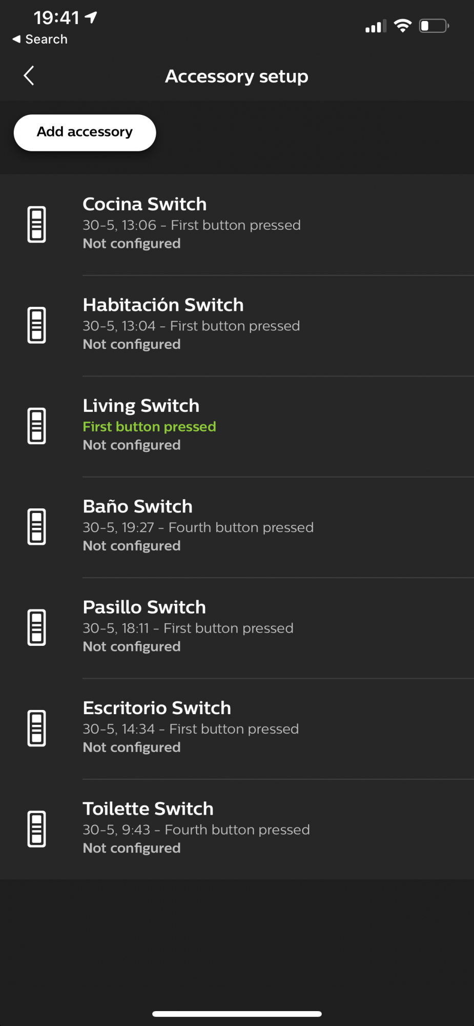

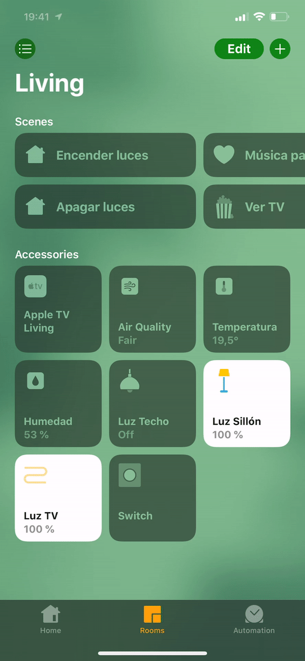

As @AJClayton and @bjornand mentioned above, every time you push the switch buttons you'll see the the visual confirmation on the Hue app ("X button pressed") + the animation (bounce) on the Home app + the green dot physically on the switch, but nothing happens.
However, if I try to turn the lights on through my Apple Watch, iPhone, or MacBook, everything goes fine and the lights are turned on. Even if I ask Siri to turn the lights on I got the expected response.

During the failure, I've setup one of the dimmers on the Hue app (while keeping the configuration on the Home app) and every push triggers the expected action. For example, on the Home app the first button turns on all the lights on the living room and sets the color to white. The same button on the Hue app sets the lights to red. When I press the button, the lights come on red. That's it. Now if I restart the Apple TV, the same button will first turn on the lights in red and then in white.
This tells me that the dimmers send the push to the Hue bridge (who doesn't know what to do because remember the configuration here is empty) and the Home hub (Apple TV) receives the push from the Hue bridge but without telling the bridge what to do. Again, this also explains why some automations (like the ones associated with the motion sensors) are not getting triggered. The Home app shows motion detected, but no lights are turned on. After restarting the Apple TV, the automations start working again.
