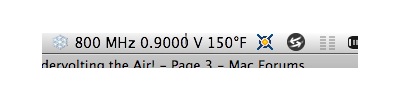

Question, Why do I see that it is only at 800mhz when I am running a CPU stress test?
I have a 1.8GHZ Air?
Also, I have it on .9000 for everything except .9125 for 1.8.
I am running a stress test on the cpu right now and I havnt seen it throttle up to 1.8

When I slide the update to max the information screen never reflects anything more then 800MHZ. Also on the menu bar never changes above 800MHZ, I dont even have a 800mhz setting on battery or adapter.
Is this thing even working?
