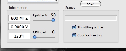

I have a 1.8GHZ air, and I dont see anything happening when I run this program. Its a registered version. I have updates to MAX and it is constantly at 800MHZ. The only thing that seems to change is the temp.
Any one have any ideas?
I have everything set to .9 except 1.8 which I bumped up slightly
Any help??
You have the throttling checkbox checked?

Ok, although I've not Coolbook yet I do not understand where 800mhz is comming from... Are you talking about the FSB? Or what?

See the attached picture, that 800MHZ never changes!!!
Same voltage settings as in OSX. I'd go performance on demand.

dyerucf: change the CPU load to max, not updates. Also, if you only have 800MHz listed above in the box, then you only get 800mhz.
