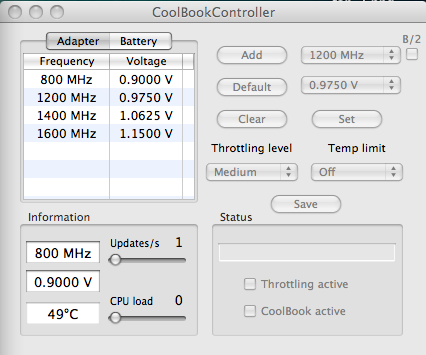

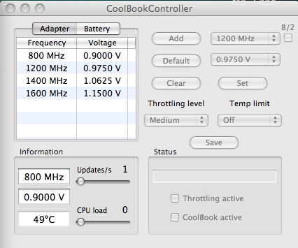

i just d/l coolbook but haven't activated it yet. i used it to monitor my Air and here's the settings of the machine
if 0.9 V is the lowest and most of the time my machine runs at 800 MHz, coolbook won't do me much good would it?
Theoretically at the 800MGZ is the only preset that has the same voltage... but I'll tell you.... set your processor to run at 1.6 and at the preset voltage of 1.15... and put the cpu bar to 10 and let it run for about 15 minutes... you'll see your temp reach 90 to 100 in that time.... after, that set it to 1.6 at 0.9125(the lowest I can get my cpu without kernel panic) and run the same test... You won't see it jump over 80-85.... so yes it makes a difference...
on the low end, you won't notice much, but start running VMware or encode a file or start watching High def movie trailers, and you will notice a huge difference...
I agree
Coolbook won't do you any good if you never do anything but read email or surf the net. But it will decrease the heat buildup enough to keep the machine from overheating and dropping a core when you do something processor-intensive for a prolonged period. I can encode movies with Handbrake without it overheating.
