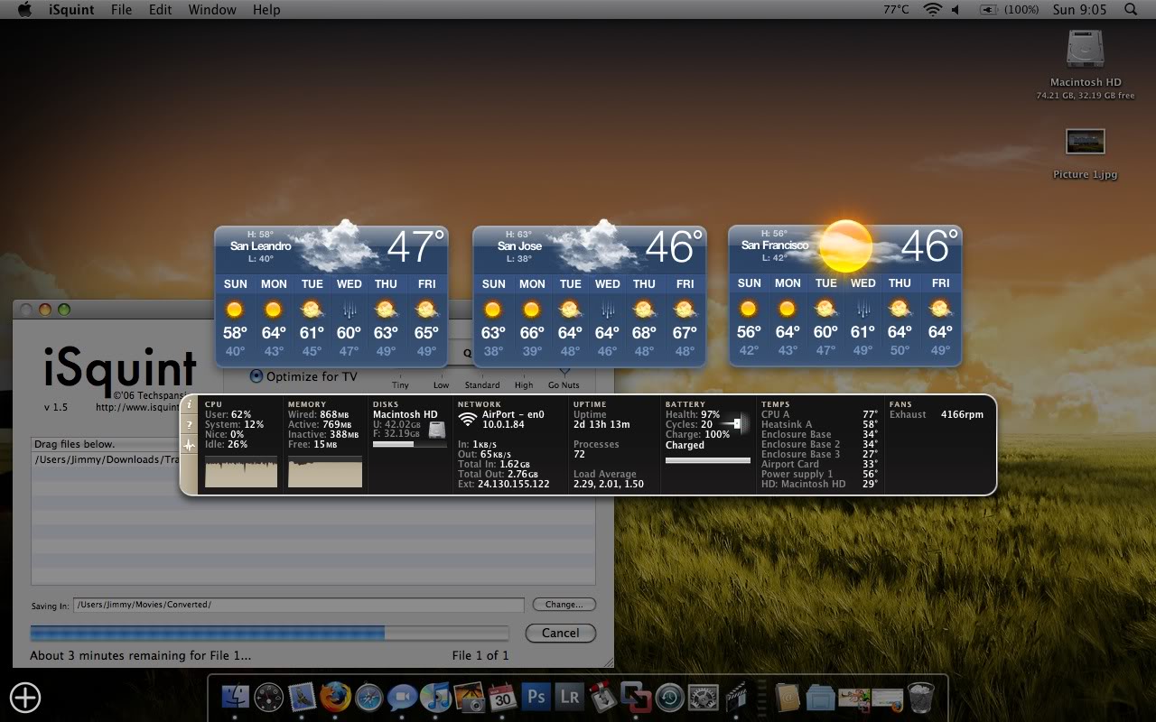

unfortunately no this program does little for fan noise
does little, but it does do something.
seen here:
I've been running iSquint for the past 15 minutes and the temps only hovered at 75-77 deg C, fan speed only at 4k+ and not going any higher. Hardly noticible fan noise, infact, my external hard drive is louder then the fan.
seen here:
