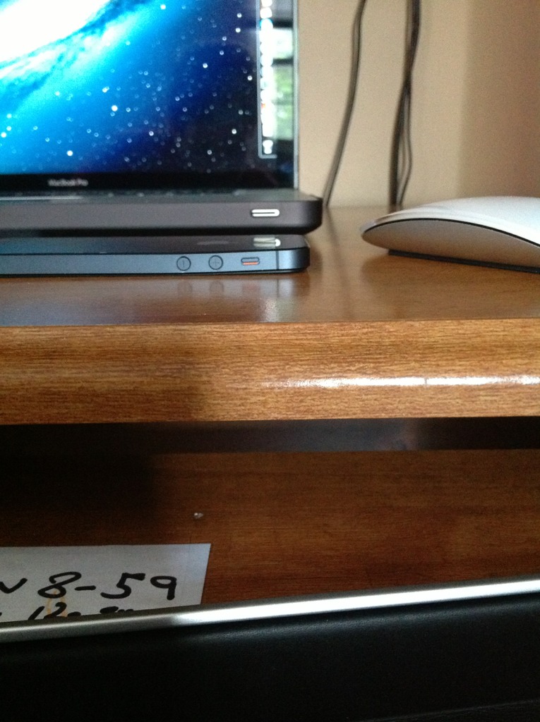

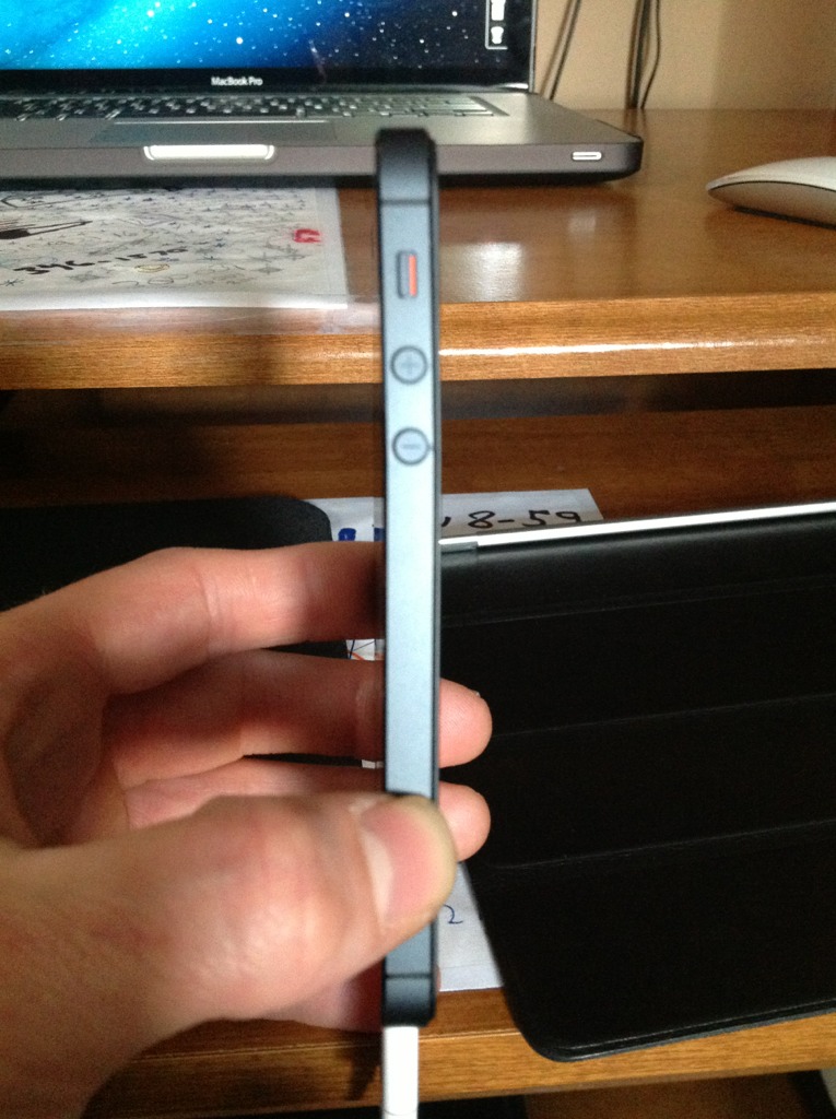

Well my perfect launch day iPhone is perfect no more.
And to be honest it must have happened in my pocket cause it never was dropped.
do u use it in the back pocket? did you sit on it while in your pocket? other causes I can't imagine.... sorry for that...
Ha good eyes.
It's just a black speck cover
And don't usually put the phone in the back pocket but something bent it lol. It's livable to me, I'm easy.

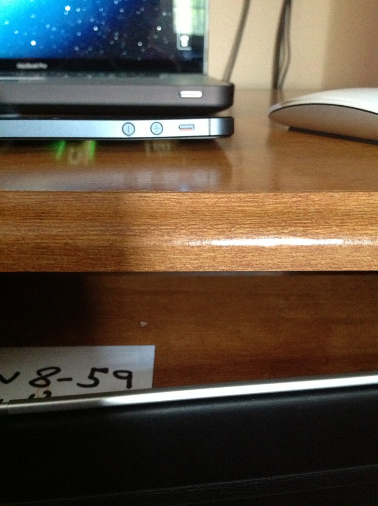

I think it would be very interesting to know the difference in structural rigidity between the iPhone 5 & shorter 4 & 4S. Actual data would be fascinating.
Skin tight jeans here,
iPhone 5 still perfectly fine 😛

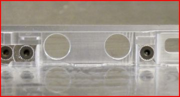

Aluminum has elongated at volume button hole. It is designed to be the weakest point, so that is expected result.
The volume button hole area from inside the shell, there is very tiny section of aluminum left:
Simple FEA-simulation spots the highest stress there:
Not sure if u can see in the pics but exactly over the minus volume button is where the stress fracture is.
