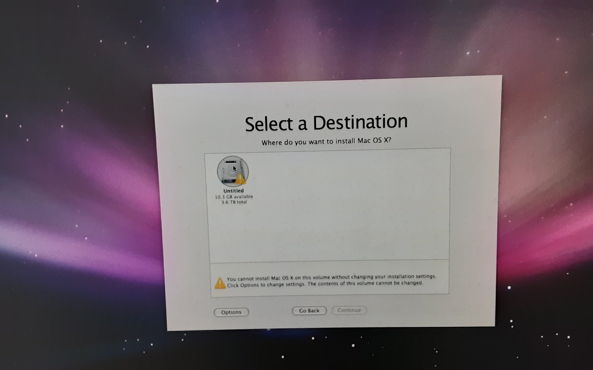

Hello folks, I did a few stupid things last 6mo or so, mainly brakeing my OSX 10.5.8 instalation on my 4TB sshd hybrid drive... I moved the drive(w/ working osx)from my G5 to my 2009 Mac Pro, started fine, then I had a few missteps there, on other drives and long story short I was only able to load the drive in single-user mode ,mount-uw &start commands,last time,on The Mac Pro, so I got frustrated and moved the drive back to the G5, it turns out you can't do that, so now, after trying the basesics I can't boot from it(the drive) the leopard,on either machine.
(First aid gives error, fixing permissions give error, so not working)....
I can't make heads or tails of the event.... formating the drive is not a priority or option...
I can access drive from diffrent hdd if I boot...(like from Sierra on mac pro or leopard disk on powerpc g5)...
I tried as last resort to graft the original files so it boots but I ended up making it worse,not able to fix permissions...
Now it hangs,on mac pro, or locks up/not finish loading on PowerMac G5 in verbose mode....
I-am kind of lost ... feels like a bad year... especially for me to mess-up my old main drive....
Any assistance is appreciated...Thank you
(I read there may be a way to upgrade the install?or recovery install without loosing user/files/etc)....

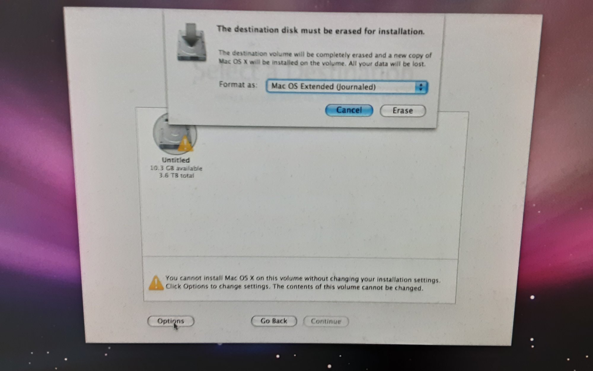

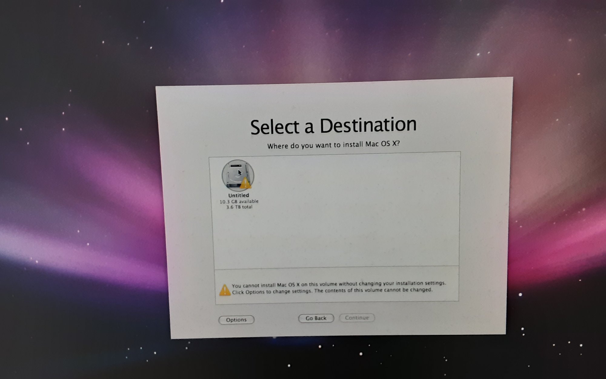

Won't it move all my users &3.8tb files into old?I already used a 10.5.6 dual layerd disk to no avail, it wants me to format the hdd... i can share a photo with this
I think I already replaced part of the /system folder, I will try again, main issue is it needs to be entirely permission fixed....after....
Makes sense. You're trying to install 10.5.6 (an older release) on top of 10.5.8 (a newer release), no wonder the installer is prompting you to wipe it.
Your best out here is probably to make a backup of your data and start over as it says.

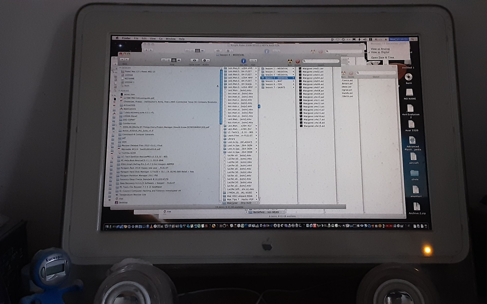

Anyway, updates... I'm so close to restauration it's palpable... managed to unlock drive,(from read-only) then lost the mounting, but somehow managed to check it with TTPro, (also did a permissions check), rebooted to ssd and no more errors, I copied a test image file, and now I am copying the system folder of the 4tb. into a zip archive backup (sadly I do have occasional errors in packing the old system folder... to zip,on new ssd). Hopefully tomorrow I can try copying the system folder of the new install onto the old 4tb ...."grafting" maybe a boot....fingers crossed...

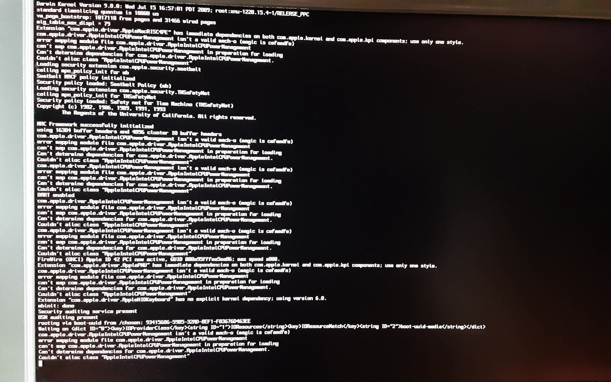

Mini-update.... After the graft , and (about 20x) Disk permission fixes (in TTP5 & D.util , fsck -fy 's) I managed to get to a point where I can load Single-user-mode (command+S)
Sadly It's boot-looping....
in Safe-mode is :
Complaining of not having PowerMac 7,3 Drivers... (wherever they should be who knows)
Panic CPU 0 unable to find driver for this platform = \”PowerMac7,2\”./n^0/SourceChage/xnu/xnu-1228/15.4/iokit/Kernel/IOPlatformExpert.cpp:1407
Backtrace….
Mac OS Version
Not yet set
BSD Process name Corresponding to current thread: Unknown
Panic : we are hanging here." yada-yada-yada
Q: Anyone know how can I manually install these PowerMac Platform Drivers?

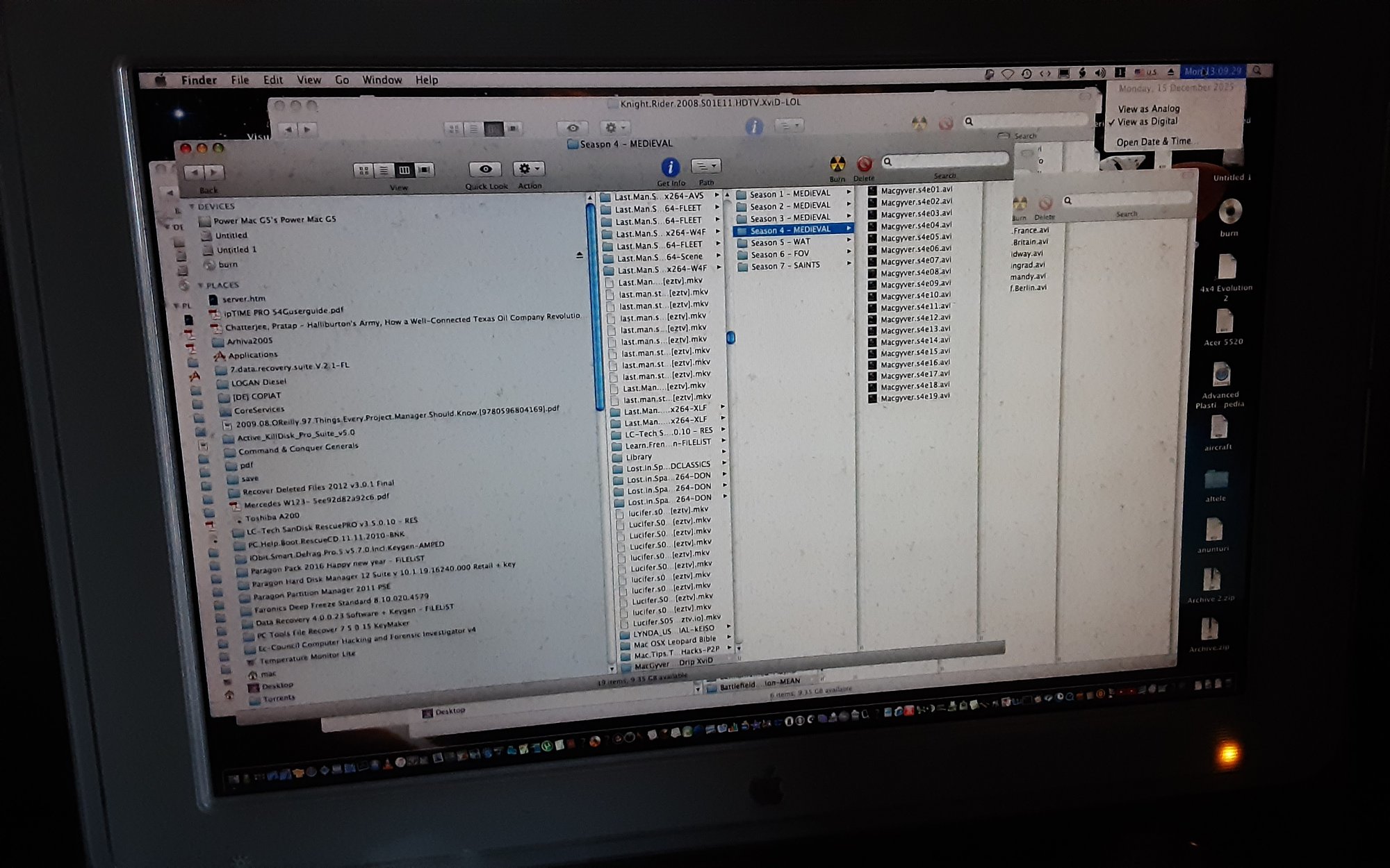

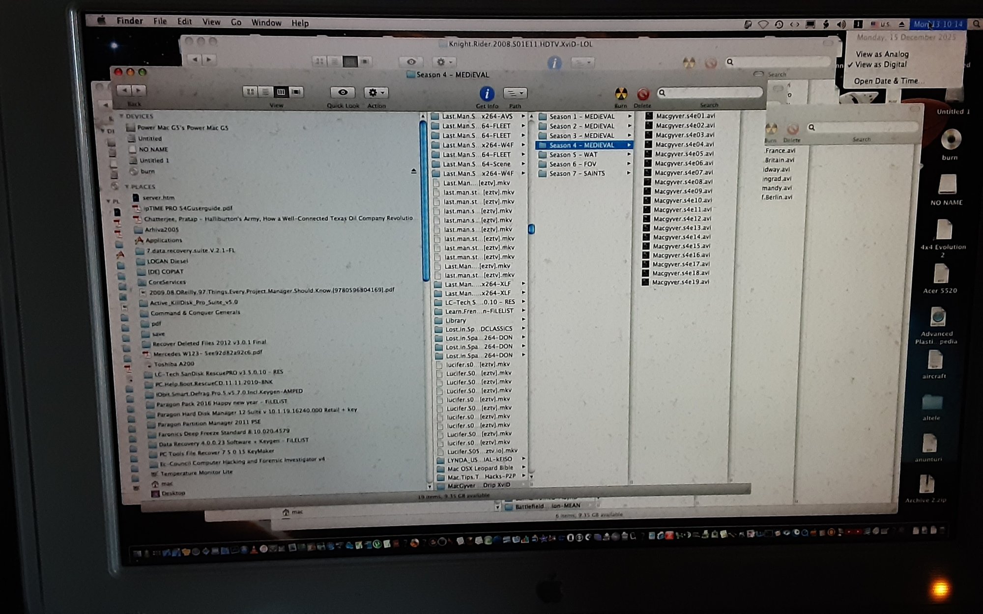

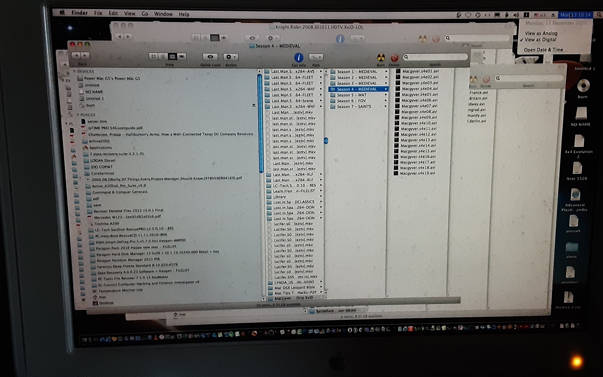

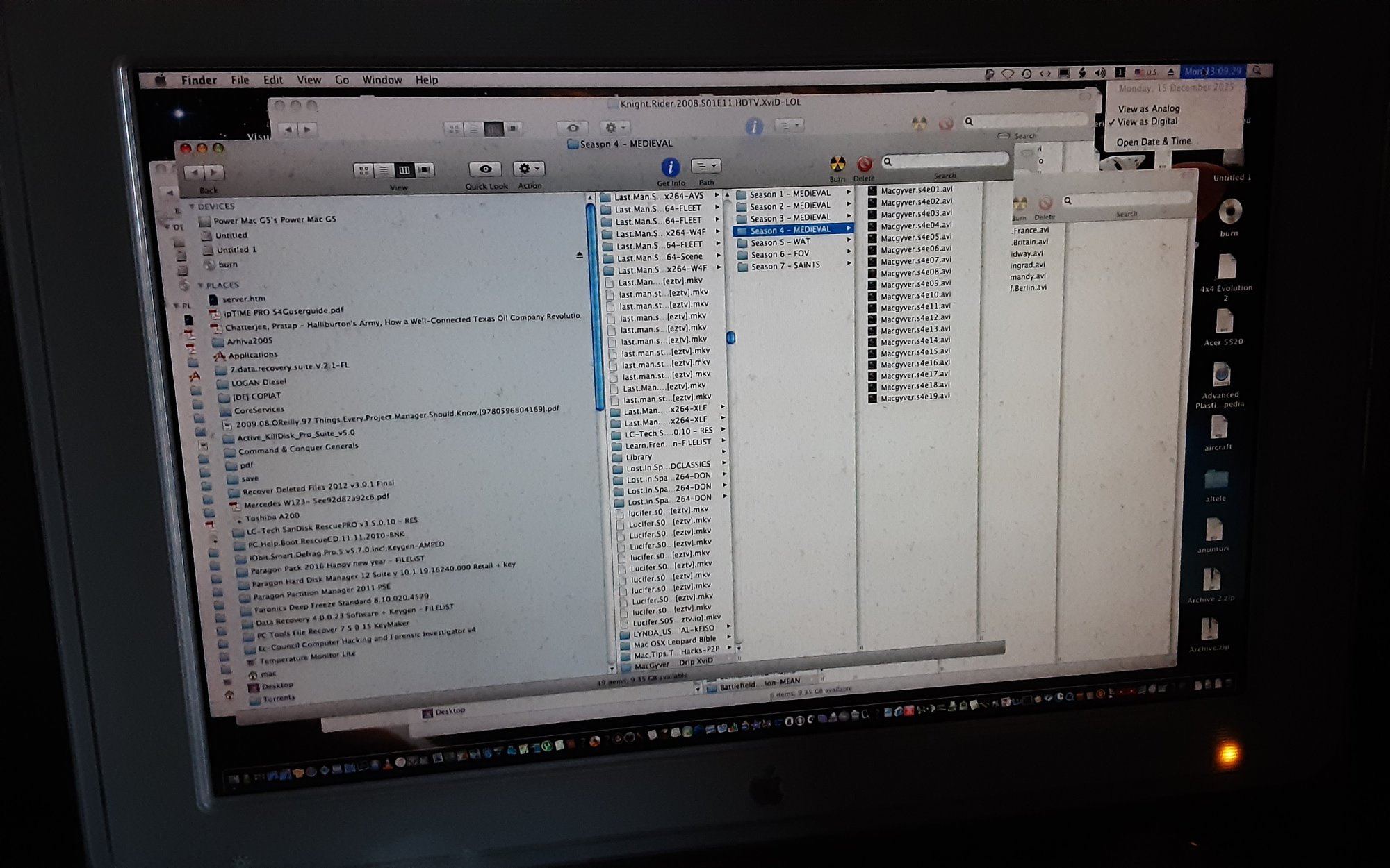

Apsolutley Incredible,incredible, I managed to save her!😎
Here is what I done ,(last night , as a apiffiney) :
For Anyone srugle-ing with similar problems :
1.
Download MacOSXUpdCombo10.5.8.dmg (there are x2 versions in the wild second is Leopard_10_5_8_Up.dmg_.zip)
2.Boot your Mac(PowerMac G5) of a good known install (hdd with leopard on it)
3.
Copy the download-ed file to that desktop (of your temporarry leopard hdd), open the dmg
4.Start the installer > when you see :
5. Select your location where you want to install your update to : You select your old drive (hdd) with the broken OS X Leopard 10.5.8 on it.
6. You let installer finish (and you reboot)
7. You should have a working OS X Leopard Now! (maybe new start screen with song will launch).
TIP:If you are haveing issues do all this with 2x DDR modules installed only,
& (I may have started the reset-password procedures during my trails , so it stated as fresh OS X wanting me to create new account , you can do this and delete the new acount after or bypass it , command Q skips registration and maybe creation of account ).
