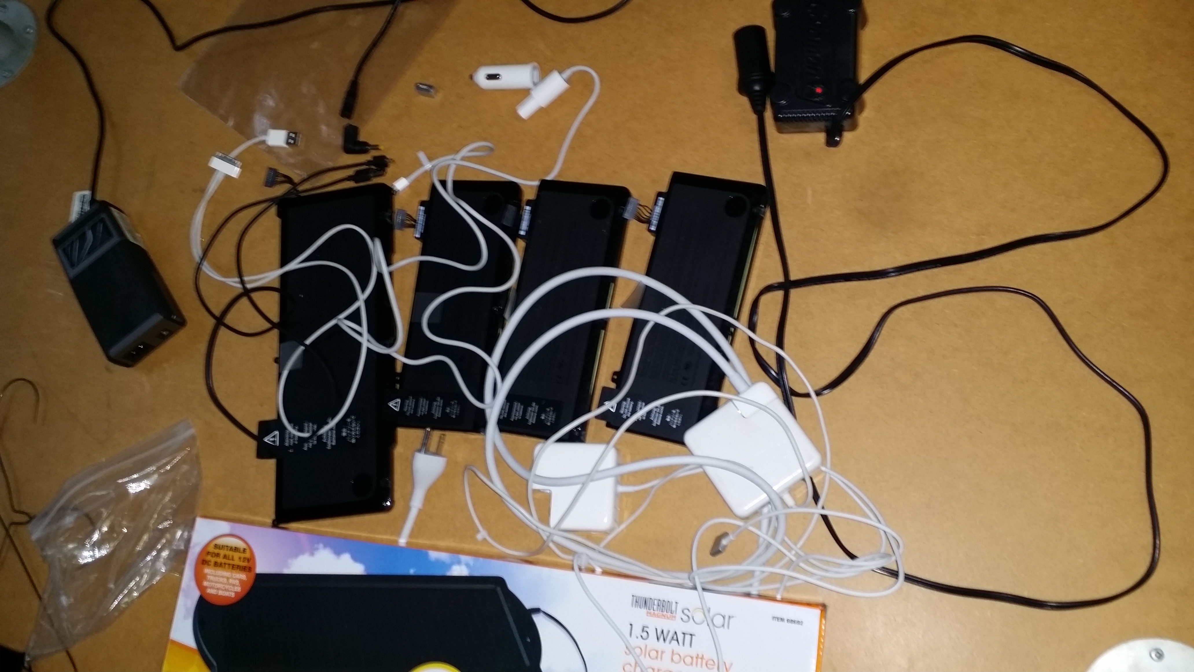

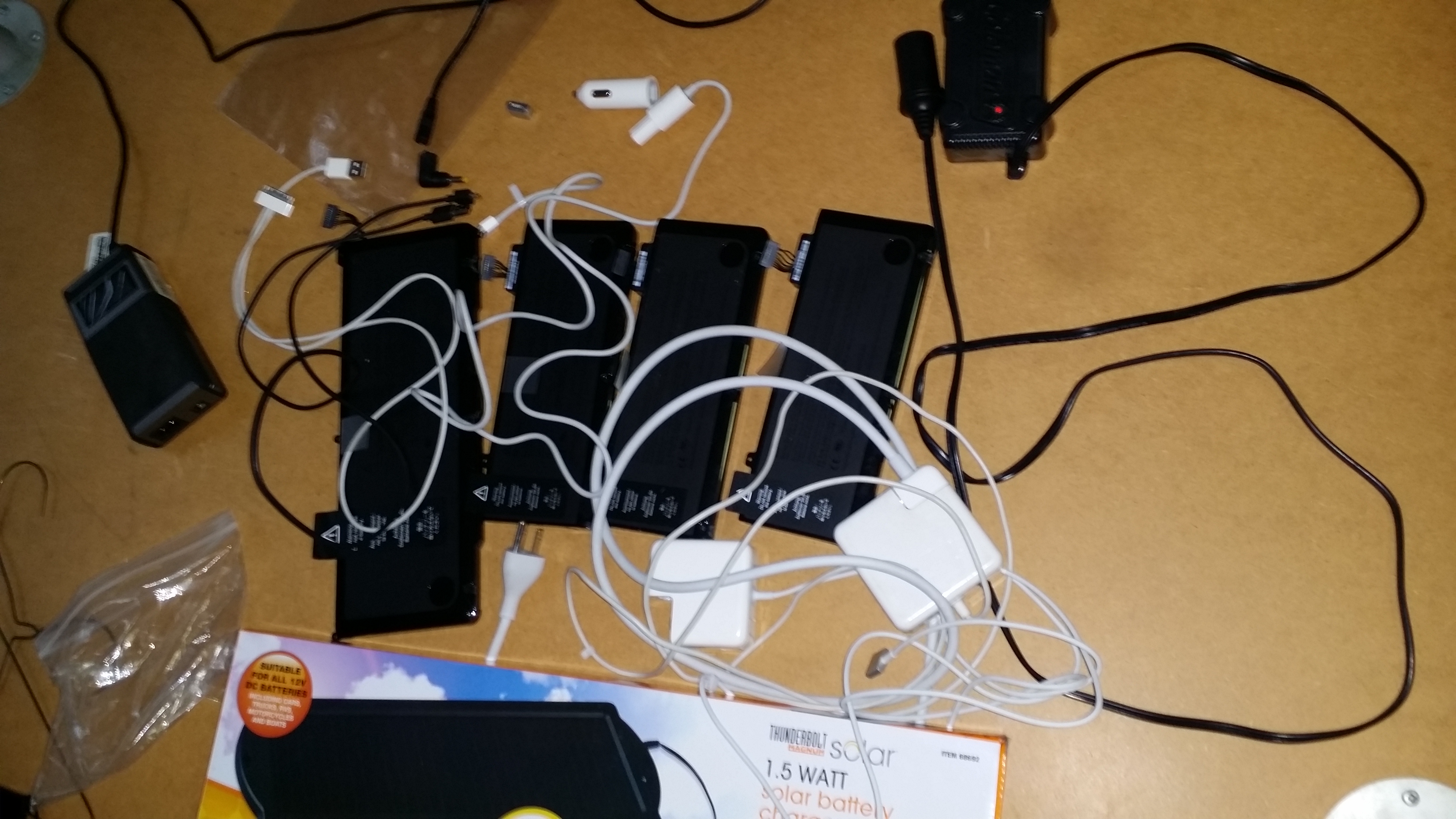

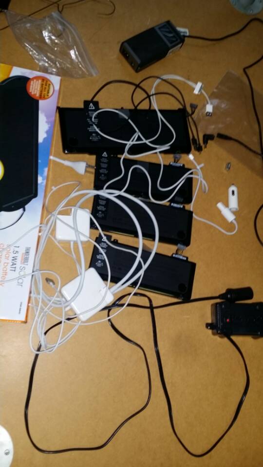

I started to take them apart.
My project is big, car battery size battery bank when I drive across the nation. I plan to connect 4s batteries running 14.4~14.8v(to be safe) in parallel with charge board, then the charge board to lithium battery charger. inside the car I will connect them all in parallel to a cig lighter plus inverter setup, so I can more effectively draw power at the native speed. I will abandon the self made MagSafe idea since I already have the travel charger, I'll just hookup cig socket to my battery bank with a female connection like one used for the balance charger.
I will have to solder balance charging cables to the batteries cells, each parallel in each 4s battery pack will have 5 wires being 3.6 7.2 10.8 and 14.4. I will be able to charge up to 6 of them at a time running the charger at 6 amps. this will surely cut the charge time down.
I dug up more laptop batteries and harvested some pretty decent 18650 cells, on top of that I took apart 1 13 inch, and 1 15 inch old macbook pro batteries. one pair of cells are some what dead running at 2.6 v in the 15 inch, all other cells are great. I will try to pair another 2 pair of cells from a 15 inch to create my prototype.
If I can somehow create a decent looking casing for my prototype and also figure out a decent priced protection board that supports the native temperature control sensors from the macbook pro batteries, I can reuse a lot of the stuff I pulled off.
Thanks for blocking the reverseable setup idea. I really have no use for the old mac batteries anyways, just thought that the casing was really small.
In fact, if I can figure out what the 9 wires coming out of the mac battery protection board does, I can use one of those as a board.
So far, the only protection board I can reuse right away are these 2s 7.2v boards I harvested off of 2 HP 7.2v batteries. They are 8 cell battery with 4 in parallel, so if I connect those in series I should get my 14.4, and then from the control board it should be pretty simple. Only for soldering balance charging wires it can be tricky.
Any ways, great ideas.
PS: 2 ideas for mobile charging I want to run by you guys, cause all of you seem very smart. 1, I bought a 3 to 1 plus USB outlet cig lighter socket connector, I want to connect 2 small solar panel running at 12v to 2 of the socket and then 1 dual cig cable to the car cig socket and the battery bank, but will this charge the battery at all? being that the car battery is at a lower voltage than the battery bank.
I mean I can surely harvest only 3s and have it all work at 10.8v with minimal customization, but I kinda wanna be safe on some cells failing, as it all inevitably happens. I already bought 20 4s wires, can I use them as 3s wires and abandon the 1 extra wire?
And 2, If I were to abandon temp control protection, and just put them in a modified Rubbermaid icebox, which will protect me from it in case things do go south, will that work for charging? I mean when running I have a vented box I made to sit it in the rear passenger side of my car, and there's always the smart option of draining one battery at a time, so it should be pretty safe, but charging is something I am still weary about.
Let me know, thanks.
