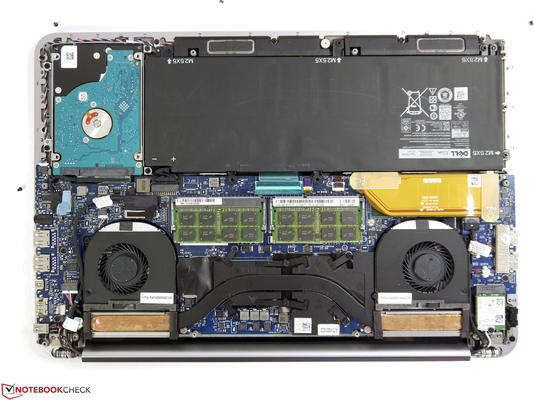

No. It's like a MBP. Internal six cell battery or 9 cell battery. If you want to add a second hard drive you can't buy the 9 cell battery as it's bigger and does not leave space for a second hard drive.
Pic with a 6 cell battery and second hard drive. The first hard drive is an Msata one under the yellow ribbon.
And here is a pic of the m3800 and the MBP:

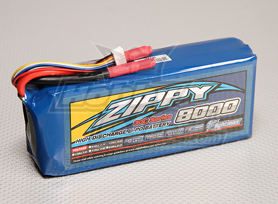

I guess 18.5v will do. I'm thinking about this one:
http://www.hobbyking.com/hobbyking/store/__16227__zippy_flightmax_8000mah_5s1p_30c.html
As for amperage I guess I'm good too. I found an explanation of how much you can draw from a battery based on its discharge rate. So according to the battery spec I can draw 240 amps :eek:
https://www.commonsenserc.com/page.php?page=c_ratings_explained.html
Here's the easy way to find your battery's discharge rate just multiply the number from the C rating by the pack's capacity. Keep in mind that 1000 milliamps equals one amp. Here's an example, using an 11.1V 2000mAh 10C
11.1 volt 2000mAh -10C
2000 milliamps = 2 amps
2 Amps x 10 = 20 amps continuous discharge
This means that you can safely draw up to 20 amps continuously from that 11.1V 2000mAh 10C without doing damage to your battery.

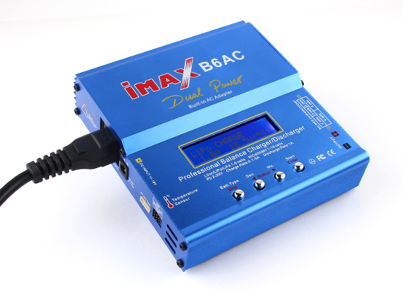

Not sure I get you there ! I want a lipo charger balancer for the batterey I mention earlier in my posts. The charger is described as compatible with the 6 cell lipos.

Quote: “... I want a lipo charger balancer for the batterey I mention earlier in my posts. The charger is described as compatible with the 6 cell lipos.” [sic]
While you need do compatibility with your battery, you do need to shop and compare up-to-date reviews, because some chargers are really poorly-made junk. The model aircraft sites are really good for reviews, but keep in mind that things like fast charge rates for chargers and batteries, and high discharge rates for batteries, aren’t important for laptop use, so don’t pay more for any features that you won’t need. If you travel much, you might like the choice of using mains power OR a 12v input for the charger, otherwise, you can choose one or the other. If you do your homework, you won’t have any regrets, but if you don’t… well… YMMV.

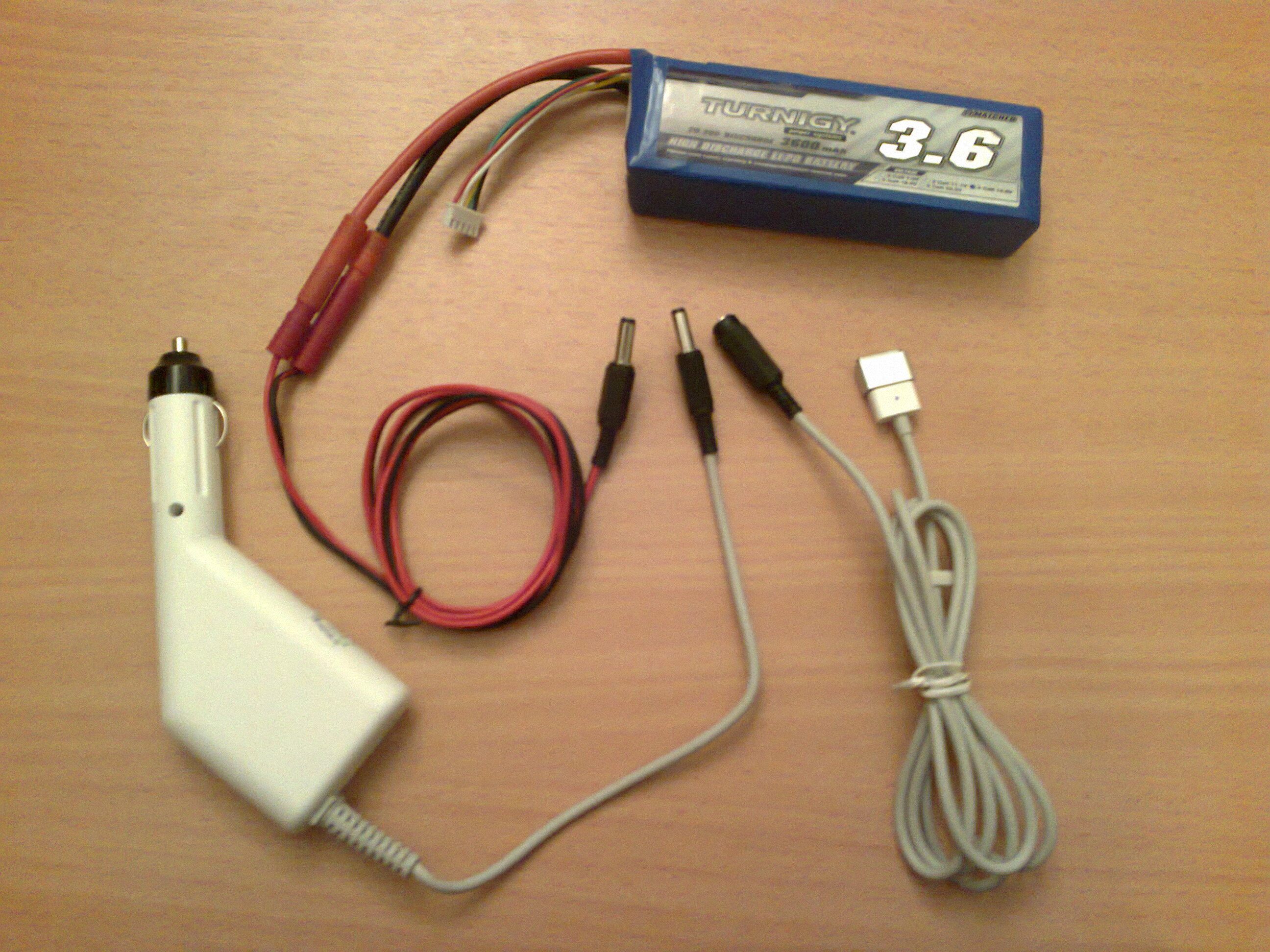

I needed more portable battery power and did not want to spend $200+ for a hyperjuce so I made my own external battery pack for my Macbook Air. It’s 65w LifePO4 battery, 4400mAh @ 14.8 volts, I do not know the total time it will last for but I used it for 6+ hours and it was still going strong, my Air is a i7 with the bigger processor, the battery is small and light making it convenient and easy to carry in your laptop bag or backpack.
My total cost including the charger is less than $80, the battery was $28 so after the cost of the mag safe connector and charger I can add more battery packs for $28 each or spend more on a larger capacity one.
Battery = $27.99 I chose this battery because it fits in a small side pocket in my laptop bag and is not big and heavy. It is 4400 mAh at 14.8 volts or about 65 watts, I think the standard 2011 Macbook airs battery is around 50 watts???? After 6 hours my air was still going off this battery with the screen brightness high and I ripped several dvd’s with handbrake, there was no ‘light’ use during this time.
Hobby King has a tool for selecting batteries, you choose your type, LifePO4 is what I ordered and select your voltage (14.8 volts) and they list batteries by mAh...
Charger = $24.95 - smart charger for 1-4 cell, if you buy a battery with more than 4 cells make sure you buy compatible charger for more cells.
I bought a used apple power adapter for $20 to remove the wire with the mag safe connector, I soldered 4mm radio shack quick connect bullet connectors on the end of the mag safe wire after I unsoldered it from the apple power adapter, the white wire is the positive wire.
This setup has been REALLY GOOD to me, for another $5 you can buy a car USB cigarette lighter 10w power adapter and connect it to this battery for an iPad or iPhone. I leave the battery in my laptop bag so all that comes out is the wire to plug into, it's a pretty slick setup that you can add more power anytime for not a lot of $.
