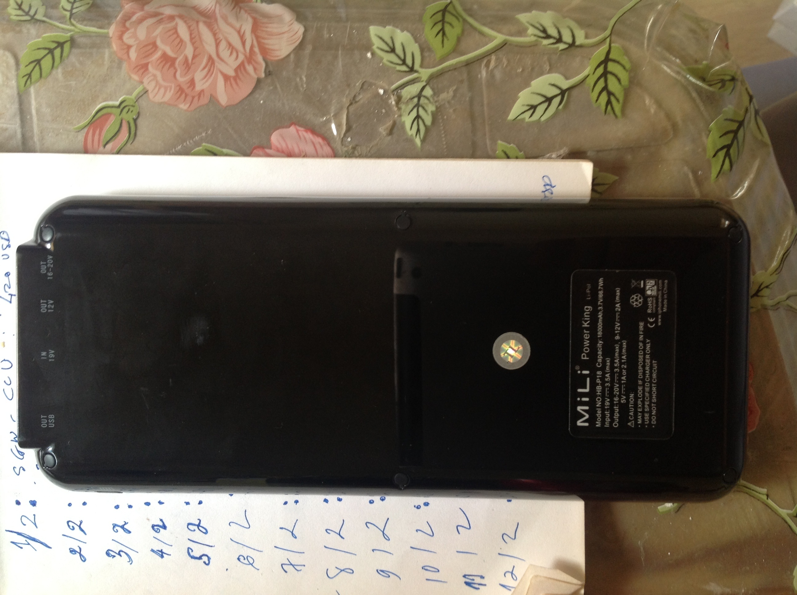

Hello Bros,
I have MiLi Power King (Li-Pol) 18000mAh
Output:
16-20V === 3.5(max)
9-12V === 2A(max)
5V === 1A or 2.1(max)
My question is: can I use the output 16-20V for my MacBook Air Mid 2011 - 14.5V === 3.1A (45W MagSafe adapter)
Thank you so much and waiting for your advice!!!

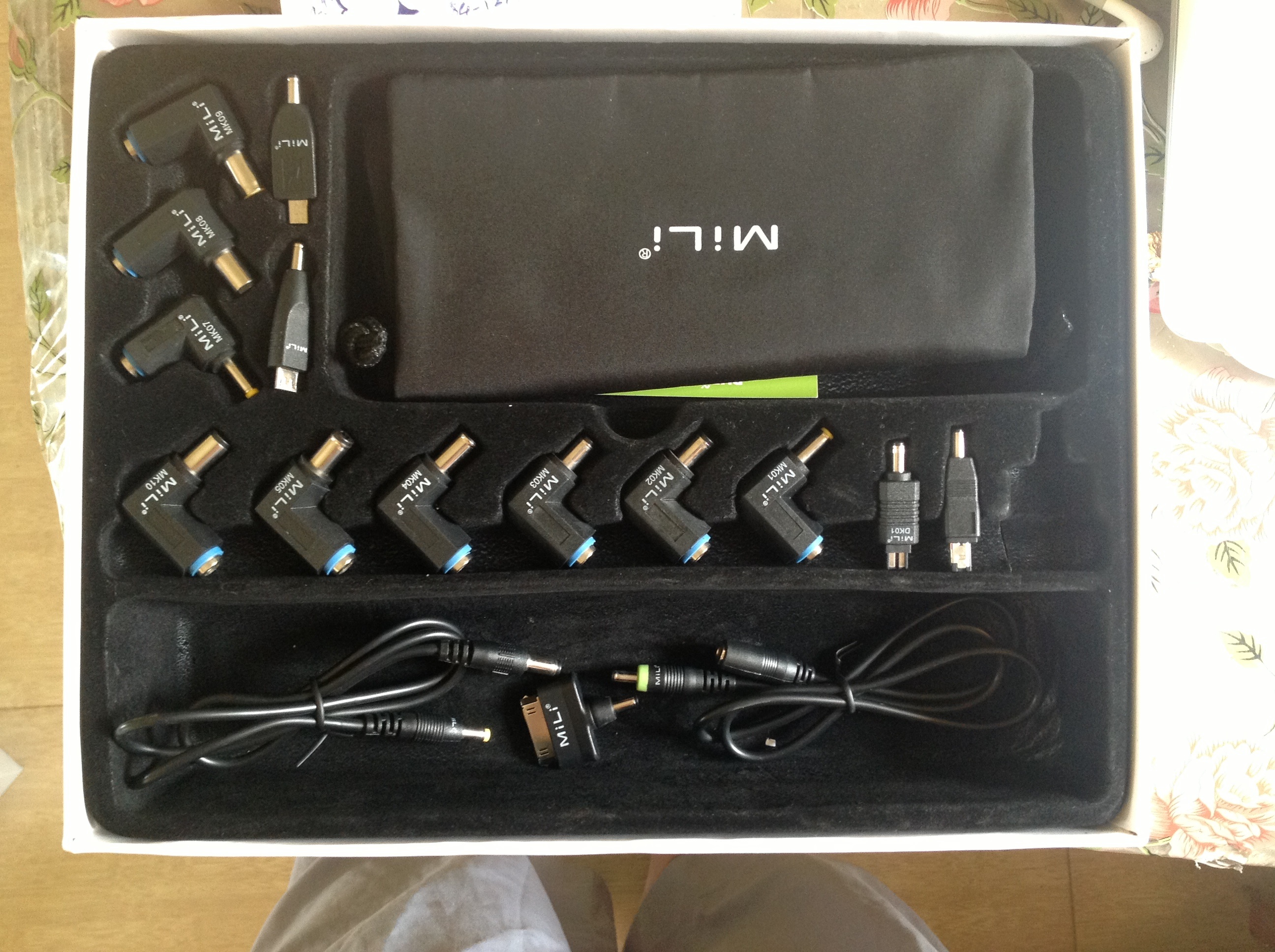

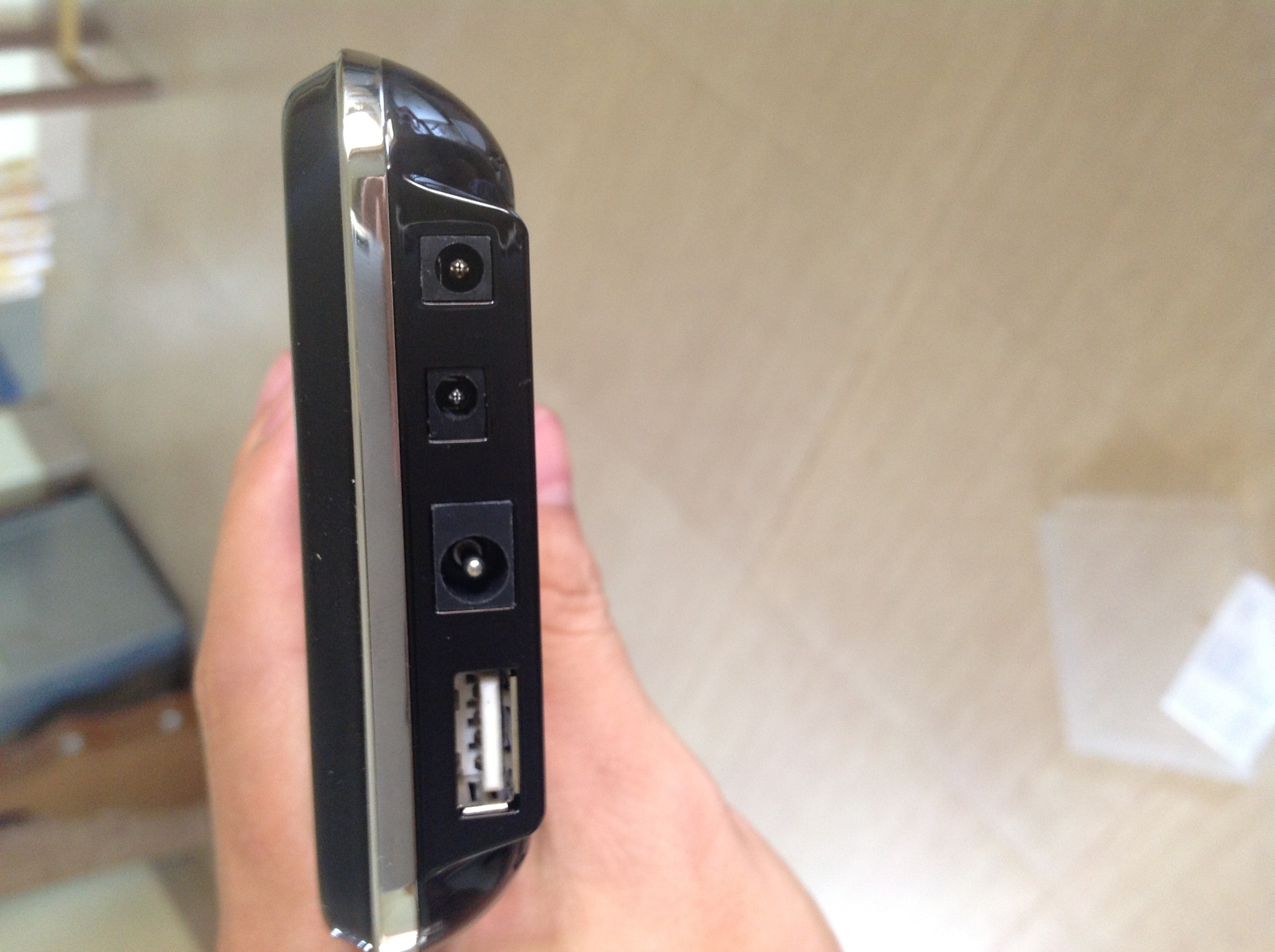

Hello Bro Skinny!
I don't know how many cell of this battery but I can show you photos below.
Thank you so much Bro!

Hello Bros,
Output:
16-20V === 3.5(max)
9-12V === 2A(max)

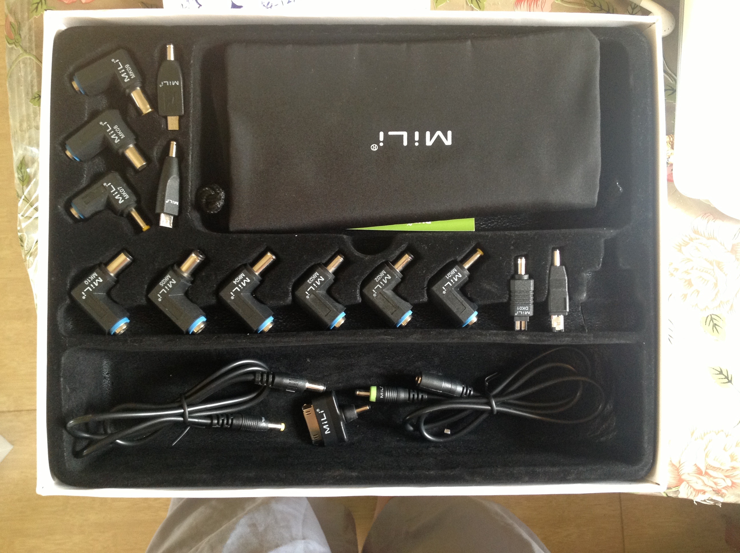

Photos
Hoang, without knowing more about the internals, I can only make some guesses, but if you have access to a multimeter we can figure this out.
I’m guessing that those adapter tips work like the adapter tips that come with universal laptop AC adaptors, like from Targus, Kensington, and others, where you select the voltage range on the battery, and the tip reduces the voltage, by means of a built-in resistor, to what’s required for the particular laptop. To check this: with the battery charged, and the battery voltage set to 16 to 20 volts, read the voltage at the output cable with the meter, and note that voltage. Then, install a tip, read that voltage and note it. Do that with several tips; if the voltages vary, then my guess is correct.
If one of the tips with a standard barrel connector outputs 15.5 to 16 volts, mark it.
Do that much, and post your results here, then we’ll proceed, okay?

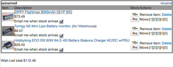

Hi gang
I've been trawling through this thread and doing all the research I can and have come up with a combination of products I'm hoping will work for powering my early 2011 MacBook Pro 13". I do a lot of location work and am in need of more power to keep going all day while running some pretty taxing photography programs.
I've tried to find out all I can about the output of the mac charger and the demands of the lappy. I'm still new to this so thought it best to ask on here what someone more qualified than me thought?
I'd love to get some feedback about this combination from someone who knows more about this than I do, who might have any reasons for this not to work before I go and fork out the coin.
battery:
http://www.hobbyking.com/hobbyking/store/uh_viewItem.asp?idproduct=16227
charger:
http://www.hobbyking.com/hobbyking/store/uh_viewItem.asp?idproduct=22297
monitor:
http://www.hobbyking.com/hobbyking/store/uh_viewItem.asp?idproduct=42562
Any feedback would be awesome!
Hi rubbit,
That combination looks like it would work just fine, but you might save some money by getting a battery without the high discharge rate; your lappy will never be able to that much power so fast.
Also, without a monitor with auto-cutoff or an audible alarm, you'll have to remember to keep an eye on the monitor; if you allow the battery to over-discharge, you will ruin it. Its awfully easy to get engrossed in what you're doing on the computer, and forget... If you do go for an auto-cutoff monitor, just run from the external first, and then use the laptop's battery if the external shuts down.
Have fun...
