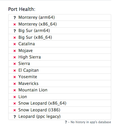

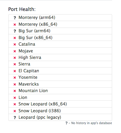

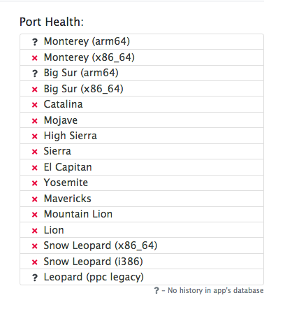

I had a look at what macports requires for building Signal, and noting how one of its dependencies, nodejs8 (which is needed for building yarn, which is used for launching Signal), is a huge stumbling block.
It appears, at least via macports, there’s been little success of building it on any iteration of OS X/macOS:
I tried it nevertheless in Snow Leopard (10.6.8). Though the error which halts the build isn’t elucidated in the logs, my guess is it’s the need for clang-13, which needs a much later version of OS X/macOS — I’m guessing at least Mavericks, but I’m not completely certain.

My point for posting that cap is more that the bot builds have been unsuccessful at building nodejs8 on any version of OS X/macOS — which, one might extrapolate, would hint at a very difficult road for trying to build the same for 10.5 or 10.6 in a PowerPC setting.
