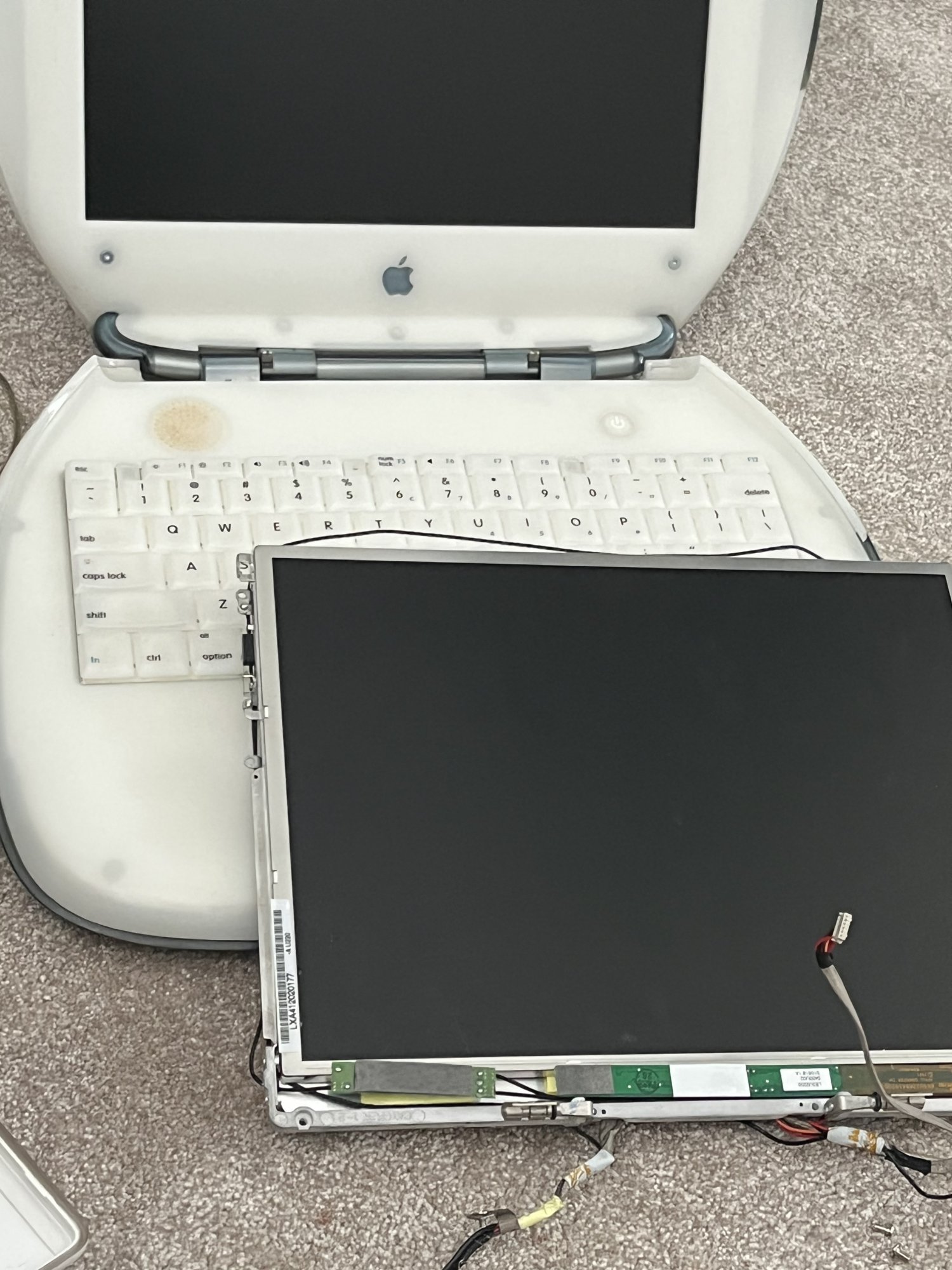

Sorry if I am hijacking the thread, but do you happen to know if Snow iBook display cables work in Clamshells? I am going to attempt to swap the displays and display cables between the iBooks. Looks like the repair is going to be strenuous..
Again, Google is a great friend. 😉
Using it, I found the following discussion from within this very forum.
The clamshell displays are all compatible. You can even swap in a later 12" G3 iBook display, but there are some restrictions about that. I suggest further research if you want to do that.
From what I've read here, the issue with your white screen might be a blown fuse on the LCD itself.
I think some LCDs have a fuse on the LCD panel or something, and when it blows, the LCD displays a white screen.
Dismantling iBooks is a strenuous activity. I have one that I partially dismantled and then I gave up on continuing any further... 😀 Take your time, document every step with images that you can refer to later and above all, be patient. You'll succeed. iFixit has guides which are usually quite good. If you haven't already checked out their Clamshell ones, here they are. 🙂
Having dismantled quite a number of Clamshell iBooks I agree that it's not an Apple laptop that one should start out on if having never dismantled other models. Removing the keyboard and Ram sticks is simple. Removing the top cover can be stressful until one learns the trick. The HDD removal is an excercise in frustration and patience as the screen has to be removed and also a large, annoying EMI shield. What the devil were the Apple designers thinking of? 😵
This is why I abandoned an attempt at the halfway mark to replace the 10GB HDD in my iBook G3/500 with a 120GB SSD. At some point I'll return to it but as you can probably tell I'm hardly enthused about the task. I'd rather tackle the many soldering projects stacked up in my repair pile. They're easier!
"We shall deter the consumer and non-Apple repair centres from tinkering with our laptops"? Either that or they wanted to make the Apple repair technicians suffer.
You have to wonder how many faulty machines were just replaced with new ones rather than endure the nightmare of disassembly just to remove a dead hard drive. On the contemporary products of their rivals, the HDD was usually accessible from a slide-away compartment and the removal of one screw.

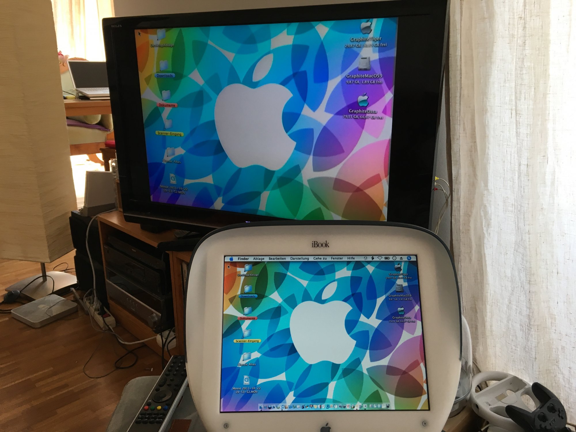

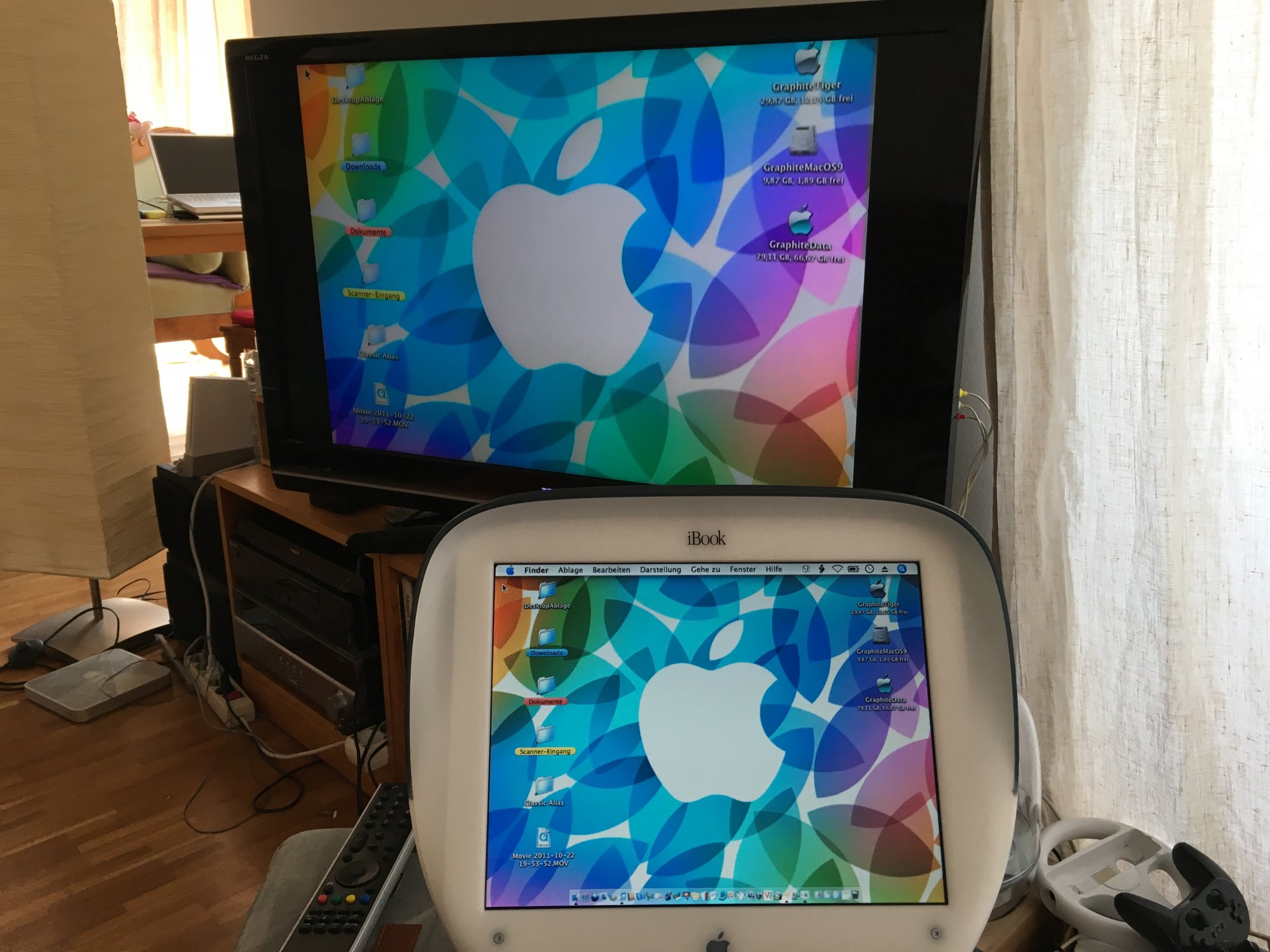

Do we know if on Computers this old mirroring would impact machine performance if say you were playing a game? I always thought the original could do Video Out as I'm pretty sure Steve says in the keynote but apparently you need a 466mhz that has the 8mb of video ram. I know it's locked to mirroring and you can't extend monitor.
This is, how it looks like, when running video&audio out through that "3.5-Klinke to Cinch-R/L-Audio+Video" cable ...
(well quite some time ago!)
