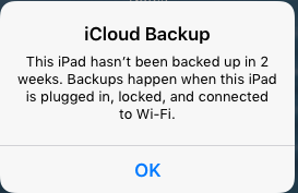

I got this pop-up on our iPad this evening.

[doublepost=1453698878][/doublepost]I got this pop-up on our iPad this evening.
.View attachment 612314

Sorry. I meant that post as sarcasm. The iPad finally warned me several weeks after the problem began. And worse yet, the warning implied that the only reason my iPad had not backed for weeks was my fault for not plugging it in while connected to Wi-Fi with the screen locked :0
I guess it hadn't noticed that I've been capturing console logs of its iCloud backup failures for the last several days 🙂

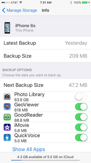

What’s wrong with this picture?
How can a Backup which is only 209MB in size include the 618MB of data in GeoViewer? Not to mention the 88.8 MB in GoodReader, etc..
I was pretty pleased that our iPhone 6s and 5s were automatically backing up to iCloud for the last few days, until I realized that all of the data that I had chosen to backup (green toggles) could not have been backed up.
When I unchecked and rechecked the big three (GeoViewer, GoodReader and LightRoom) the next backup size went from 47.2 MB to 428MB. And it took a couple of attempts to complete 🙁
—GetRealBro

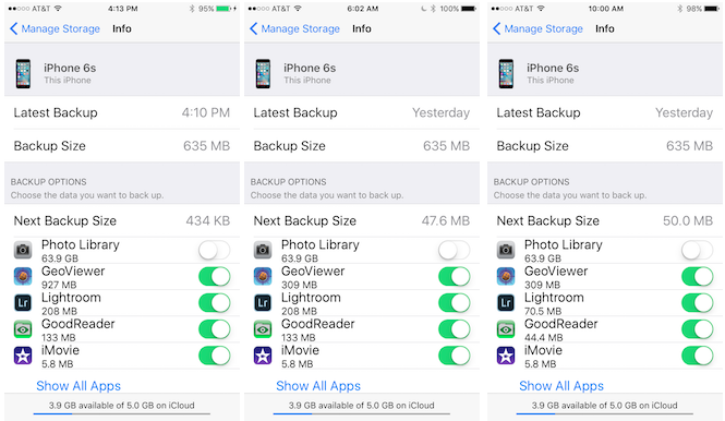

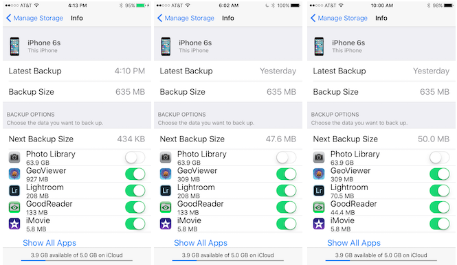

I no longer think all the iCloud backup issues being reported in this thread are strictly server related.
The following screen shots were taken on my iPhone 6s. The first one was taken a few minutes after a successful iCloud backup yesterday afternoon. The middle one was taken this AM. And the last one was taken at 10AM today after I shut down the 6s and restarted it.
The interesting part is the different sizes of the data for GeoViewer, LightRoom and GoodReader. No data has been added or deleted from these apps in months. Yet iOS 9.2.1 reports large differences in less than 24hrs. FWIW the last one is probably the most correct because the Aerial photos in GeoViewer take up 324MB in OSX.
Note: I had turned off the backup of the data for these three apps as part of an iCloud backup test I did on Jan 7th at the Apple Store. Looking back over similar screen shots I made in my testing, the data for these three apps has not been consistent/correct since then.
—GetRealBro
—GetRealBro
Looks like you may have something different going on here. The issue that seems to be affecting most is an "internal server error" in iCloud logs. You're actually backing up, so it seems to be something different.
I agree. One fundamental difference is that I didn’t recently delete the iCloud backups of our 2 iPhones. But I did delete the iCloud Backup of our iPad Mini that was backing up to the same account until earlier this month.
And I recently (Jan7) changed which app data was to be backed up on our iPhone 6s. When you do this the warning is that the app’s data in the iCloud will be deleted. So while I didn’t delete the whole backup. I probably did delete some parts of it. And interestingly those app’s data are the only ones not being handled correctly. So this may or may not be linked to the same server issue.
