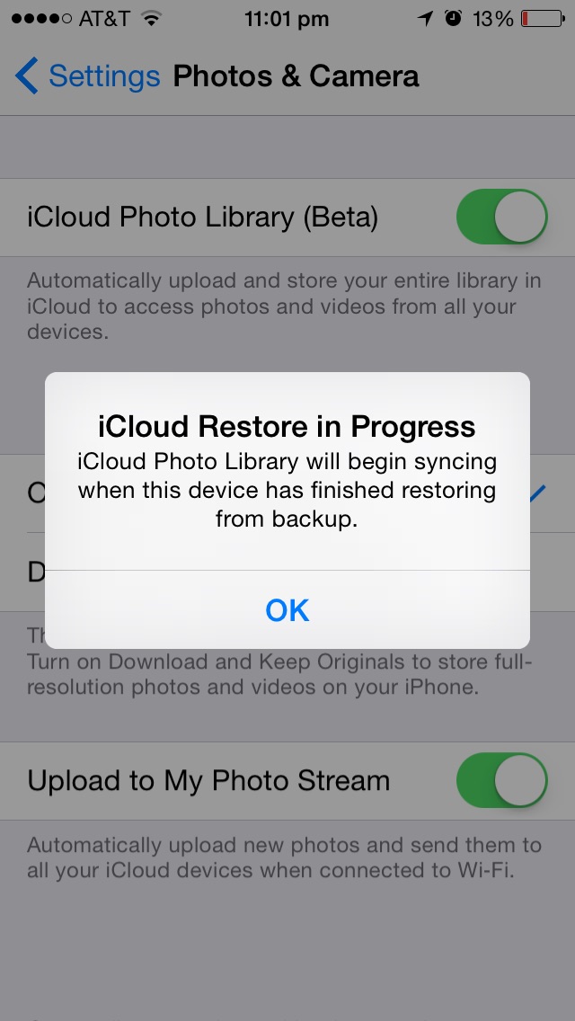

I keep getting this error every time I try to turn it on, but I didn't restore my iPhone at all? I then restart my phone and it does the same thing again but then proceeds to upload but is stuck anyway. I honestly have no clue as to what I should do..

I figured out my issue with the "frozen" upload. Once I opened the photos app and see the data indicator, the pictures are then uploading. The photos app has to been open for it to work on my phone. Figured it would work in the background, but this will do for now. So whoever mentioned opening then photo app and just leaving it there for them to upload was a good idea. 11 days of no uploads and now I have everything backed up to ICPL.
You're welcome! 🙂 I think their might be a glitch with ICPL. It should be a system services app that allows background app refresh to keep sending data. Especially, if you're plugged in and on wifi. But this is still beta so I'm sure they'll be some more tweaking going on. As for anyone that missed it. Please leave your photo app open and let it upload. It'll be a lot quicker, instead of waiting in the background for it to upload. Now if we could only figure out when the phone will optimize photos on our devices that would be great. lol 😉
