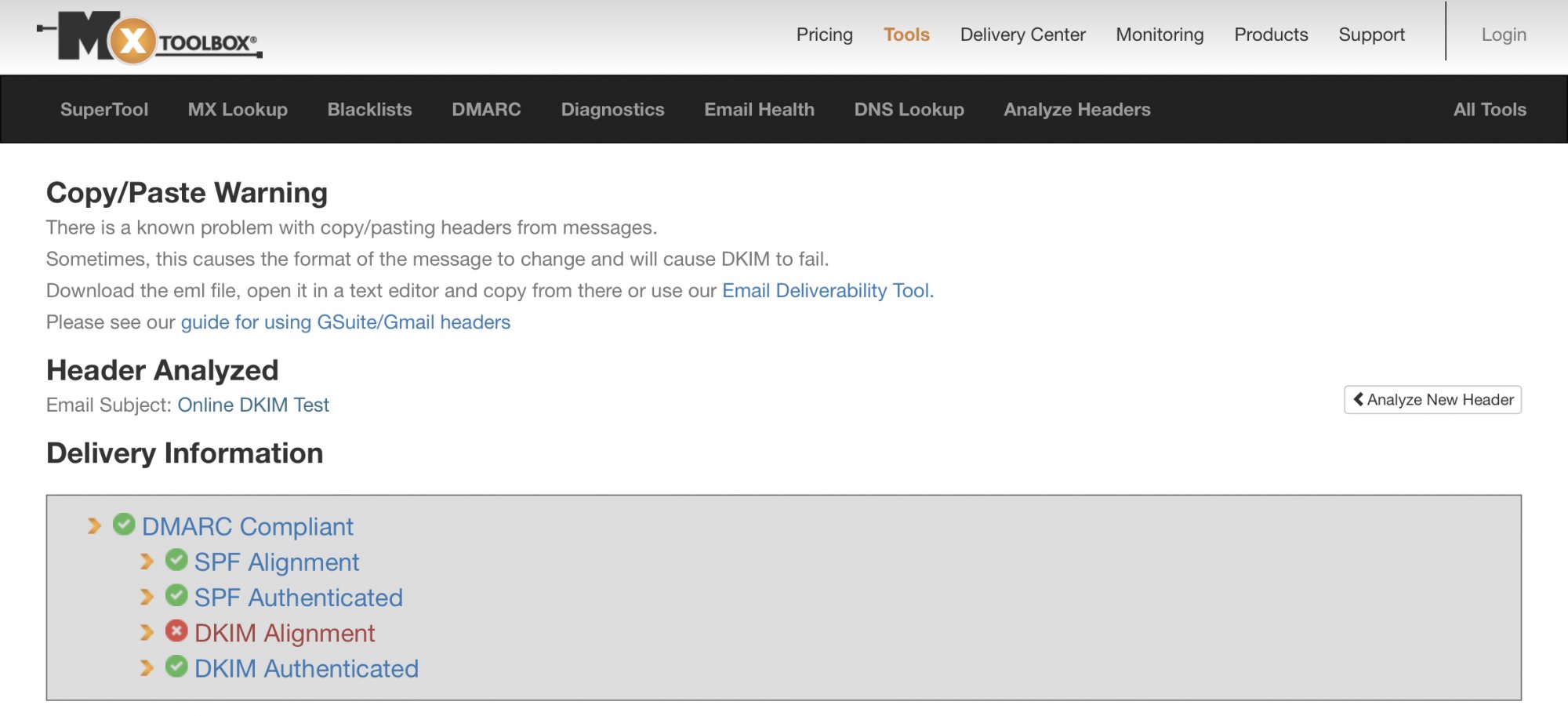

Ah, gotcha. I thought that's what the CNAME for sig1._domainkey was for
For some reason, the authentication is off. I believe it’s because it’s still returning iCloud.com, not your domain when authenticating. This is something Apple needs to fix. I believe, in many scenarios, this by itself won’t land an email in spam, but when you have what looks like a marketing email (links/images) it tips the spam score over the edge.
I’ve noticed sending mails from the iCloud.com website makes the DKIM alignment being correct.
Anyone found out how to correctly configure DMARC to use with this as well?
Just tested a mail sent from the web interface with https://www.mail-tester.com/ and got a 10/10 score with only error/warning being no DMARC record being published.
That is pretty strange. When sending from iCloud.com, DKIM authentication comes back green (through alignment is still an issue). When sending from an iOS device they both come back with an error. All of this should be sending from the same SMTP endpoint with the same config. Very odd behavior. Mail-tester.com seems pretty happy with the config though.
