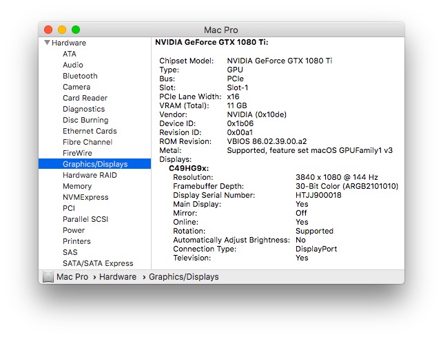

But it sounds good that it works well for you. Can you check the level of Metal support in 'about this Mac'?

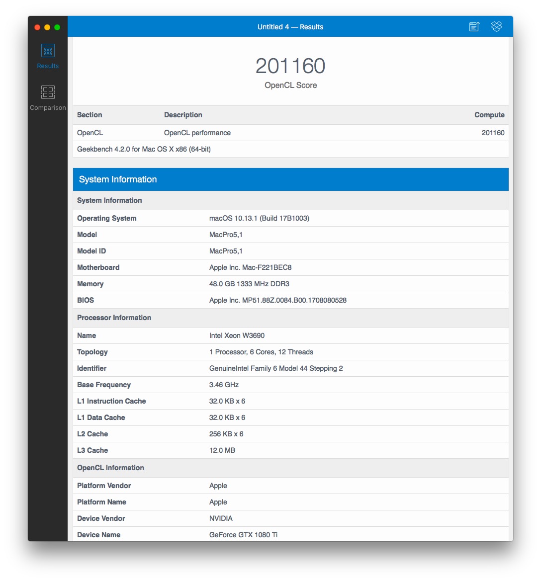

GeekBench 4 Metal
GeekBench OpenCL

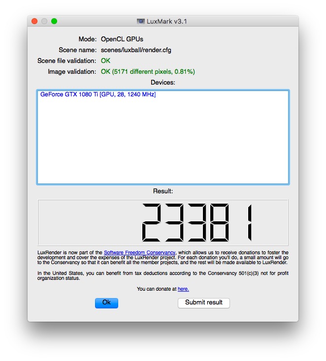

Luxmark 3 Luxball
Luxmark 3 Mic
Luxmark 3 Hotel

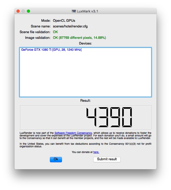

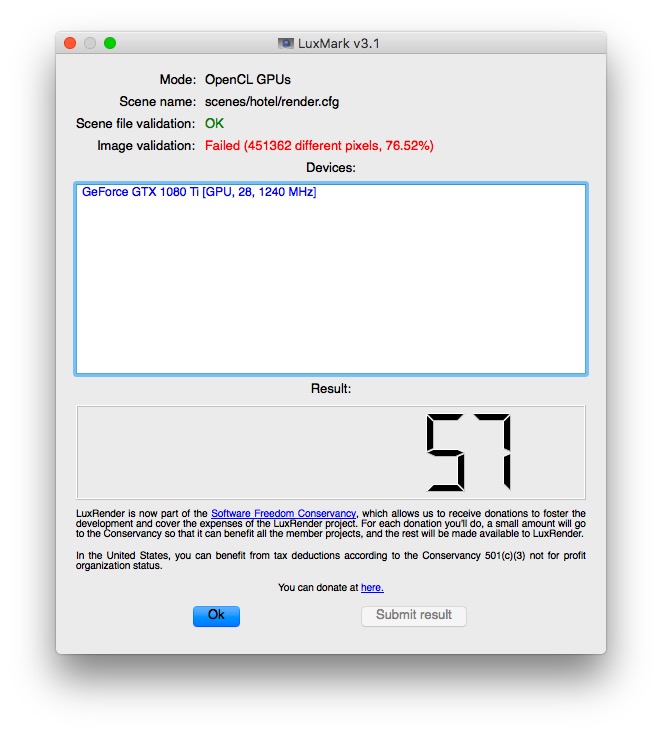

All benchmarks finished without crash. However, for Luxmark 3 Hotel scenes. If leave -cl-fast-relaxed-math ON, the result will become extremely poor. And image validation fail.
For METAL support, System Report shows the following
And OpenGL Extension Viewer shows in different format.

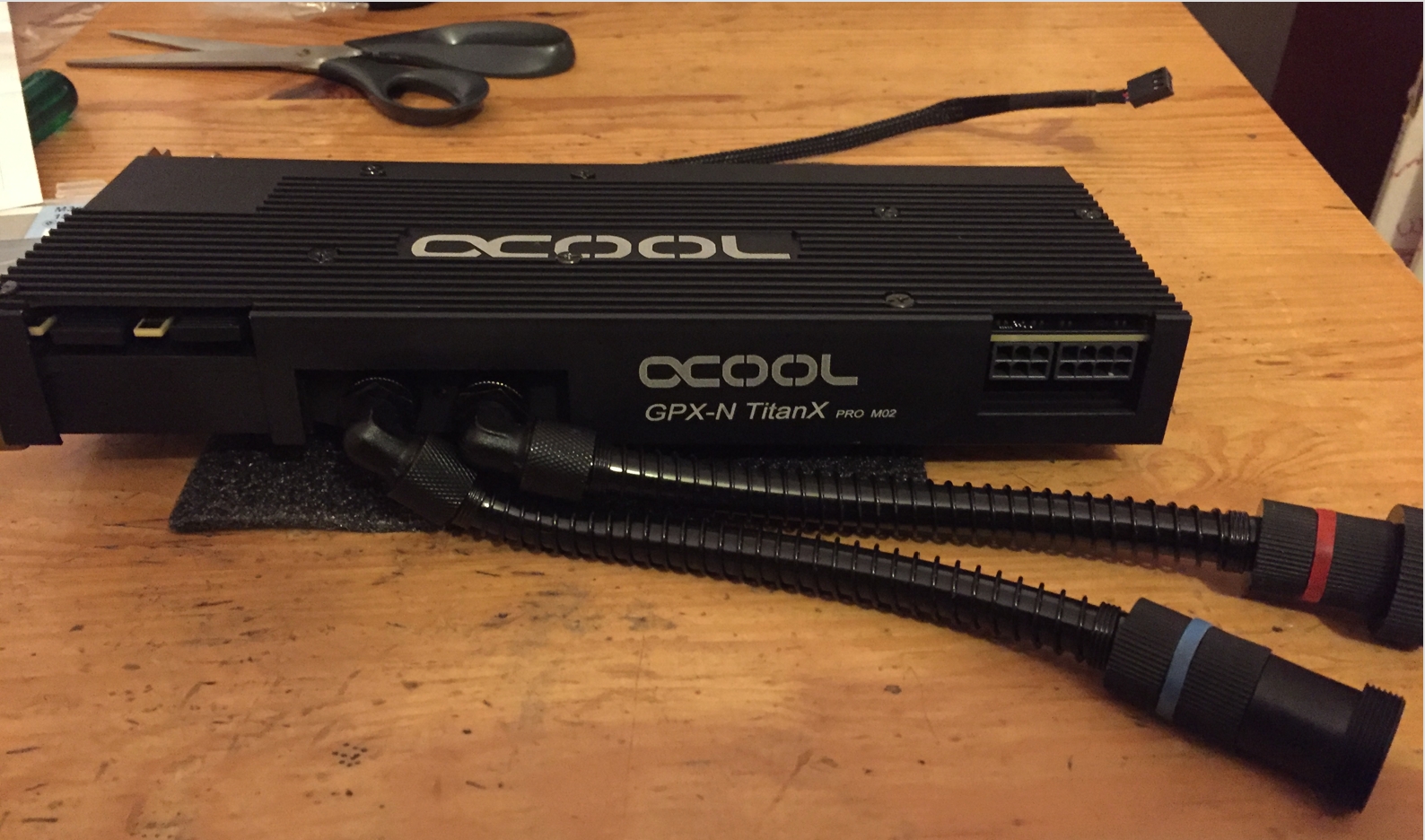

I modified my Asus GTX 1080 Ti FE with a water cooling solution.
In Windows I can increase the power to 300 Watt (+20%), giving about 20% more performance, beating Titan Xp with no problem. Even in macOS without OC the card is noticeable faster.
With the normal Founders edition cooler the card reaches within a minute 84°C under load and throttles down (no OC):

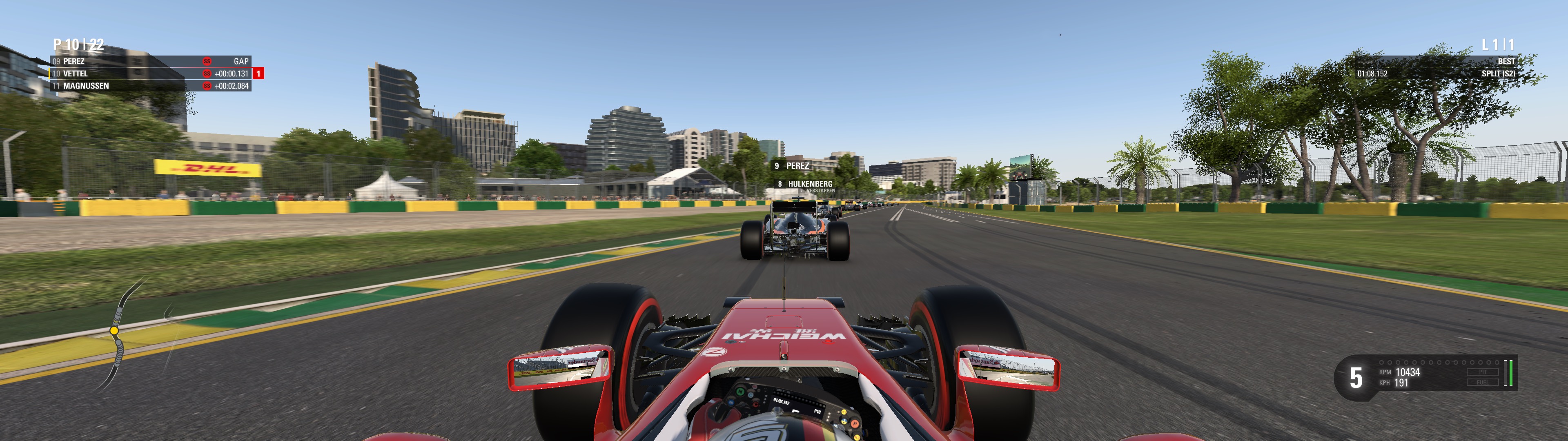

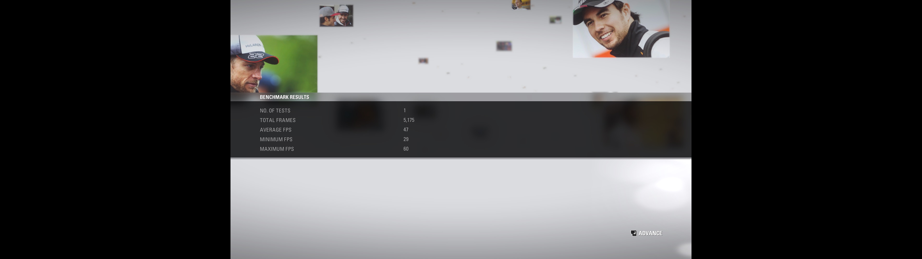

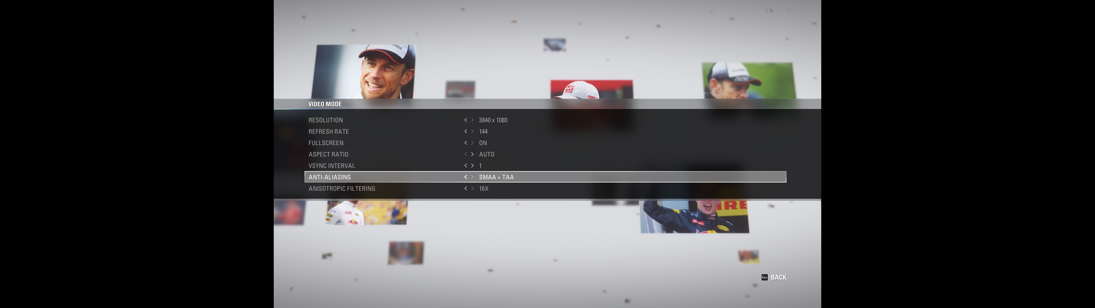

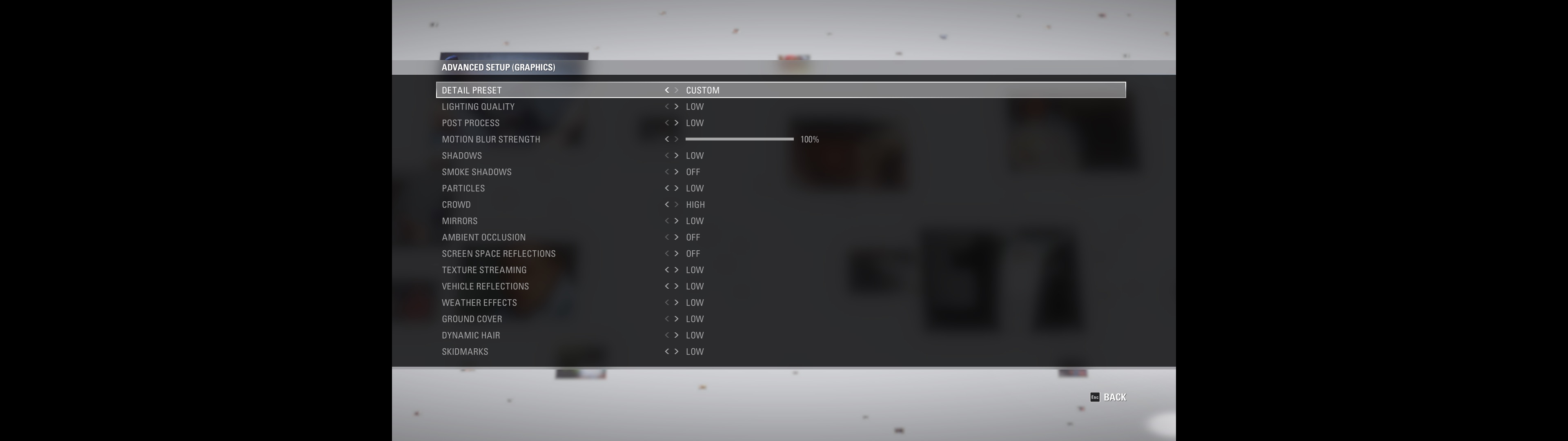

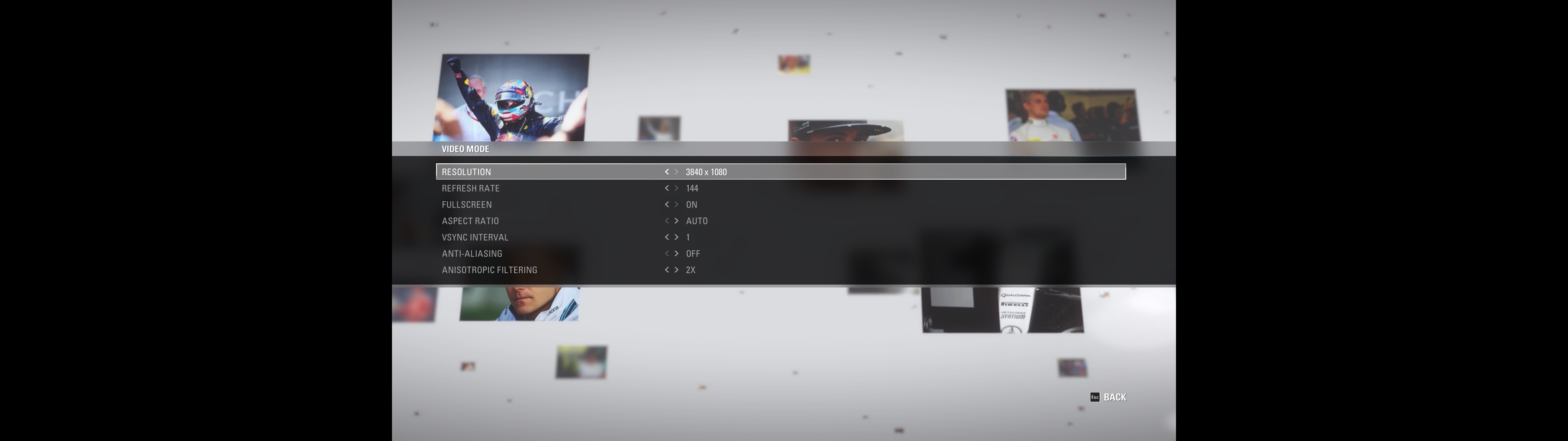

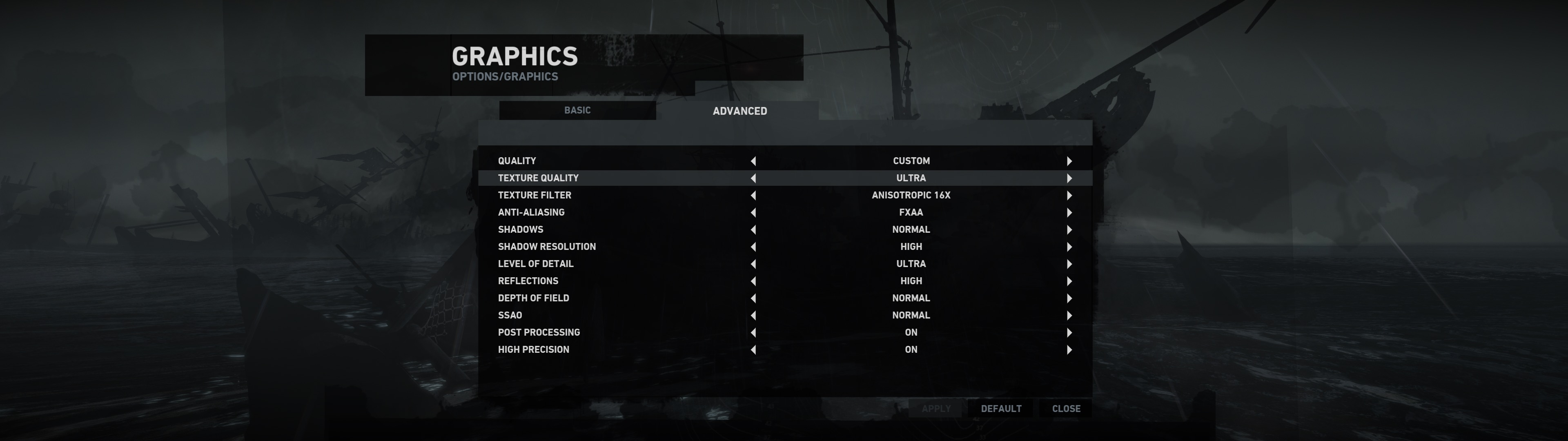

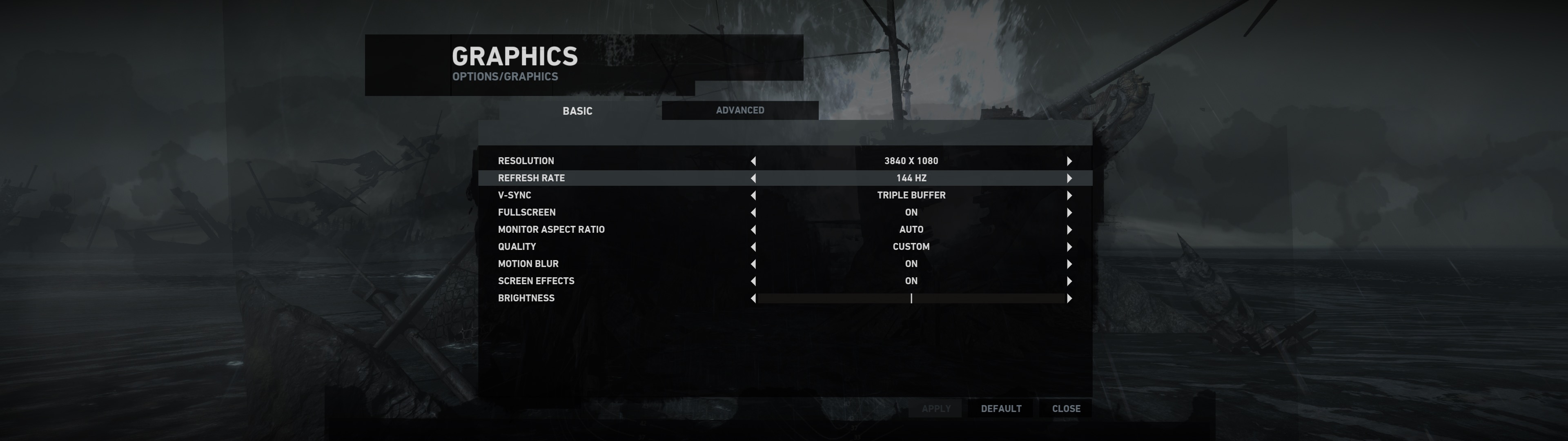

No crash, but sure not performing well if compare to Windows.
The game's auto (recommended) setting.
In games graphics (not too bad actually)
Benchmark result (not perfectly smooth, but absolutely playable, 60FPS max regardless settings)

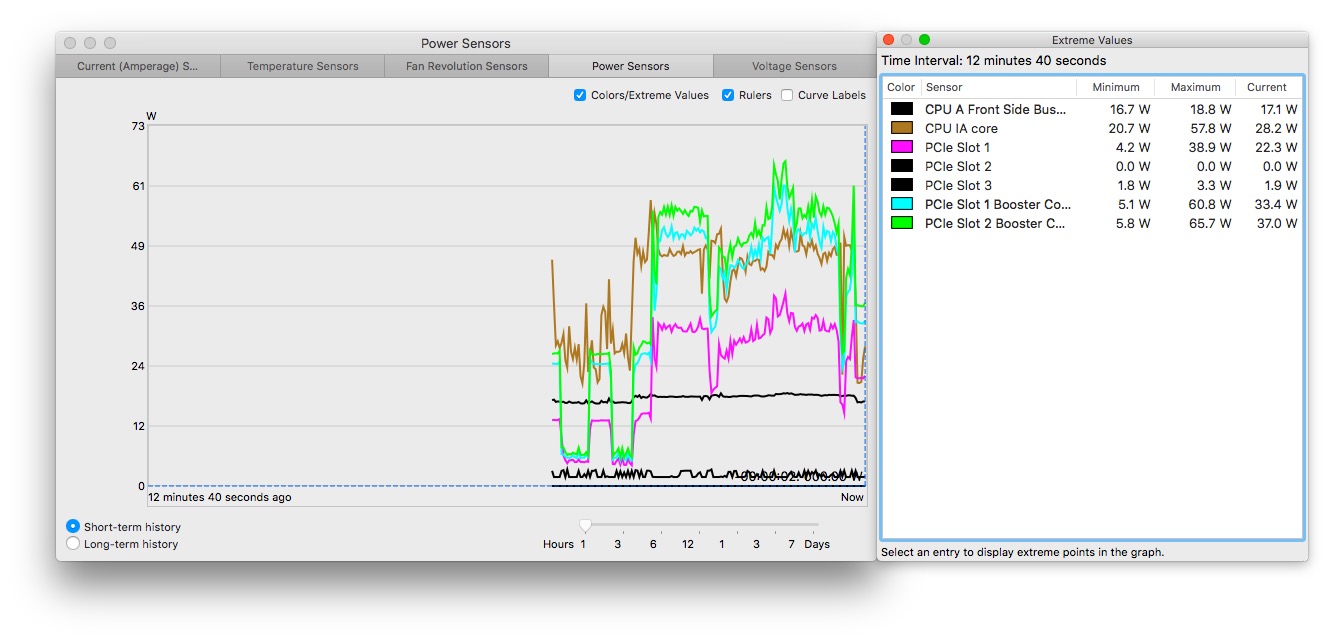

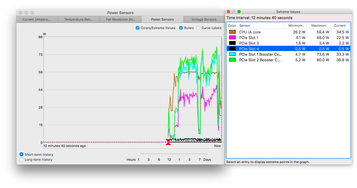

Game power draw (roughly the same power draw for any setting)

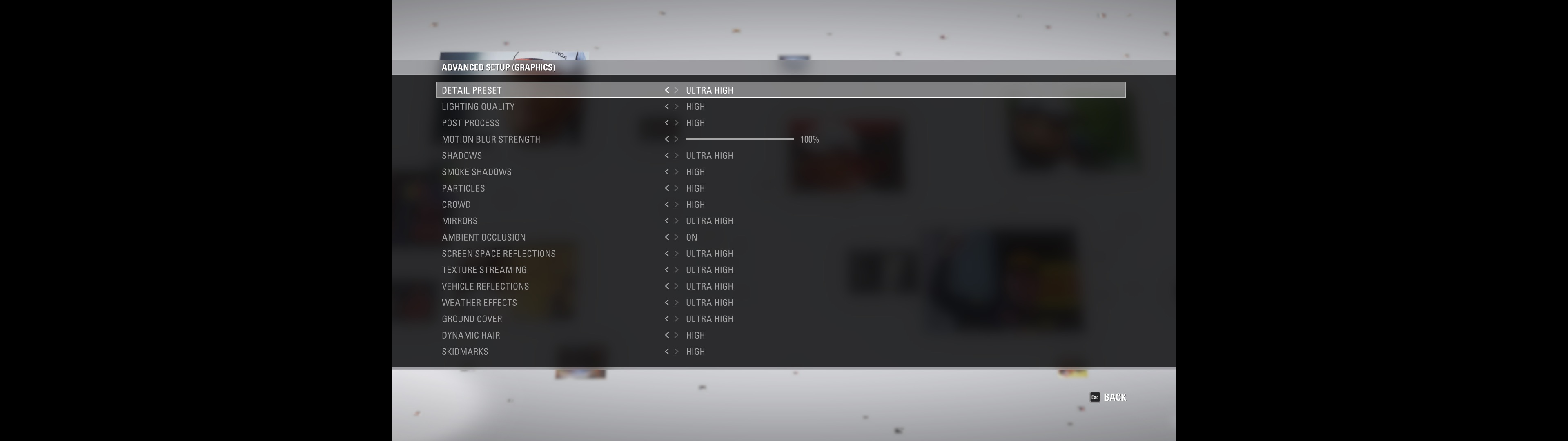

It actually OK to run at max setting
in Game graphic

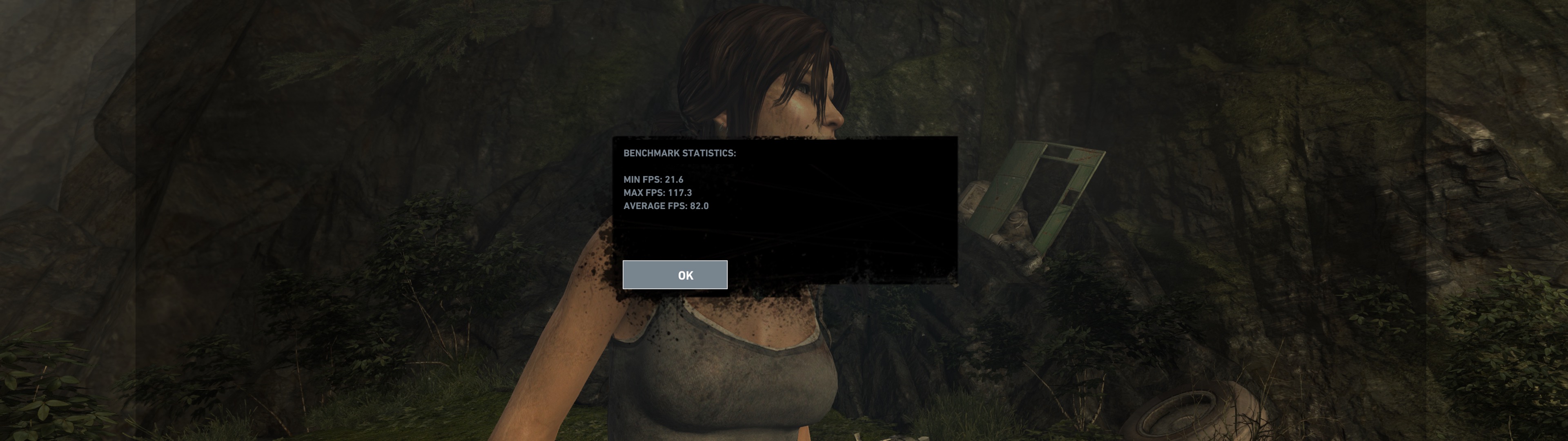

Benchmark result (it's just playable, not good)
