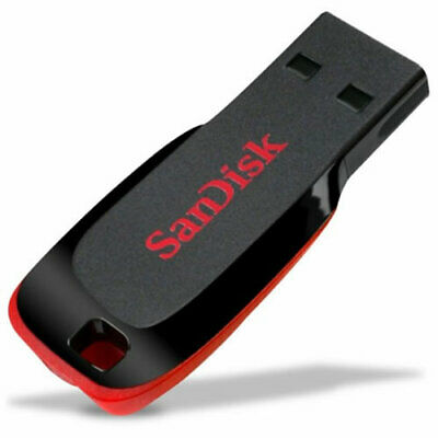

Transmac does not work alas. If you have no other Mac to make a bootable thumb drive using DiskmakerX, suggest looking at eBay for an El Capitan installer on a thumb drtive.
