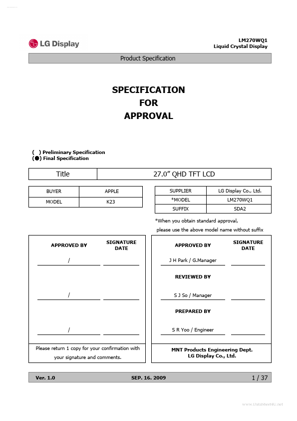

There is a post that affirms that iMac 2009, 2010 use eDP protocol in the link below. Perhaps you can crosscheck with the poster about it.
There is also a Technical Datasheet issued by LG as well. On page 6, it clearly stated that "It has been designed to apply the 8Bit 4Lane Display port interface." Perhaps you can crosscheck with LG about their LCD panels.
You have studied this topic far more than me. I just see the connector on the board. This confused me before as I remember clearly that i.e. A1312 2009 states in system information that the protocol used for monitor communication is eDP and the connector on the motherboard is clearly LVDS.
