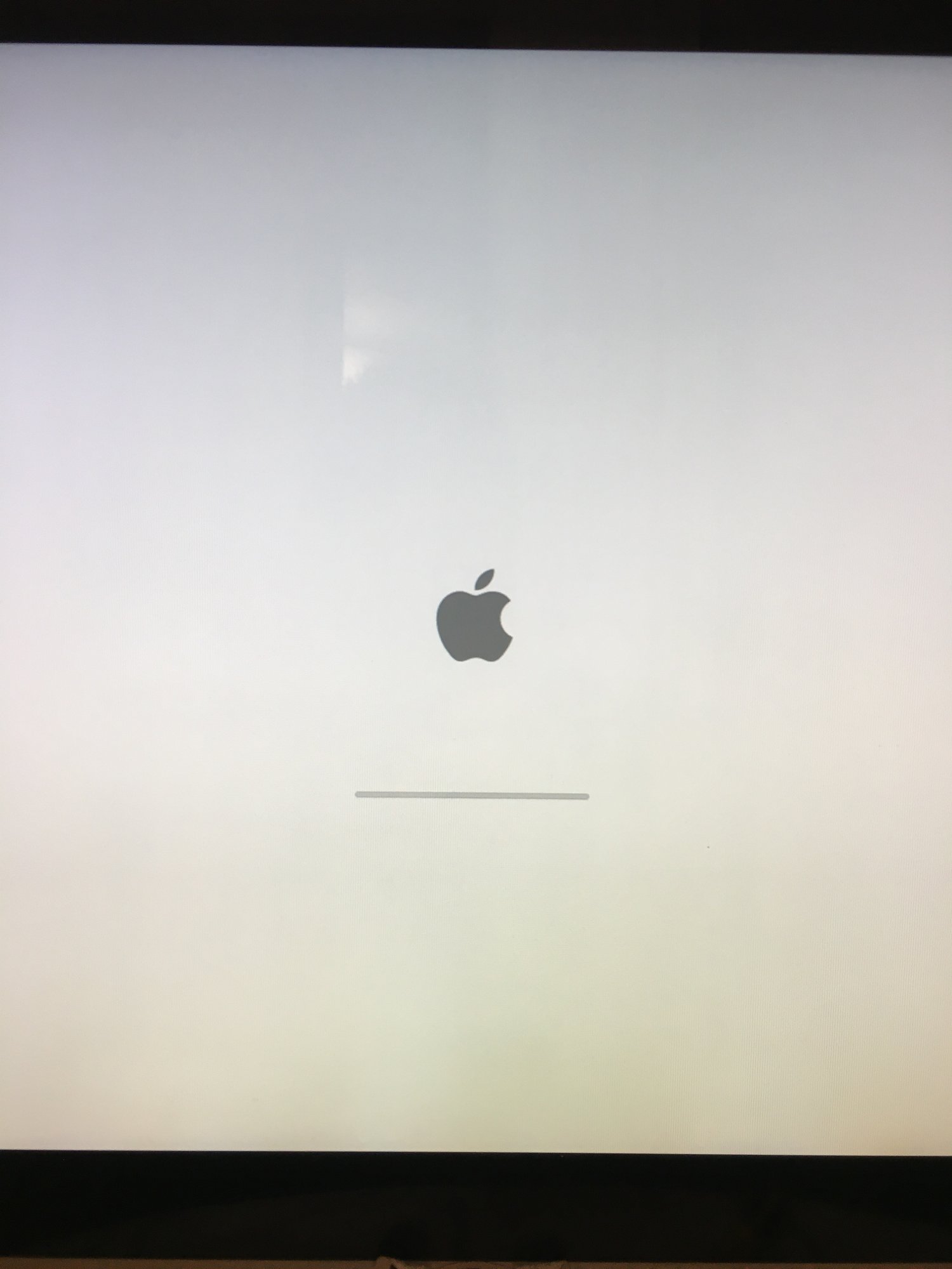

Unfortunately, the X5270 did not work for me. The mac started up and chimed, the Apple logo appeared, but the progress bar did not, well, progress. See pic.

I attempted to boot into safe mode, reset NVRAM/PRAM; SMC, and disk utility was not accessible. The only moment of hope I had was when connecting the old Macintosh HDD externally, the option to choose boot drive came up. However, every drive selection resulted in the same screen. It was worth a try, but it appears that the E8600 is the ceiling in this case.

did you inject the appropriate microcodes into the firmware? without it it might not boot properly espically being an E0 stepping CPU they have some anomalies that need Microcode to fix, infact im suprised it even POSTed without microcode!
you can use @dosdude1's tools to dump the BootROM and inject microcode into it from here :) http://dosdude1.com/apps/
