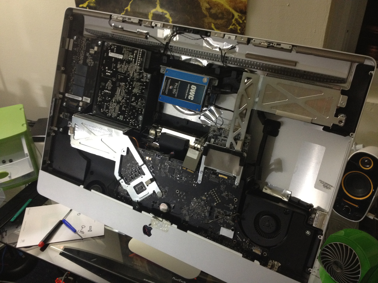

i just took my 3.5 drive out and made custom bracket from apples factory one for the owc ssd 6g hard drive.. i had a problem with the fan ramping up so i look all around and i found that company call hdd fan control had the fix so i bought it.. it does the job.. i just wish i new how one day..now I'm going to make a new bracket to but two ssd in the 3.5 slot..
http://www.hddfancontrol.com ...tachment.php?attachmentid=329484&d=1331698929https://forums.macrumors.com/attachment.php?attachmentid=329483&d=1331698929

I know this is a little late. I installed an ssd in my 2011 21.5 imac. It fits perfectly under the odd. There is also an extra sata connector on the logic board. I did not purchase the ssd power cable that would connect to the logic board. I just used an sata power splitter and powered it off the harddrive cable. You can purchase the power adapter and ssd mounting adapter from applecomponents.com or just tape it in like I did.
Just take your time removing the logic board to install the sata cable and you will be fine.
No need to short any temp sensors. Just leave the stock harddrive in place and you will have no issues.
