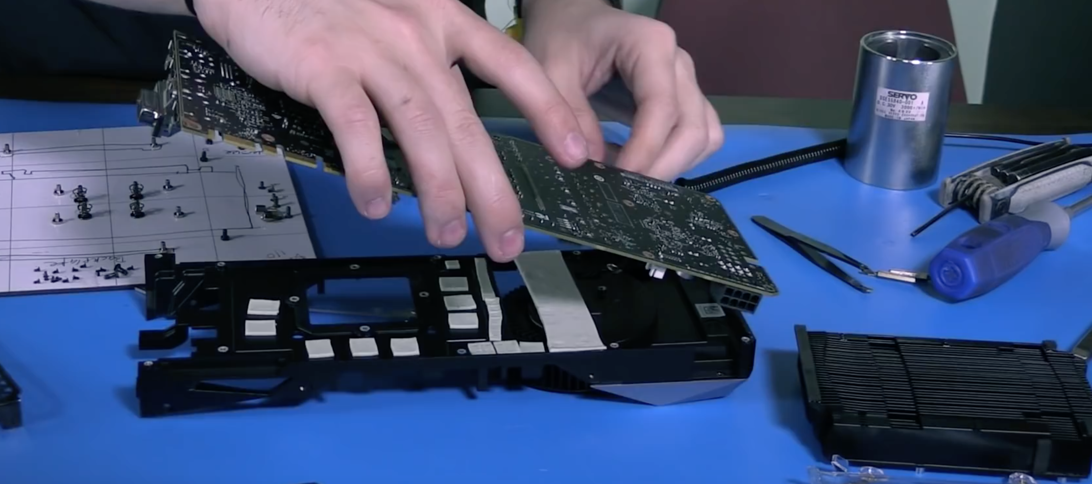

I wouldn't replace thermal paste with pads though.
First, they aren't as efficient as paste/grease. Second, you can create a gap over other components if your not careful depending on the heat sink design. You can't "smash" a pad as flat as paste can be and if the VRMs are close enough to the GPU there is the possibility the additional height will prevent a side/corner of the heat sink from being as flat as it could be on the GPU. The opposite applies too, if you replace a pad with paste the heat sink may not have been designed to close that gap as tightly as needed for the use of paste.
On graphics cards you'll often see thermal pads used on the memory/VRM but as a secondary means of cooling. For example on the 1080ti they use thermal pads between the front and black plates but not touching to the heat sink itself.
I don't know the layout of your iMac so it could be a moot point. However I don't see a need to reinvent the wheel here. If they used paste you should, if they used pads you should.
