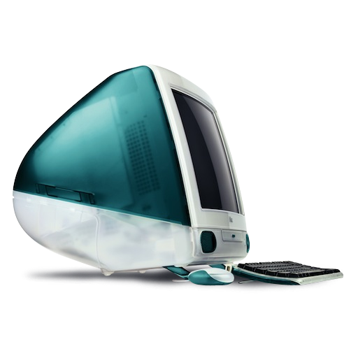

i got stressed today as i can not get this thing to boot properly and no one on tonymacx86 is getting back to me so i destressed and made the picture for "about this mac" i used the higher resolution version of the one below;
i have attached it incase anyone is good at photoshop as i need the white boarder removed :-(
theres a better one, i tried it out on the iMac 27" and it looked great apart from the white background, this is my second attempt, don't know if anyone can make that better?
