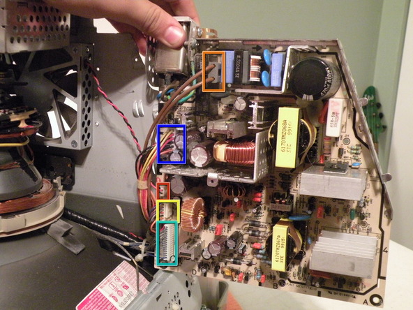

Also, because the power usage is now going to be over the rated power of the iMac G3's PSU, i have been looking at purchasing this;
http://www.ebay.co.uk/itm/320799672077?ssPageName=STRK:MEWAX:IT&_trksid=p3984.m1423.l2649
my issue will be hooking that up to the CRT, but again i will work that out in due course. My worry is that if i hook up the 200 and leave the old psu in there, it uses significantly more wattage. best case would be to remove the old PSU and hook up the CRT, but the CRTs connection to the original PSU has many connections. but surely they cant be power as they are extremely thin! On this picture supplied by iFixit (green cable)
