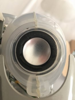

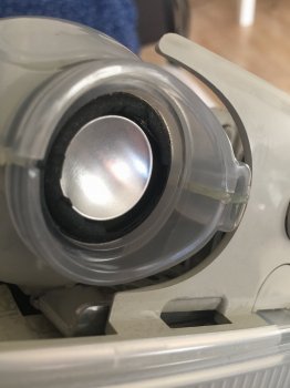

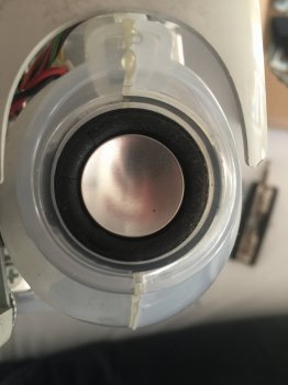

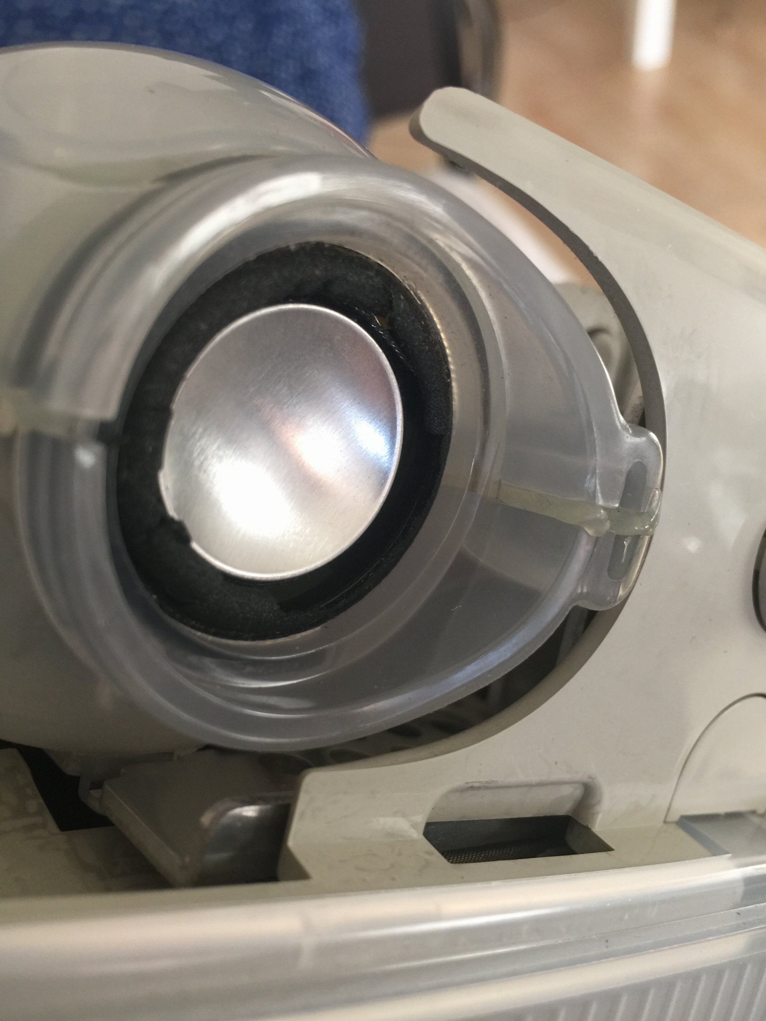

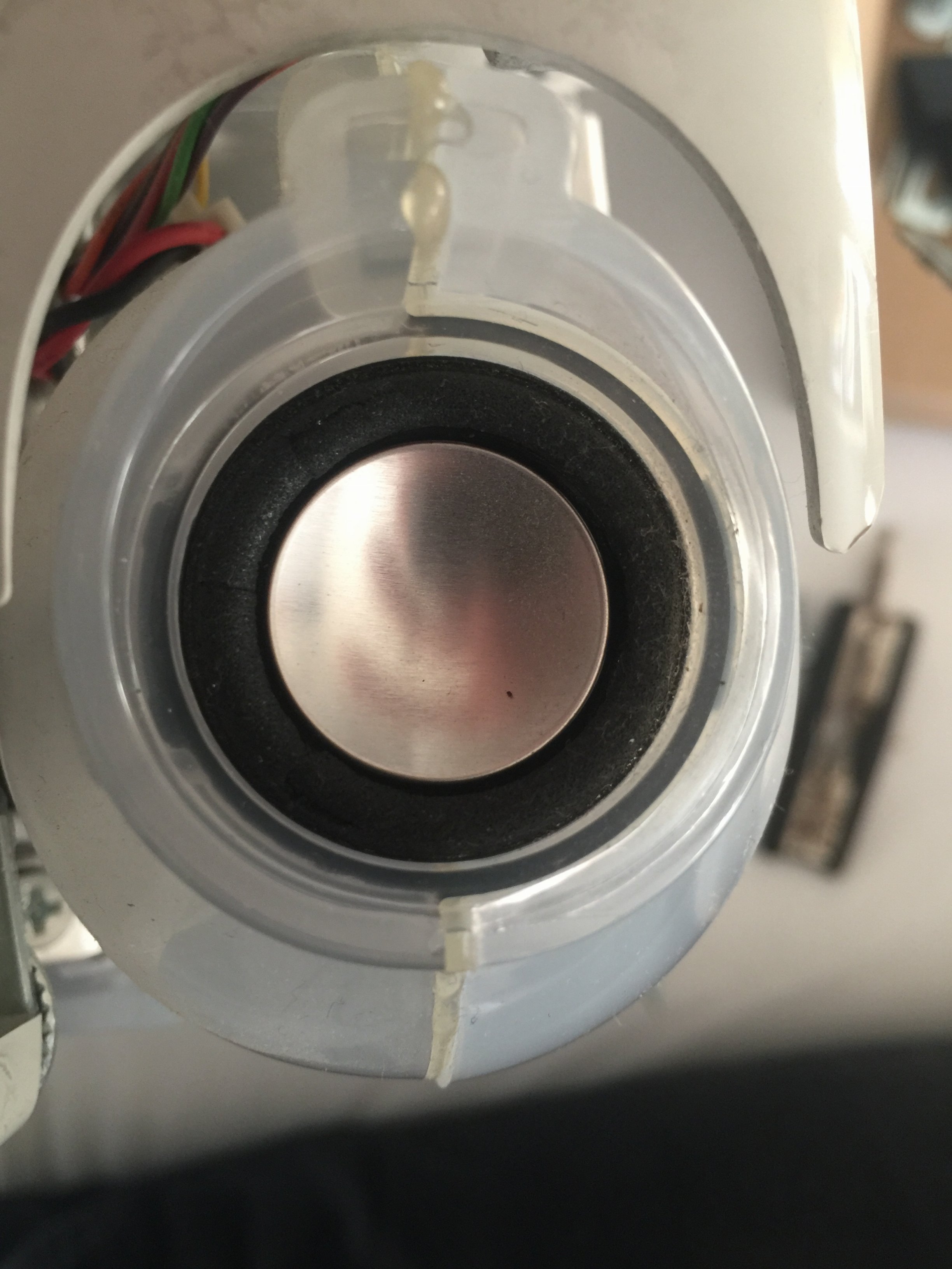

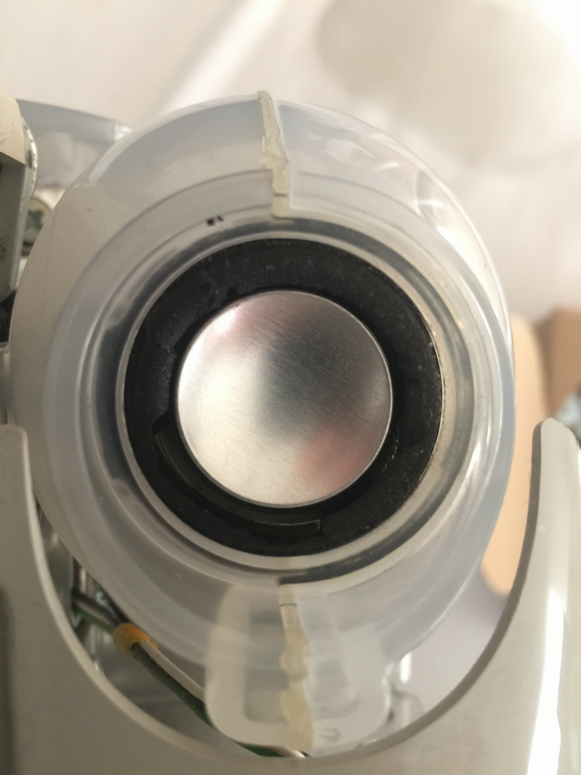

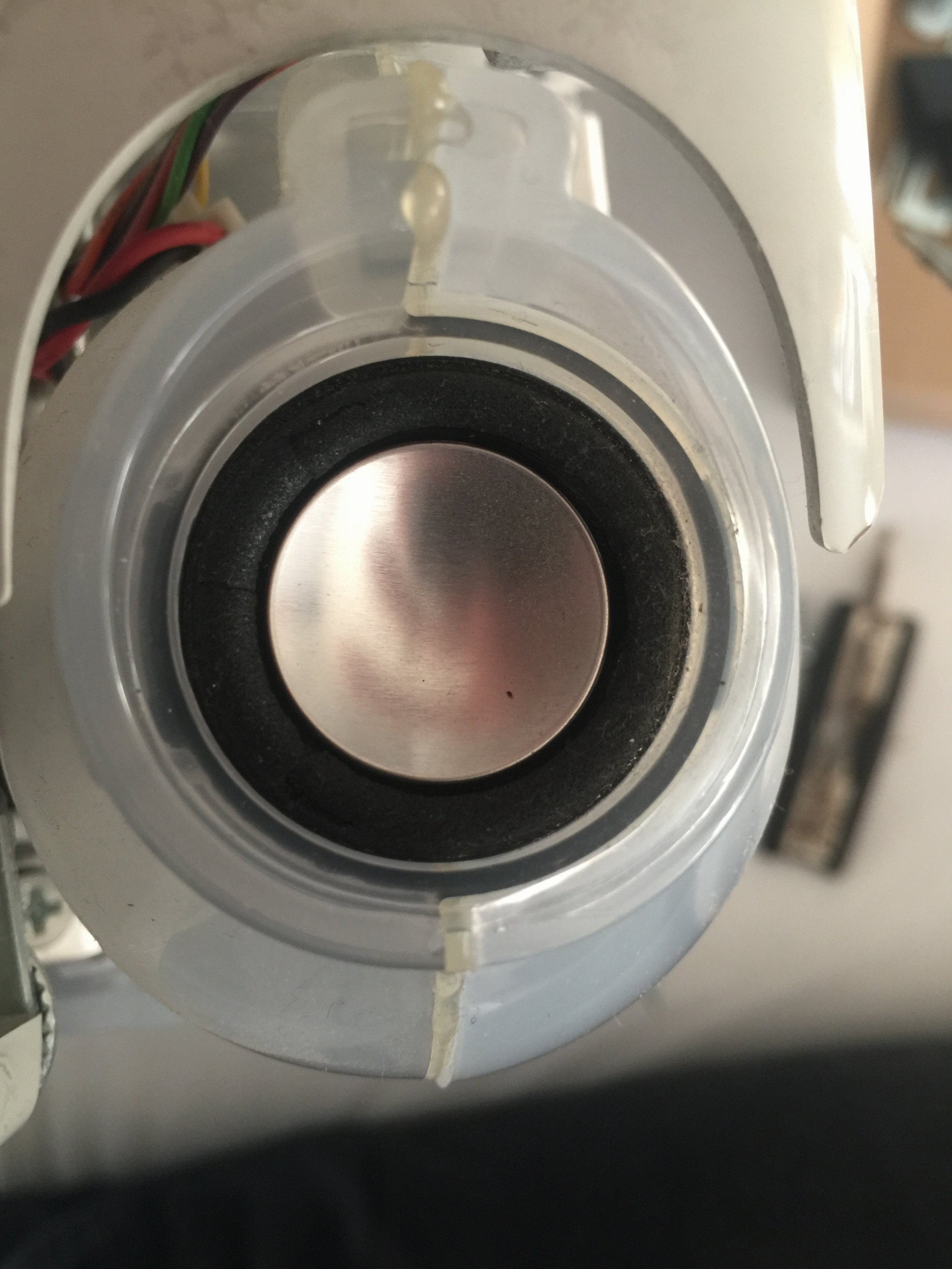

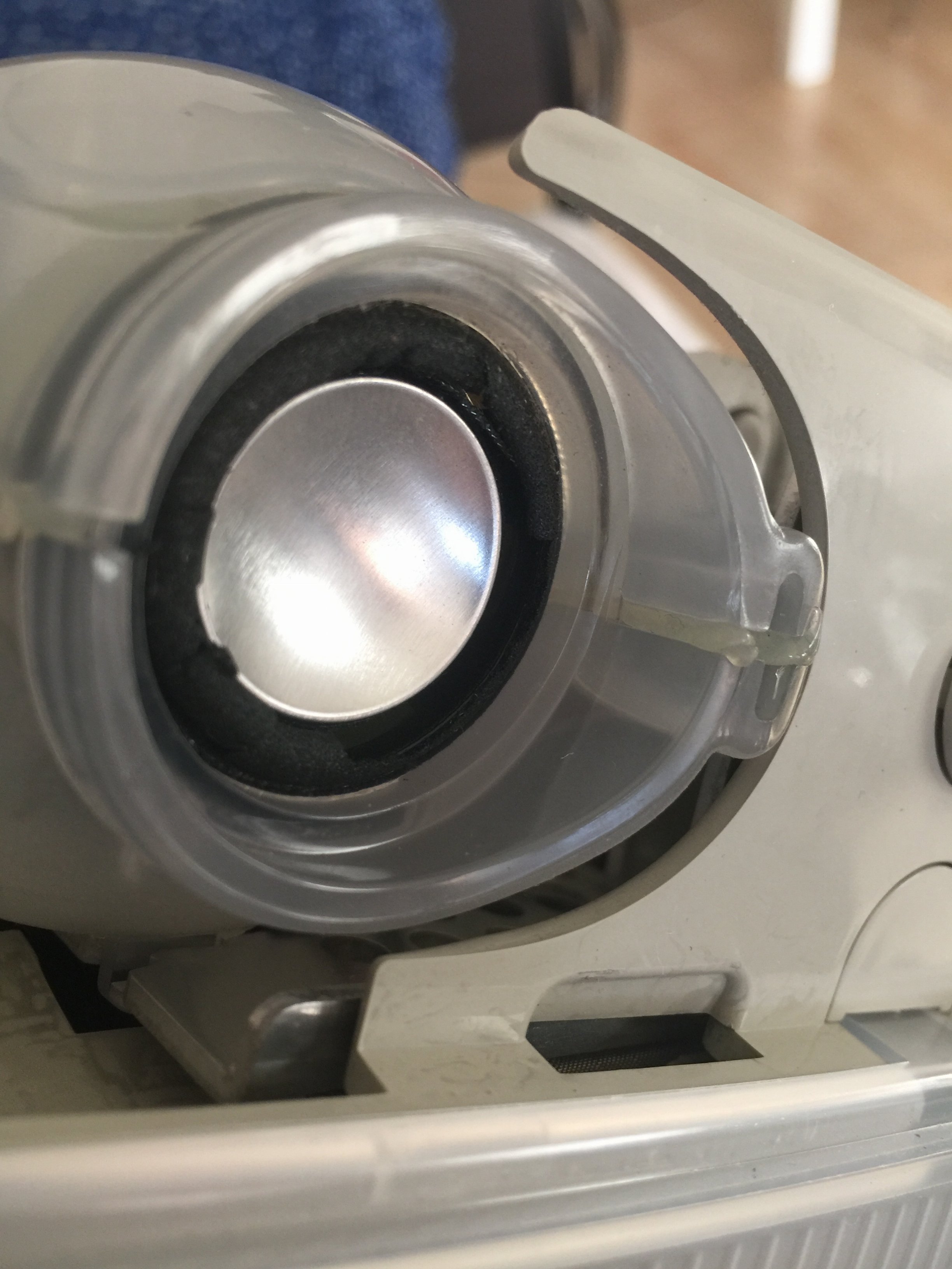

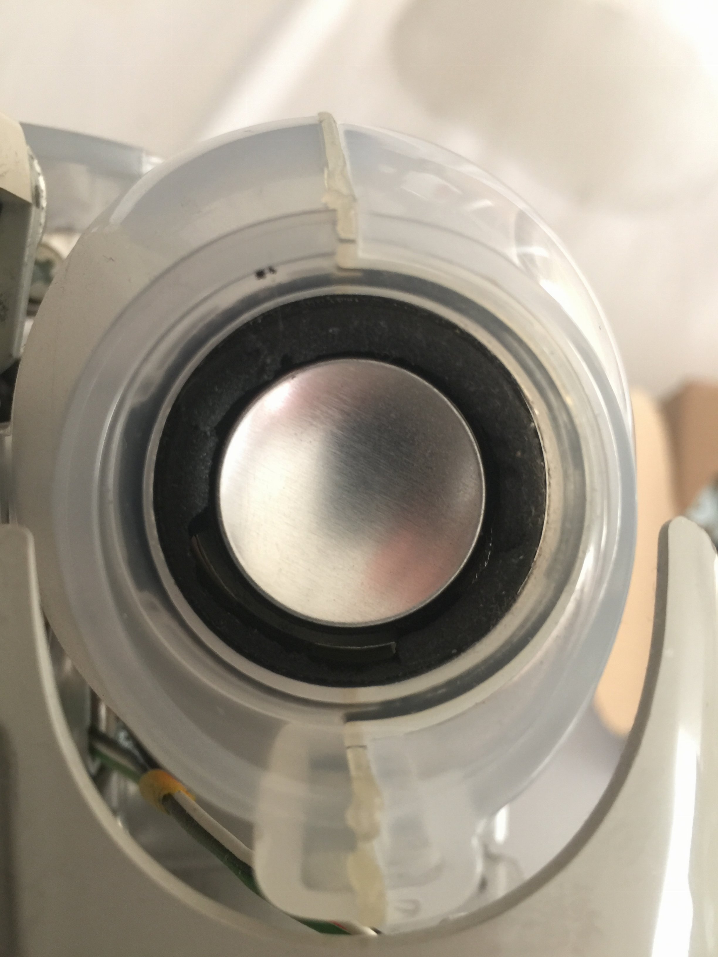

Than after 2 weeks suddenly the right speaker started sounding weird, sound was coming out of it, but it was distorted. Not long after that, maybe an hour later the left one also did that. So I did some searches on the internet, and I could well be that the iMac got what was a known problem to the G3 "speaker foam rot". I took the bottom off to confirm, the pictures speak for themselves:
Left speaker
Right speaker
Right speaker
It is foam rot, so now I got 3 options, I think.
