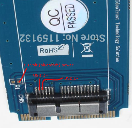

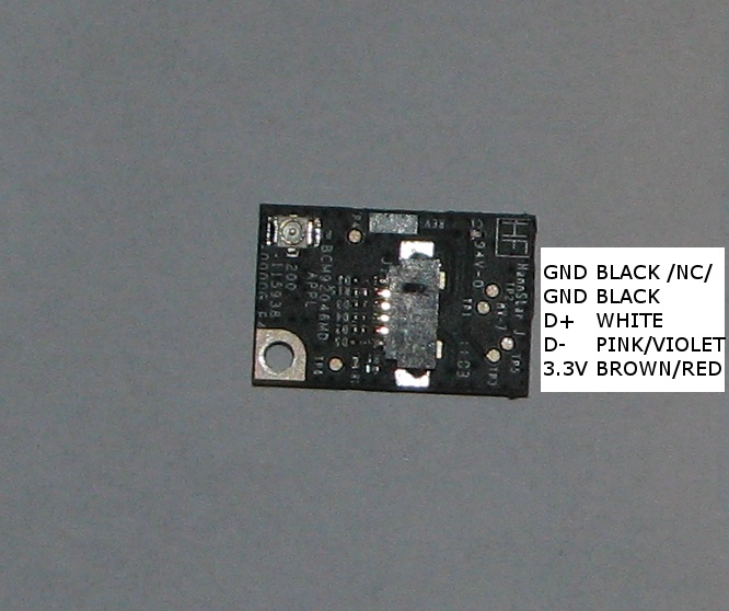

From the left;
the 1st pin is the 3.3v (bluetooth) power
the 2nd pin is the USB D+
the 3rd pin is the USB D-
For this setups, your Wifi/Bluetooth will works normally. Turning off your Wifi will not effect your Bluetooth power.
Thank you so much! It really helps as an OS X adapter board is way too expensive.
mhafeez, if I am wrong and have misunderstood, please let me know.

Yes that is correct!
Thank you very much! I really appreciate it. One last question, did you had to cut a trace for power. Because we are bringing power from the original bluetooth cable to the card. Without that power, BT gets it from WiFi.
Yes. I soldered the 3.3v and D+/- from the original bluetooth cable to the adapter.

I think the only question that was left open, was the location of the 3.3V cable. ->

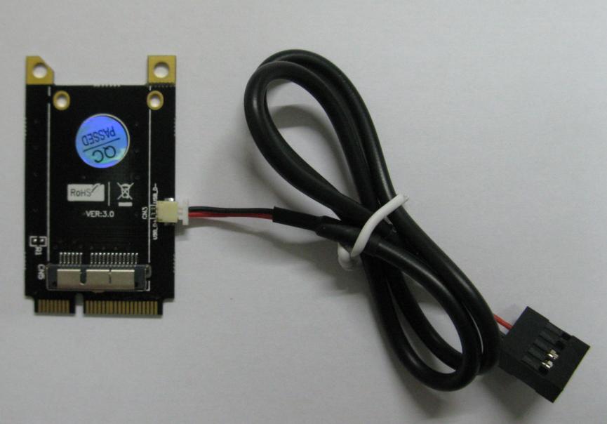

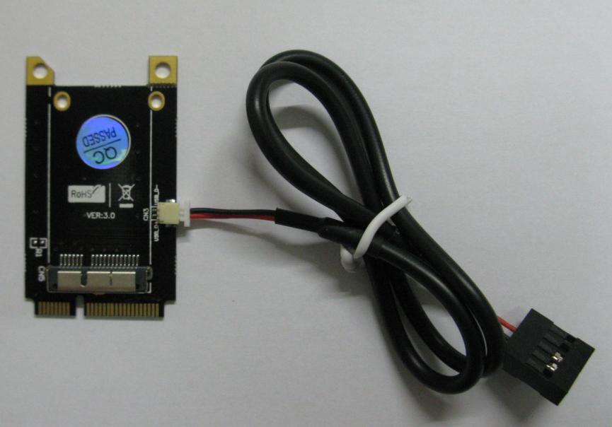

What does that USB cable even connect to? Doesn't look like it fits the adapter. Is the other side for a motherboard header? Wish they had a better picture.

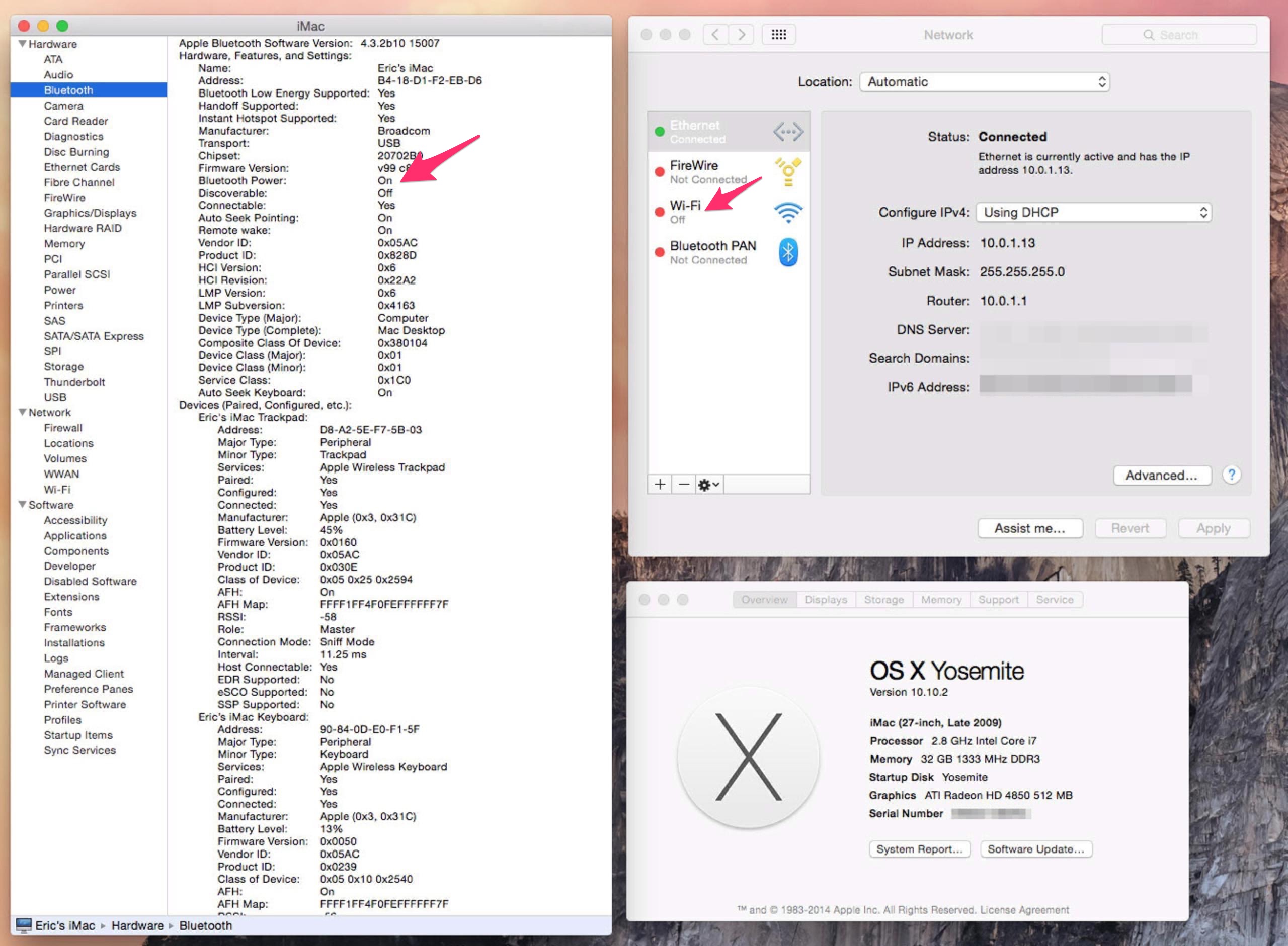

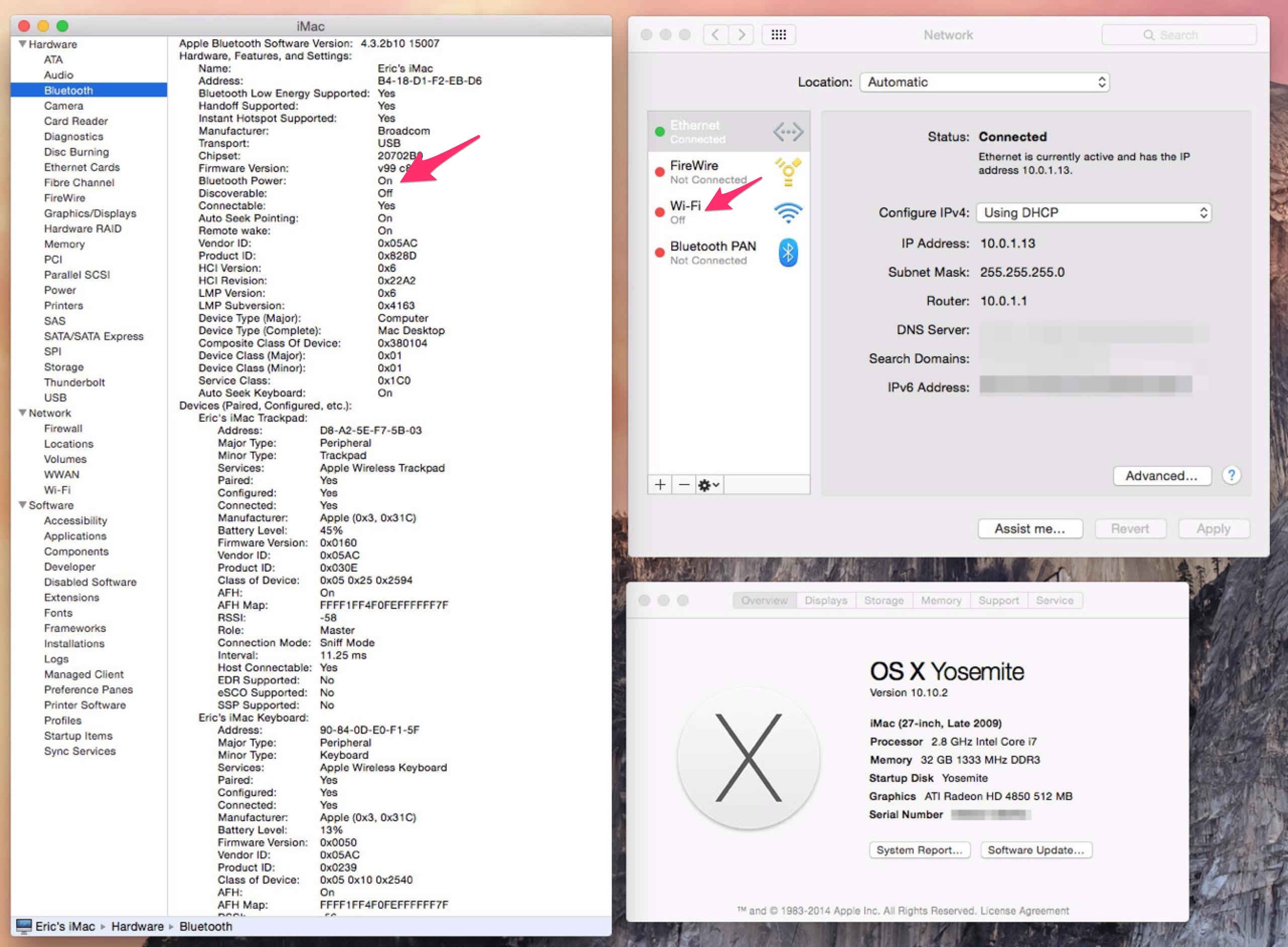

Success for Late 2009 iMac!
To update from this post. The antenna extension arrived, and it connected to the stock antenna and the wifi card (top far left connection) perfectly.
With that antenna extension being the missing part, my bluetooth 4.0 works perfectly. Also all the Yosemite features work, but only after I ran the Dokterdok Continuity Tool. I have 10.10.2 beta and it still worked perfectly.
I just need to find a easy and reversible way to get the D+/- connected to the adapter. I really don't want to solder anything. The Late 2009 iMac does not need the 3.3v power connected to the adapter card. Just the D+/-. That little fact may have been mentioned earlier in the thread.
ECJ - Then the only thing you wouldn't be able to do is to independently control power to WiFi or Bluetooth? i.e. if you go to the Menu Bar and click on "Turn WiFi Off" then you'd lose Bluetooth too?
The bluetooth still works with the wifi off. I have the wifi off on the iMac since I have it connected via ethernet. With the wifi off, I still have no problem using my bluetooth connected keyboard and trackpad.
I was expecting it to shut off when I turned the wifi off, but that didn't happen.

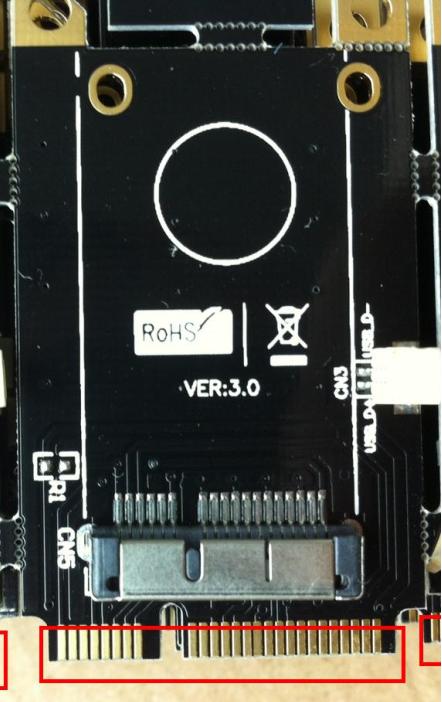

I got a reply from a company from Shenzhen, China in my search for easier upgrade option. Here is the photo of he sent me for the adaptor for Mini PCI-E Adapter. He said it come with two wires, one for soldering and one for usb 2*5 connection. Will this work better or easier to do? I am a bit scared to solder some wire on a tiny metal lines so closed to each other especially saw Cordes busted one on the first try.
This looks like essentially the same adapter that I used, only with this new version, the D+ and D- have been brought out to a connector, which makes it easier to use for a 2011 iMac. If you use this, you won't have to solder those connections. You could cut off your old bluetooth connector (scary, I know) to get access to D+ and D-. You could cut off the connector that comes with this new adapter and splice it to the D+ and D- wires that went to your old bluetooth connector. If you did nothing else, I think the only shortcoming would be that if you turned off wifi, you'd lose power to this card and also be turning off your bluetooth (and thus disabling your wireless keyboard and mouse). You may want to go this route and plan on never turning off your wifi, and be prepared with a standard usb mouse and keyboard if needed, so you can turn wifi back on and therefore bluetooth.
Or, you could also splice a wire to the +3.3v of the original bluetooth feed and solder it onto this adapter at the "R1". You can see pics posted by Vic Otting in this thread that illustrate where to solder to. The good thing about this connection is that it's a little bigger of a soldering target as it's a square. It was much easier for me to solder here than it was the D+ and D-.
For me, with soldering the D+ and D- on the adapter (when I was successful), I had to use finer gauge wire, a fine tip soldering iron, and a magnifying glass to work under. I also taped the wires in place so they didn't move much while working on them. You probably don't want too high of wattage with your soldering iron so you don't melt/damage things unintended!
Good luck!
