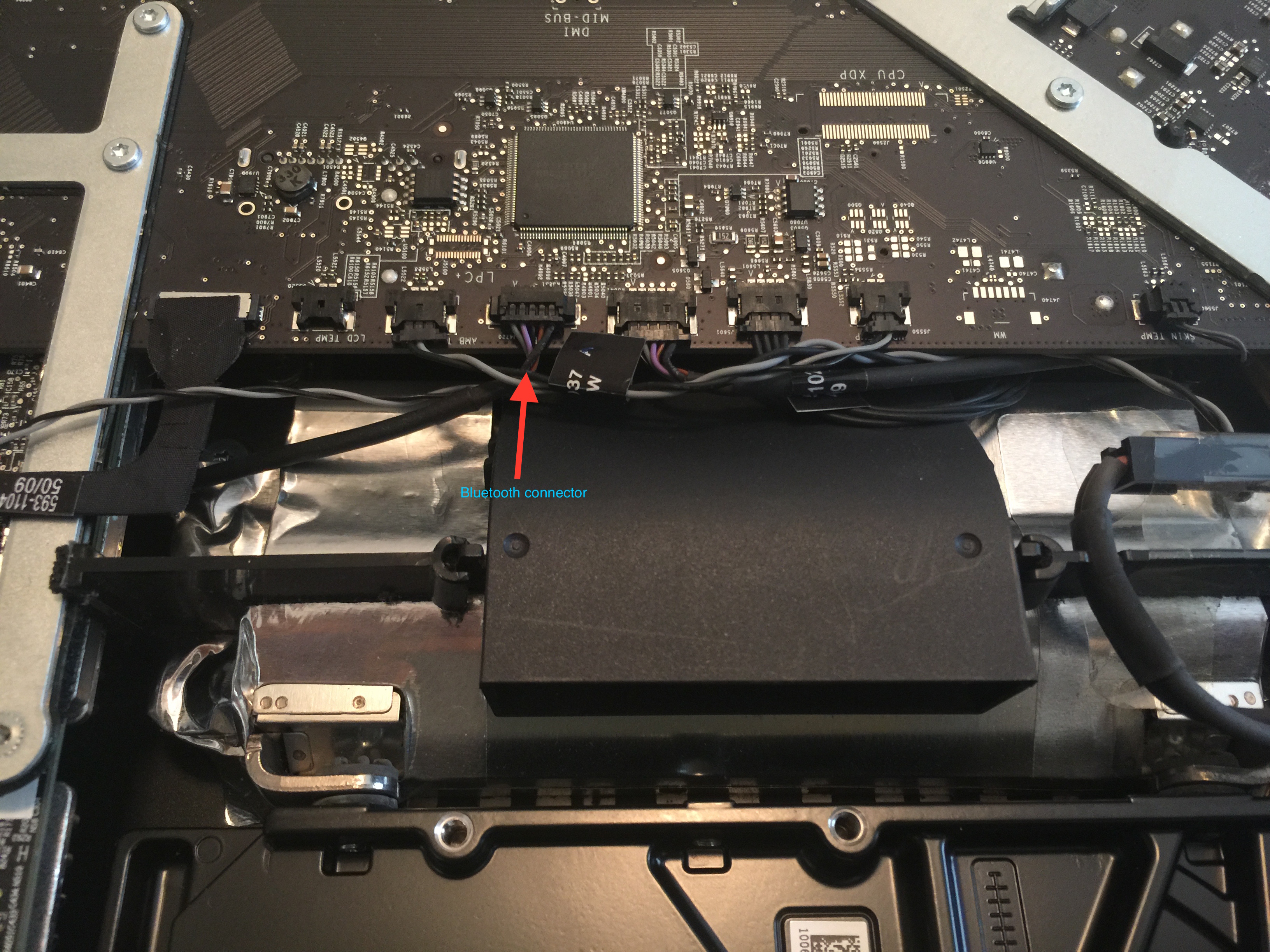

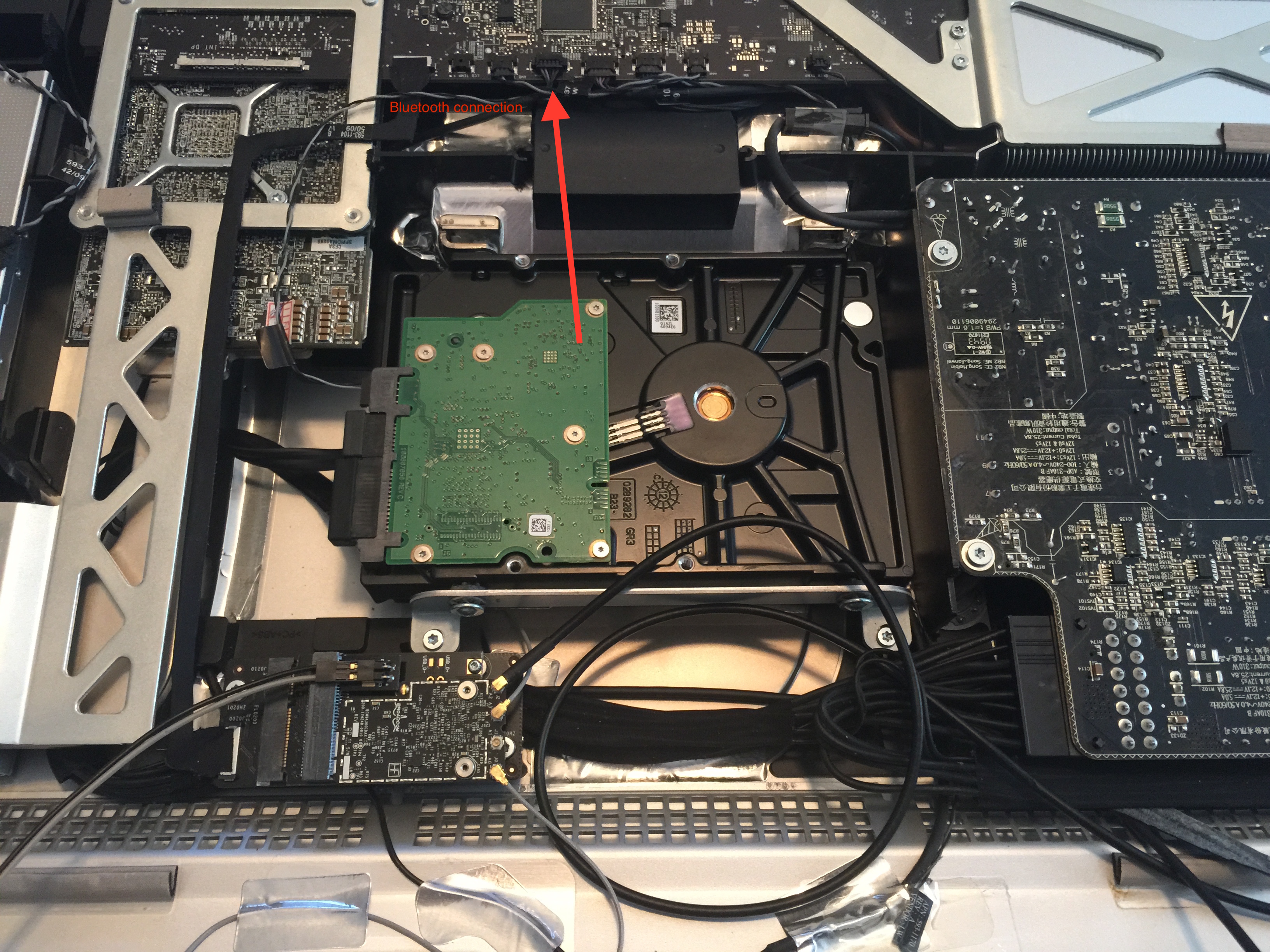

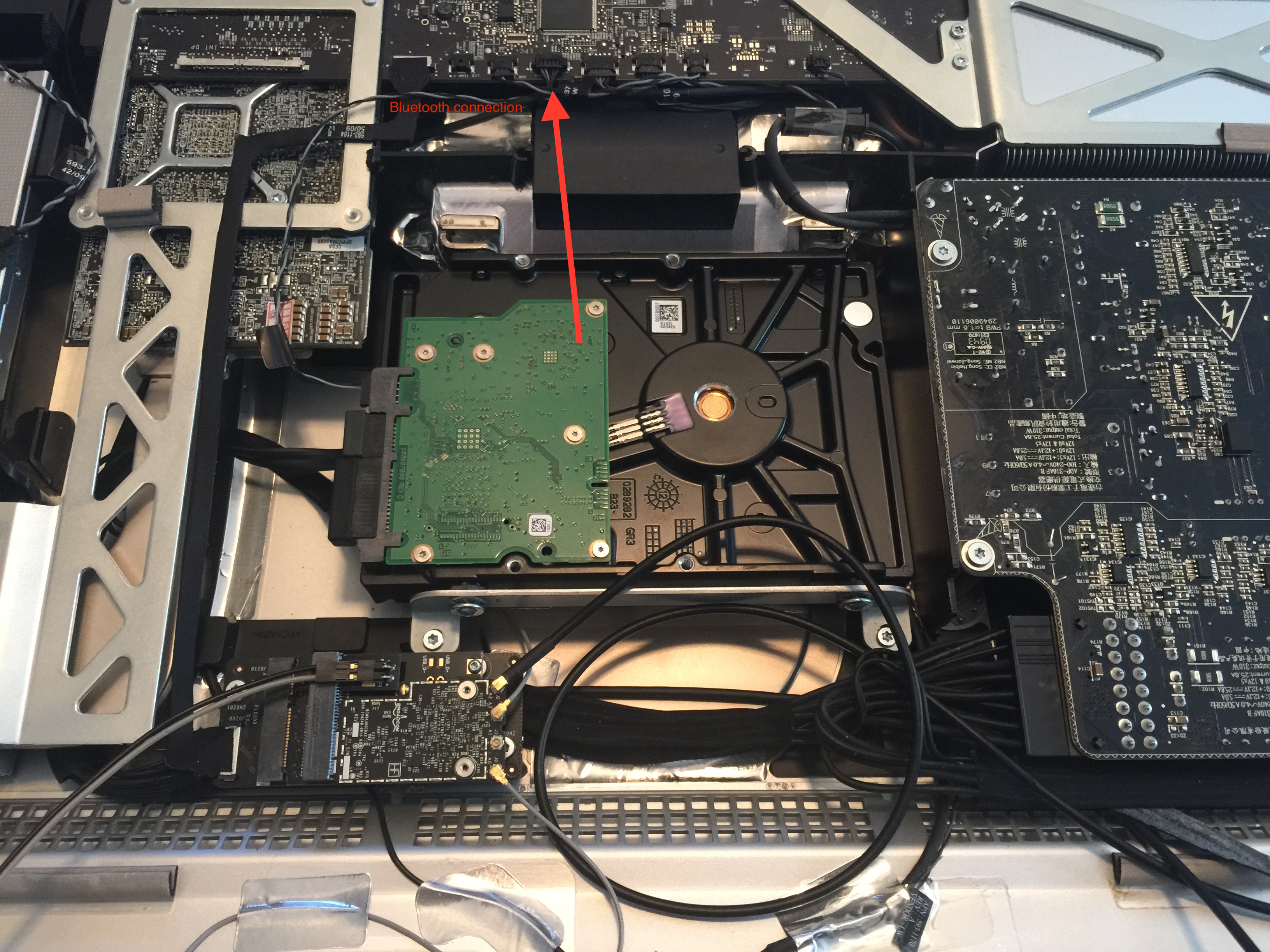

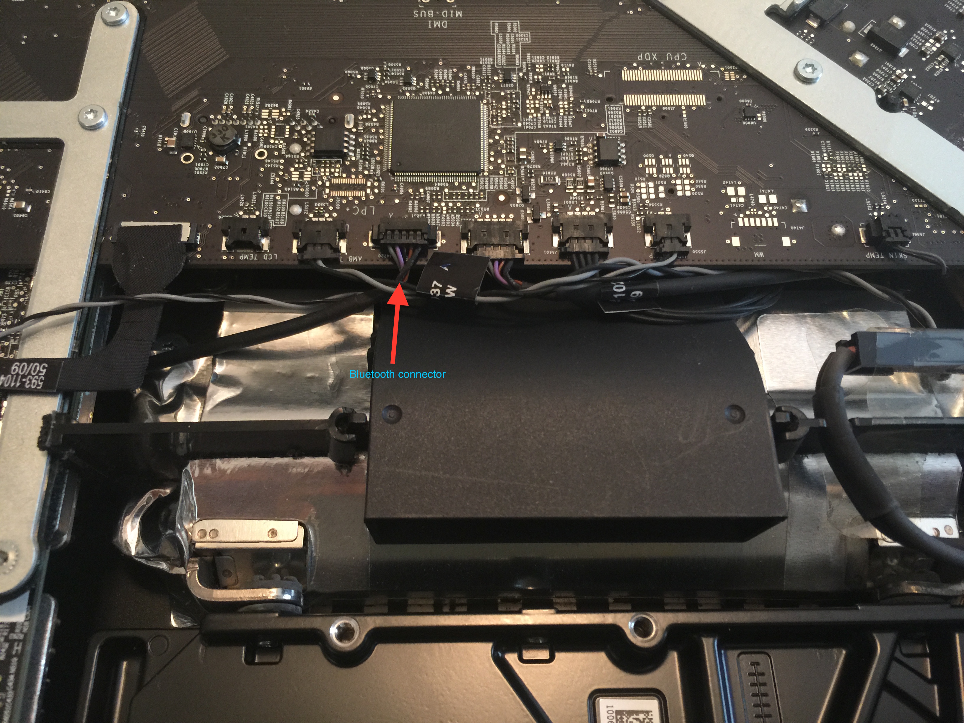

The bluetooth connector is very easy to access to once you open the case. I'm glad that I ordered the backup bluetooth cable. I messed up the first on trying to solder the cables. So I just disconnected the old one, and attached the new one, and I'm back in business. I bought it from this auction for $6.75 USD. It works for 2009-2011.

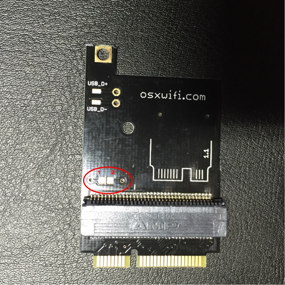

OSXWIFI-card - connection
Hello,
maybe here is someone who can help me. The guys from OSXWIFI do not react on any email.

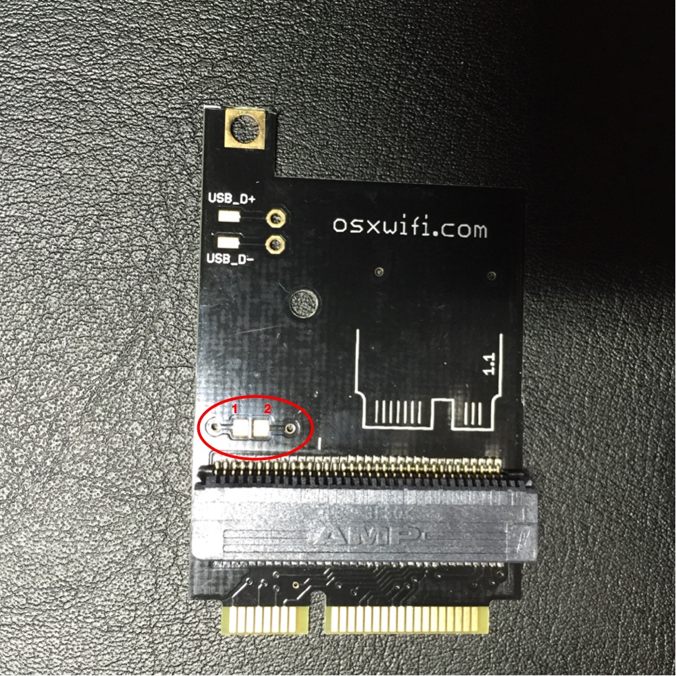

I bought a „APPLE BROADCOM BCM94360CD - 802.11 A/B/G/N/AC + BLUETOOTH 4.0 WITH ADAPTER FOR PC/HACKINTOSH LAPTOP WITH FULL SIZE MINIPCIE CARD“ from OSXWIFI.
Can someone tell me please, what are the two soldering points inside the red ellipse? These are the Power (GND & 3,3V) for the Bluetooth-USB-port? If yes, what is GND and what is 3,3V (1 & 2)?
thanks
cervicor

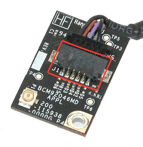

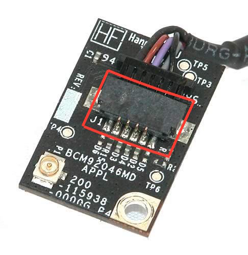

I purchased a couple of original iMac bluetooth cards from ebay for around $5.00 each to see if I could get the connector off the bluetooth card to wire up to the OSXWifi adapter. The best way I found to get the connector off was to use this ChipQuick SMD kit.
http://www.amazon.com/gp/product/B0019UZP7I/ref=oh_aui_detailpage_o06_s00?ie=UTF8&psc=1
Using this makes removal of the connector much easier. There are several Youtube views you can watch on how to use the product. It works great -- I destroyed two different connectors before getting this.
Next I found this PCB to mount the connector to.
http://www.schmartboard.com/index.asp?page=products_partnum&id=450
The pins on the connector will align up perfectly. Cut the board that has 8 pins in half and epoxy the bottom of the connector the circuit board to make sure it doesn't move. Then solder the pins to the traces.
I used a three conductor cable and soldered directly to the OSXWifi board for the USB +/ -Data and Vcc power connections. I cut the trace on the card going to pin 1 and connected a small wire directly to pin 1 as others have stated in-order to control the power to the WIFI card and bluetooth. I then wrapped the new connector assembly with heat shink tubing.

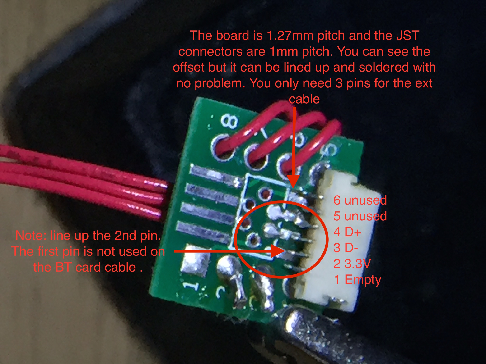

Hello
First off, thank you to everyone, all their ideas, and posts!!
I too wanted to do this upgrade in my 2011 21.5" iMac without altering (cutting) any of the wiring. Ive been trying to find the model number of the BT connector so that we can purchase the part for our upgrades.
FWIW, buying a used BCM92046MD BT board to scavenge the connector is probably the most cost effective solution. My cost for a used board on eBay was $3 shipped. As stated in scroberts72 post, QuikChip is worth the investment—makes to a quick/clean job of connector removal.
when all of my parts arrive I'll post a complete install tutorial in a new thread.
Fingers crossed.
Many thanks!
UPDATE: After some digging, I found the part for those wanting to make their own removable USB D±/3.3V cable. (photo below shows my V3.0 adapter card with the 2pin connector removed and a JST connector installed coupled with an 16" extension USB D±/3.3V cable and 21" BT antenna extension.)
JST connector
wire housing: SHLP-06V-S-B
shrouded header: SM06B-SHLS-TF
contacts: SSHL-003T-P0.2
PDF: http://www.jst-mfg.com/product/pdf/eng/eSHL.pdf

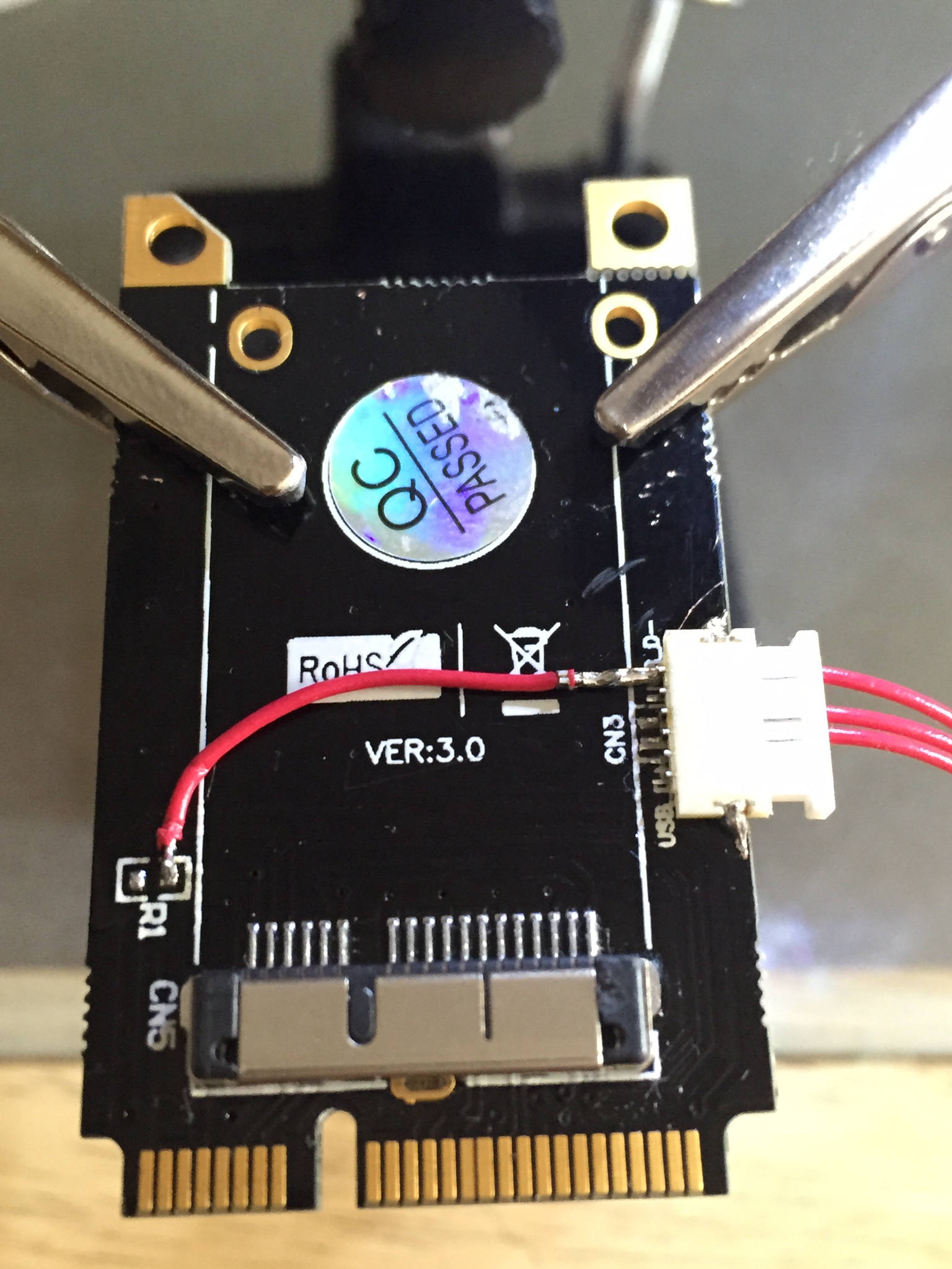

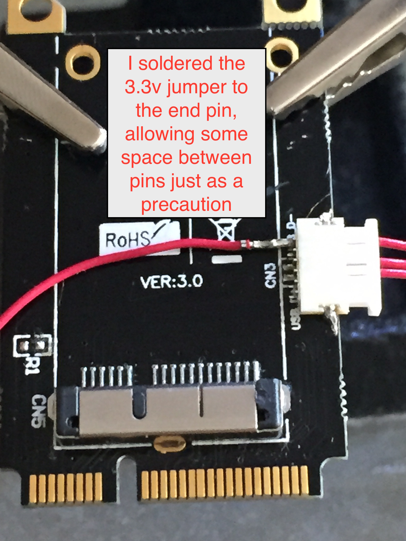

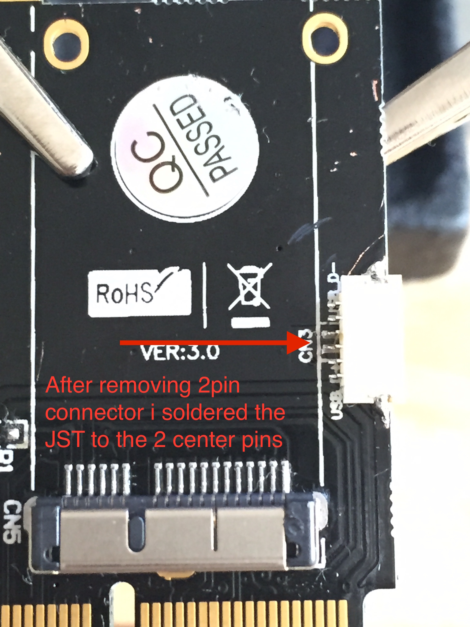

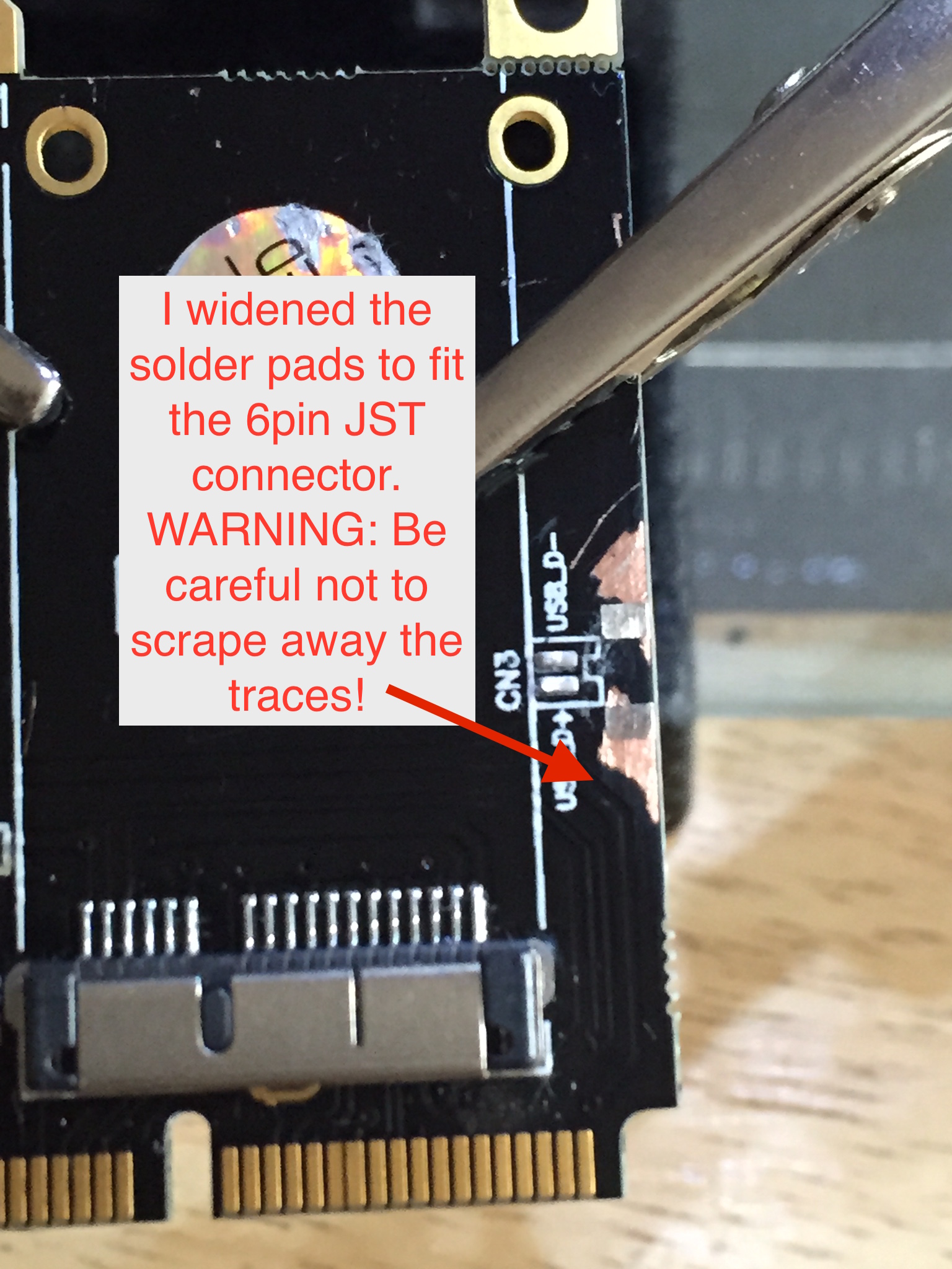

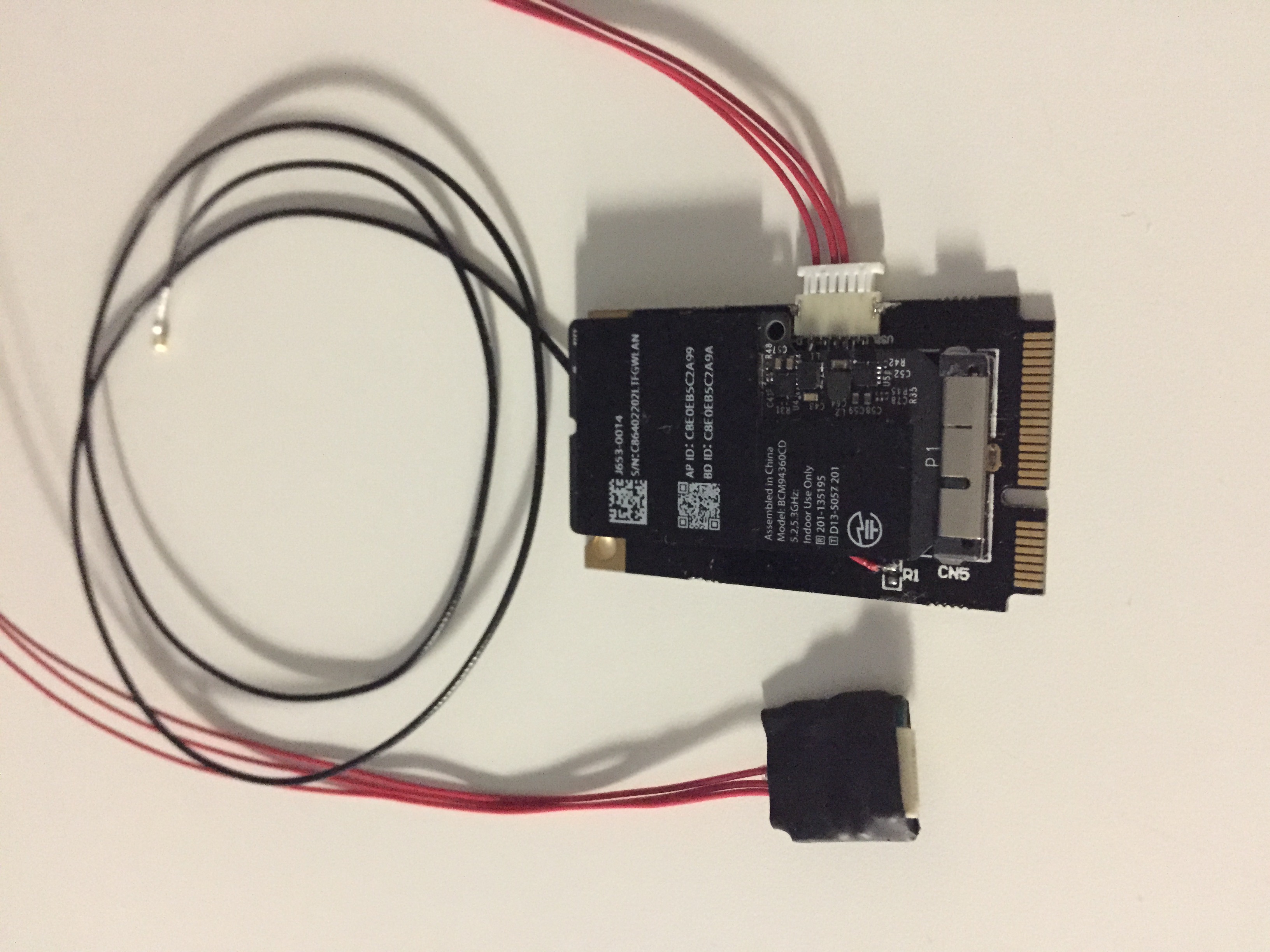

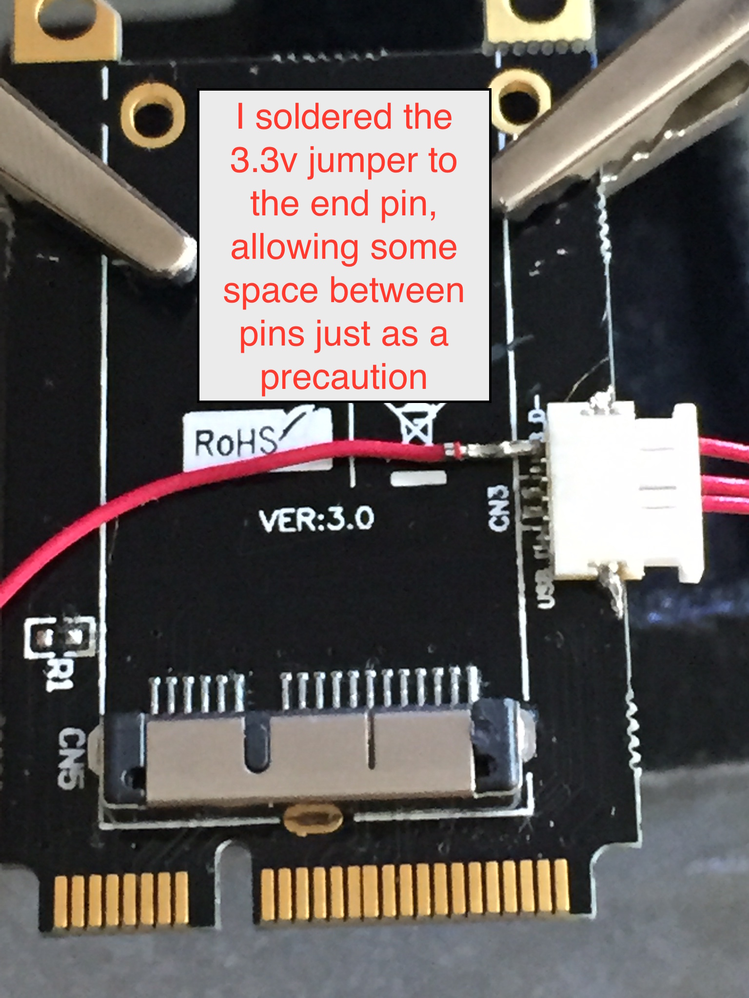

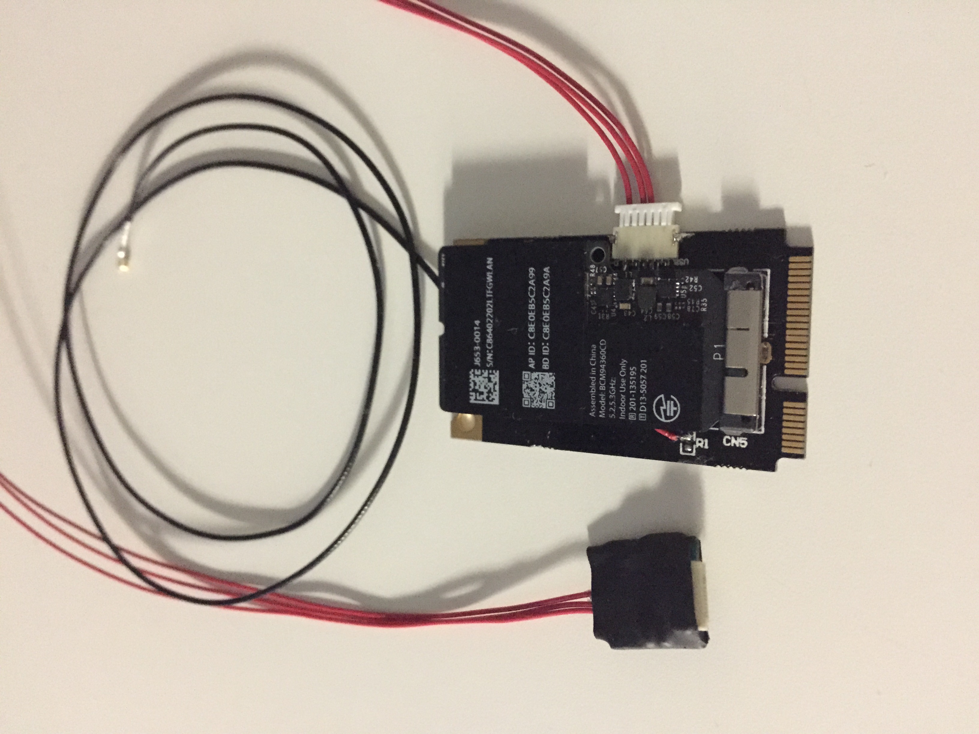

reversible upgrade successful!
My 21.5 iMac 2011 (EMC 2428) upgrade was a success and I could barely wait to post.
This mod retains:
  • Independent power for wifi and BT
  • Handoff/continuity features worked after reboot and sign-in to iCloud
  • No kext mod or CAT software. (BTW, I use CAT on my 2010 Mini and its great!)
Background: I wanted to be able to remove/reverse the process if needed. To do this I needed to build an extension cable to "tap into" the original BT card to get the both USB D± and 3.3V signals.
Parts: about $43US (all from eBay except the JST connectors)
  • Mini PCI-E Adapter for BCM94360CD/BCM94331CD
  • Apple Broadcom BCM94360CD card
  • U.FL IPX cable male to female terminal block cable 1.13 pigtail connector 60cm

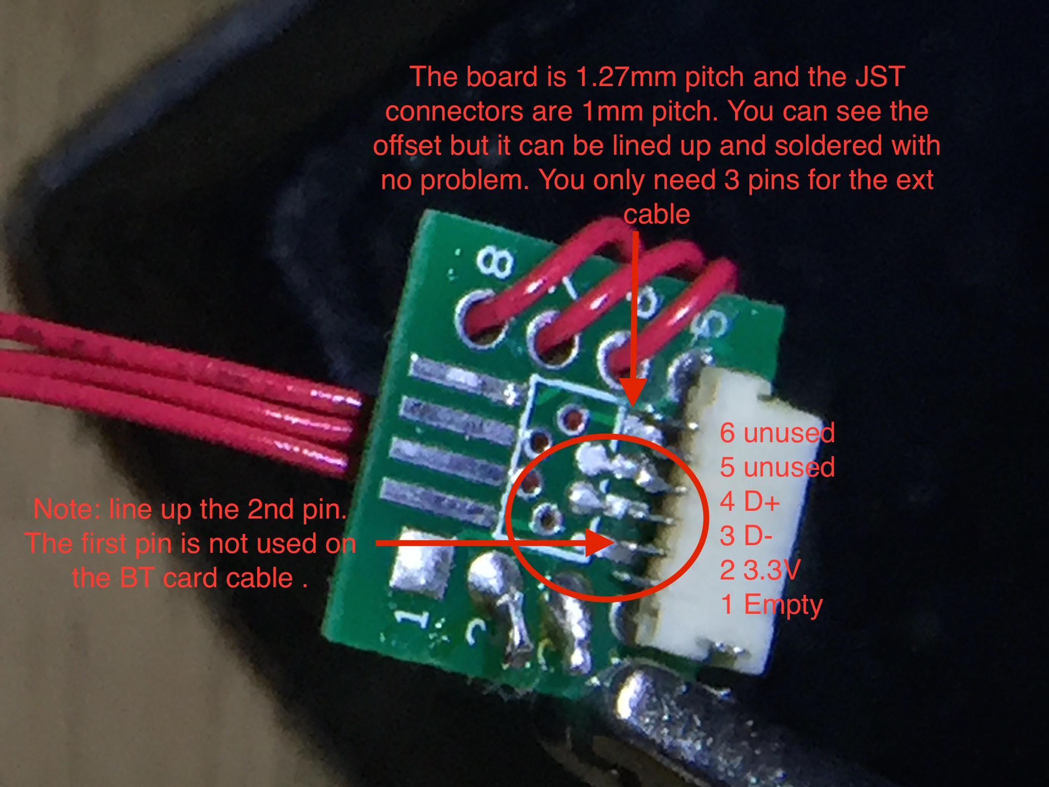

  • SOIC adapter board, SO-8 SMT to 8-pin DIP (1mm pitch if you find it, 1.27mm pitch can work too)
  • Apple MacBook Pro A1260 Bluetooth Board W/Cable BCM92046MD (used to scavenge the connector or use optional JST connector below)
  • Optional: a sample set of JST connector model numbers:
    contacts: SSHL-003T-P0.2 (these are crimp-type contacts)

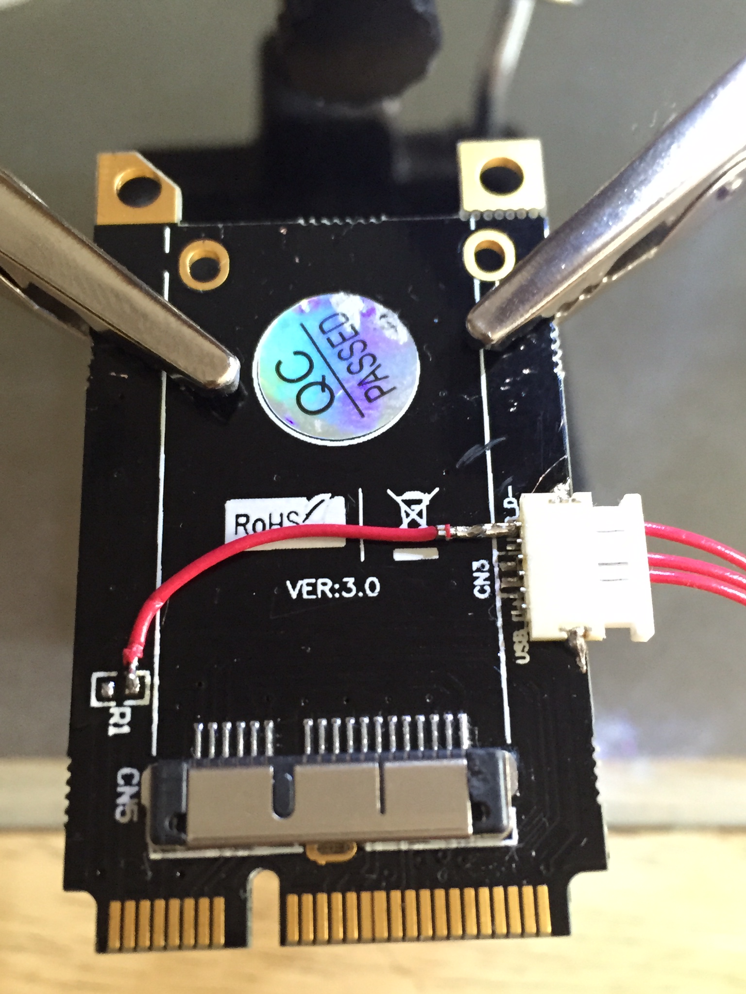

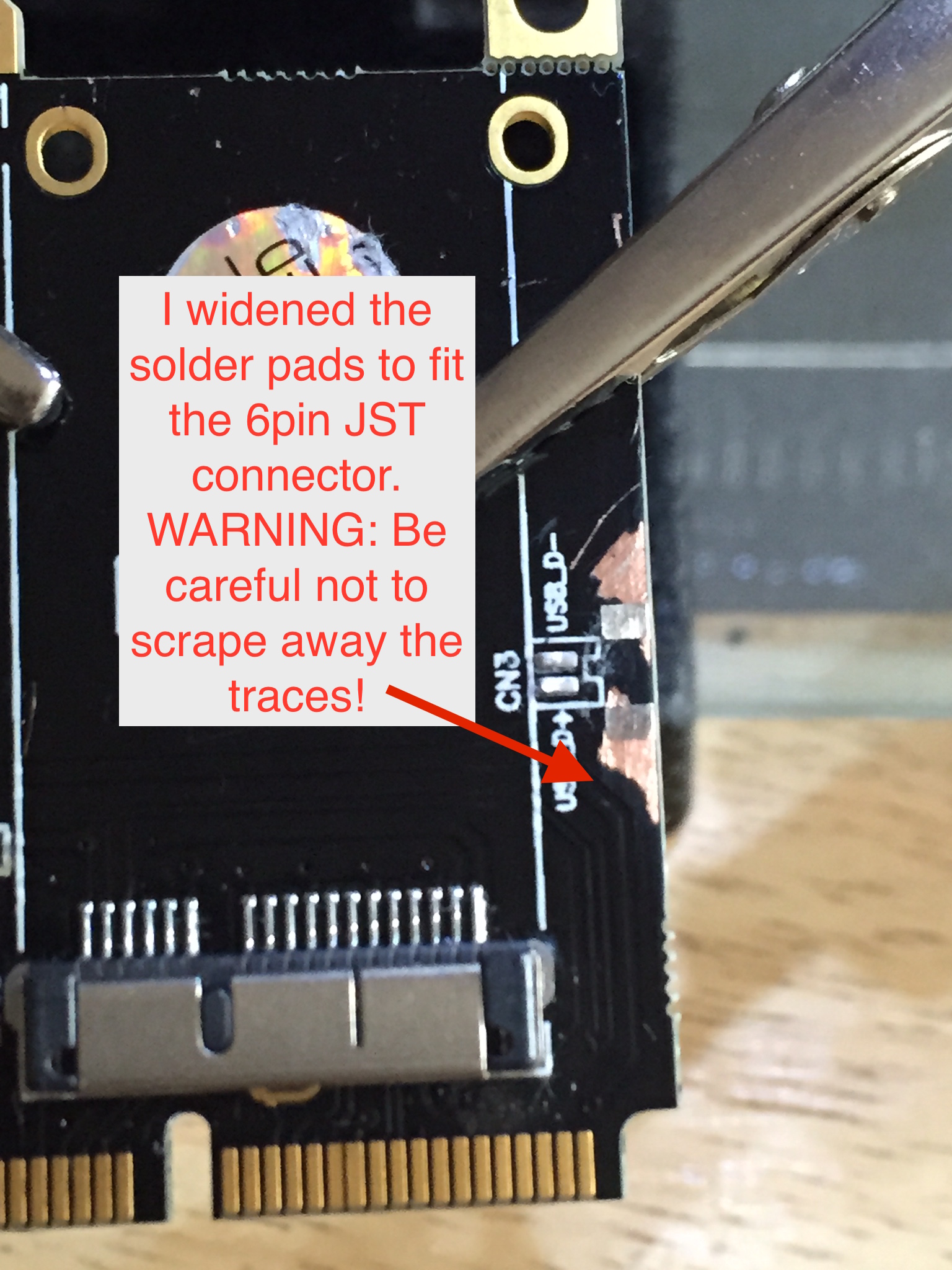

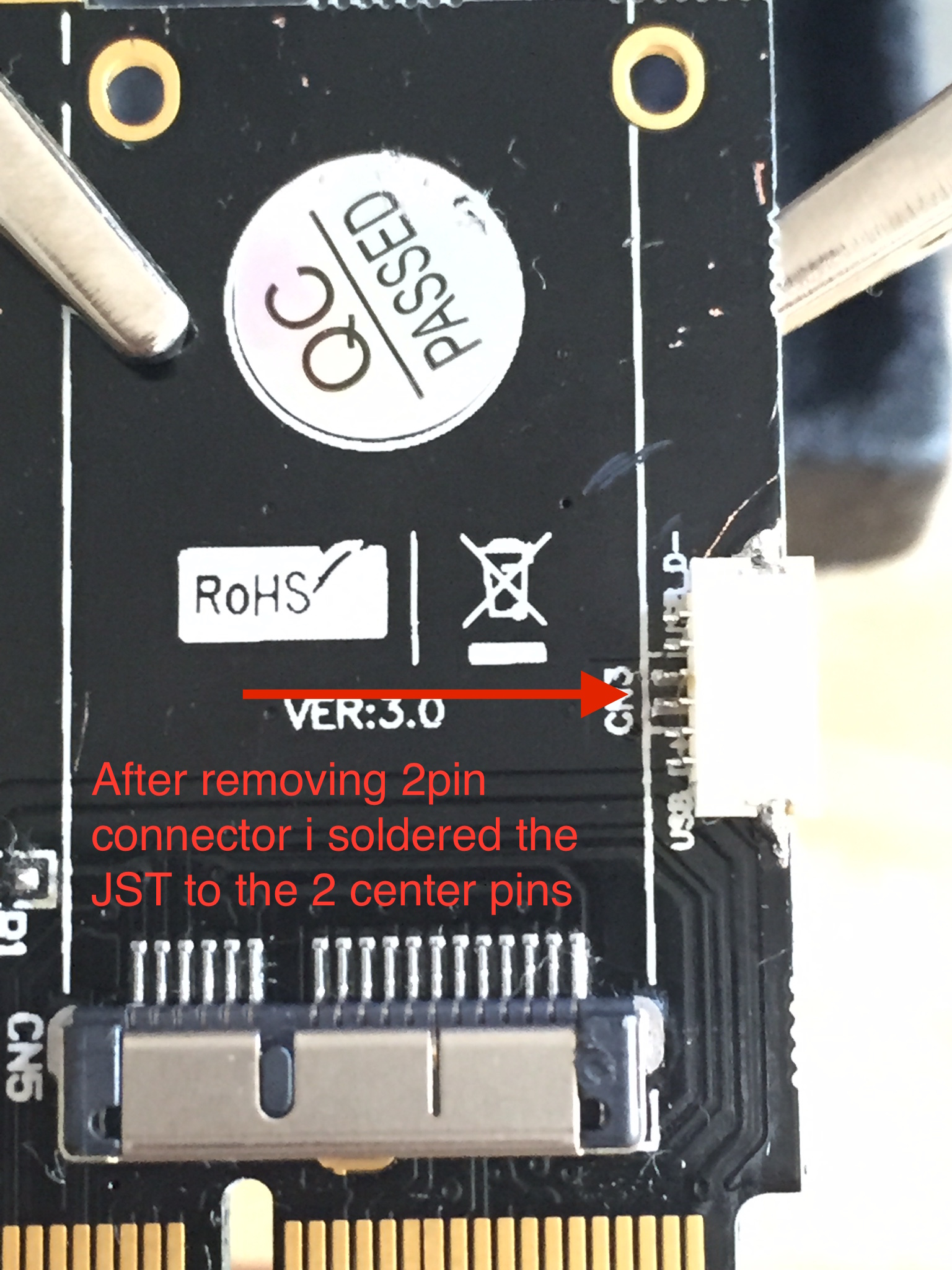

I started with the adapter removing the D± 2pin connector to add the JST connector. This was not necessary but I wanted to have some fun with it making a removable USB D±/3.3V extension cable.(*If I were unable to get the JST connectors or using a scavenged BT connector, I would not make the extension cable removable. I would have opted to solder it directly to the adapter card as others have done before and use the scavenged connector to plug into the original BT card cable.)
One advantage of mounting the JST (or scavenged connector) to the adapter card is that SOME iMacs have a BT cable that can be purchased separately and use to patch directly to the adapter card:
To make the procedure reversible, I just bought another Bluetooth cable. So if I want to reverse it, I just remove the modified cable and replace it with the new cable. The cable cost about $6 on eBay for my Late 2009 iMac 27".
Unfortunately the 21.5 iMac 2011 is not one of them. The BT/iSight/and USB? are mated into one cable at the motherboard. (But FWIW, a scavenged cable AND BT card could be used for parts.)
After mounting the JST connector to the adapter card. I added the jumper for the 3.3V "R1" mount.
Many have discussed about cutting the trace. I did not cut it with positive results:
Success at last! I completed my upgrade using the basic adapter from China and soldering D+, D-, and +3.3v as mhafeez illustrated. In my testing, trying without the +3.3v, the bluetooth shut off with the wifi as expected. Like mhafeez, I did not cut a power trace, but by adding the bluetooth power as he showed, I now have bluetooth when wifi is shut off. And incidentally, the wifi functionality and control does not seem to be affected by having the wifi power bridged (trace not cut) with bluetooth power.
After completing the adapter card, I mounted a JST connector (or scavenged BT connector) on the PCB card to create an 16" extension cable. **Line up the 2nd pin of the connector to match the original BT card. NOTE: the 1st pin is empty.
6 N/A for extension (ground)
5 N/A for extension (ground)
4 D+
3 D–
2 3.3V
1 *empty*
