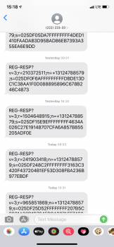

After I restore my phone over iOS 13.3 iMessage and FaceTime activation is failing constantly. I use Google Fi and I think must be related to that.
I contacted Apple support but they are clueless about it.
Anyone else with the same issue?

I have absolutely the same problem. I have an iPhone 11 Pro Max with Verizon as the eSIM and Fi as the physical SIM. Even Apple claims that BOTH carriers can be connected simultaneously to iMessage/FaceTime. Worked great for two weeks. After updating to 13.3, Fi refuses to connect to iMessage or FaceTime. When I try to connect, I get that weird text message you are getting every 10-15 minutes from Fi.... always starts with “REG-RESP?” and shows my Fi number in the body of the text. Obviously something is not going right with the registration for iMessage. Verizon on the same phone has no issue with iMessage or FaceTime.
very very disappointed in Apple‘s support on this issue ...... they are 100% clueless.. all they do is read from their troubleshooting script. Fi support is even worse.

I believe it is a re-activation issue. Re-activating with 13.3 seems to be the problem. There is no way to tell where the problem lies. All I know is that the random texts are A) from Google and B) have to do with iMessage (re-) registration. Same phone, same Apple account, has no issue with my Verizon SIM.

The weird text messages from Google Fi during activation attempts seem unique to the Fi failure to activate. Neither Fi support or Apple support could even comprehend what I was talking about when I called. Seems that if the problem isn’t on their talking points scripts .... it can’t be so.
