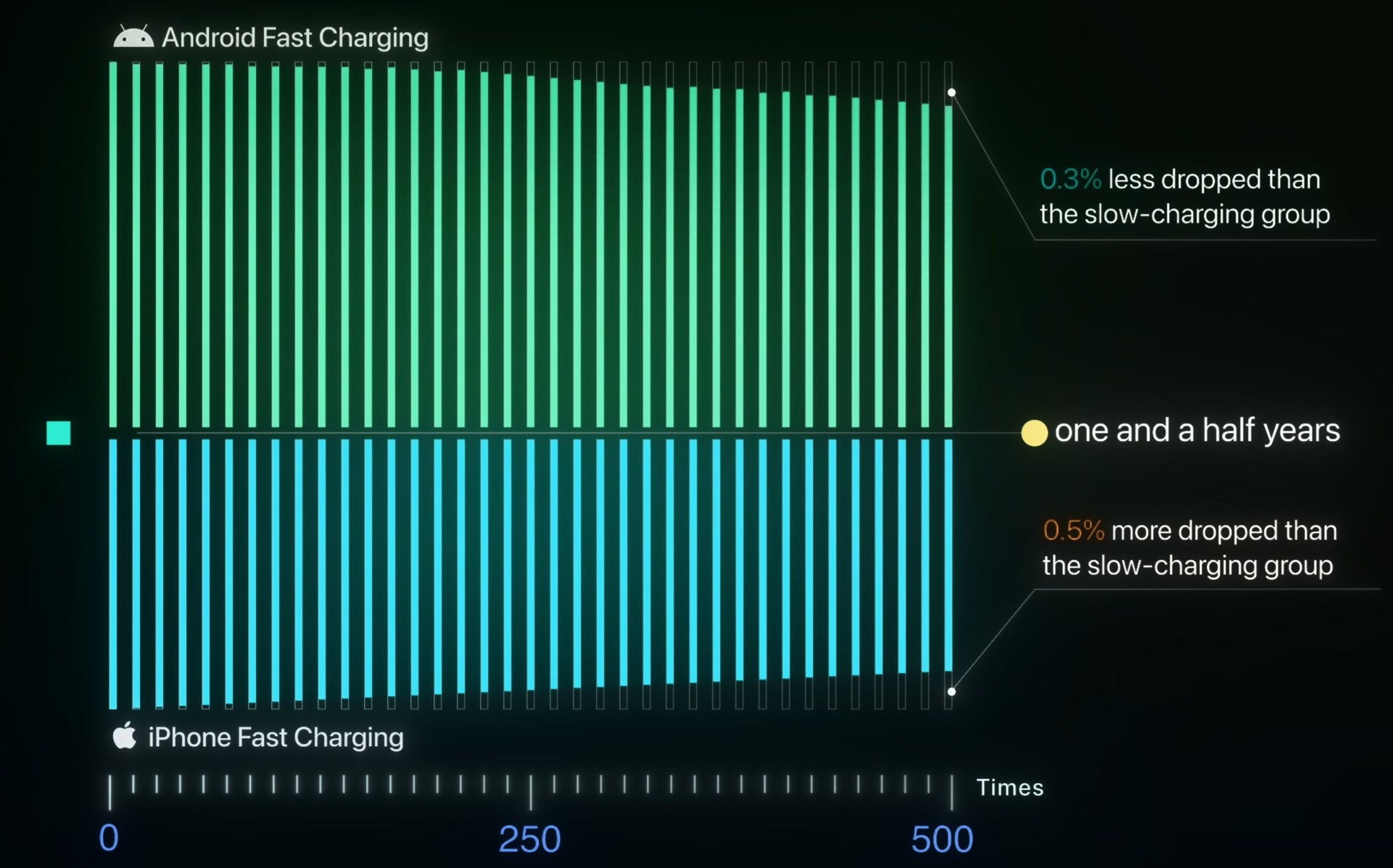

More than minimally, I would say. The 5-100% iPhone lost 12% capacity, while the 30-80% iPhone lost only 8% capacity. This means the 5-100% iPhone lost battery capacity 50% faster,
While technically true, it may not be as definitive as the test suggests.
Battery degradation isn’t linear. So while they appear to have lost more, they could’ve plateaued and the difference could end up being much smaller in the long run.
They only show the graph for the 5-100%, but it doesn't deviate dramatically from linear for the 500 cycles:
More data would be nice, but I'll take the one we have here.
