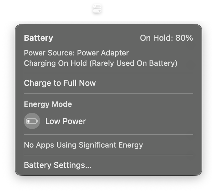

You said "Never once worked for me."
You have to give it time to learn your routine. It works in the background, like all algorithm's on Mac. It's not on demand.
Nope. I gave it all the time in the world (a year or so) - it's meant for people who just plug in their laptop into power same time each night, not for me. You can easily mess it up by changing your routine for just a few days. Al Dente is so much easier. Also has some nice geeky info about power draw. Great for my needs - most of my days my Mac is plugged in, so I keep it below 70%, and I top it up with one click when I need to.
Also, on my other devices, it also just refuses to work. I always ended the day with more than 50% battery on my Watch so for a while it charged only to 80%.... until it just mysteriously stopped doing that and now it always charges to 100, even though my usage or battery levels haven't changed. Why? Apple only knows. For me, their 'estimates' are simply not reliable.
I’m aware of how it’s designed.
Never once worked for me in the sense that I gave it a try a few times over the years leaving it plugged in for days at a time and it still hasn’t worked.
I’m not sure I can elaborate on this further but I’m glad it’s working for you. And I’m happy with my solution that gives me more granular control.
Charging to 100% isn’t the issue. It’s how long the device stays at 100% that affects the battery health.
That's what people don't get. Most people charge over night then use their devices on battery. My MacBook Pro is almost always plugged in, so is my iPad Pro, and my iPhone is resting on MagSafe when not in use. If I didn't limit charging, they would be at 100% most of the day, every day.
And limiting them is not a hassle for me. Almost every device has this option, built it. My Steam Deck. My Switch 2. My Apple devices. And yet, people treat it like it's some kind of hoax.
