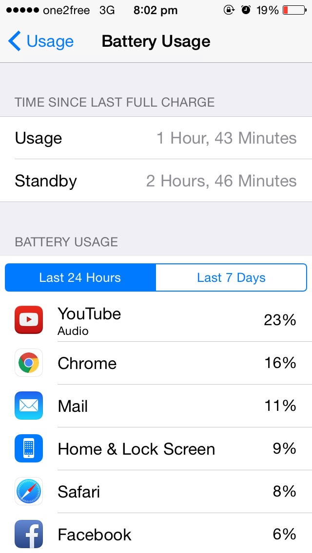

Well it's been less than 2 hrs for me and it's already less Than 20%, Which is typical because when I go out for a walk for 2 hrs my phone can't even last that period of time.
Well if you're streaming audio while walking, no wonder it burns through the battery. During those two hours, as you're walking block to block, from cell tower to cell tower. Signal going up and down and then hands off to next tower. Any mobile device would drain the battery with an audio stream and moving from tower to tower. Try the same test when you're staying at a single location. That constant searching for a new cell tower big battery drainer.
That doesn't explain the problem at all. 2 hours of music streaming doesn't consume 80% of battery. It's just absurd.
My guess would be a faulty battery. @tobeornottobe Are you using an iPhone 5?
Sure it could, if he was walking around. I've drained my 5 in a couple hours while leaving Maps running with the phone not plugged in while driving.
