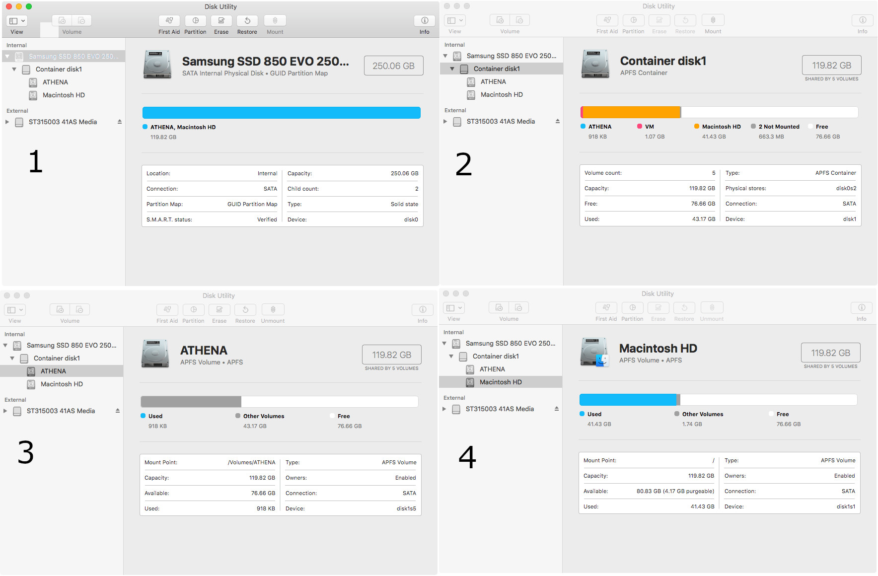

Edit: Here are some Screenshots of what I see now on my Mac Mini Disk Utility:
Screenshot composition 1 - I numbered the screenshots. The "Athena"partition should have been "free Space" instead for some reason it appears as if I have 2 partition occupying the same disk space. Never seen anything like it.
Machintosh HD is the original 120GB boot Partition (The one I would like to extend to 250GB, something I have been able to do since I owned a 512K Mac Plus)

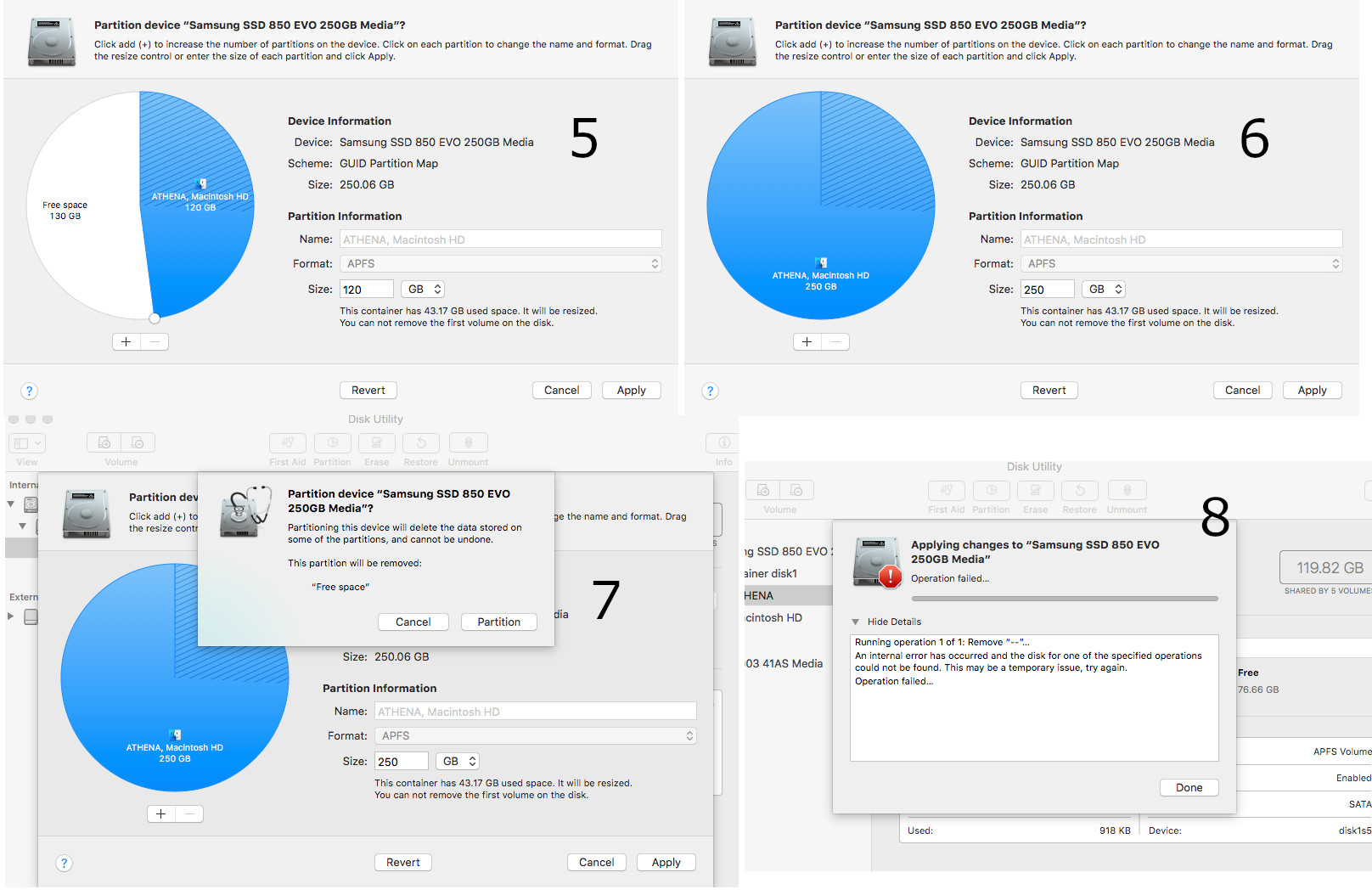

Second screenshot is also a collage of screens to illustrate what happens when I try to extend the partition.
in Pic 5 you can see the Macintosh HD Partition and the "Free Space.
In Pic 6 I instructed the partition to expand to 250GB
In Pic 7 It asks me if I want to proceed and
In Pic 8 it gives me the error I already indicated.
There are times when instead it looks like everything is working fine, but when I go back to the disk, it's still partitioned as if I did nothing.
